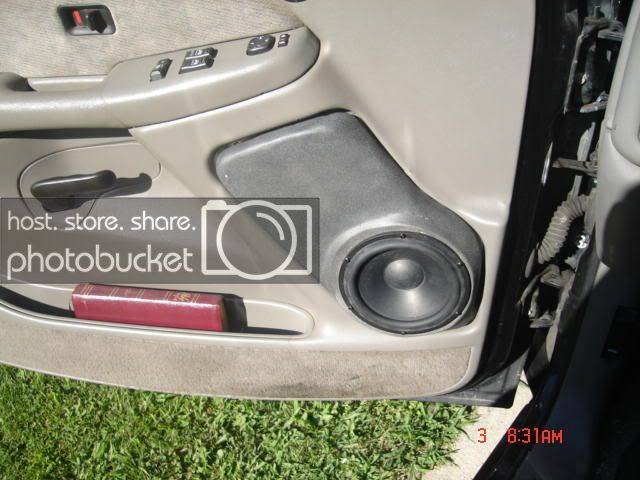

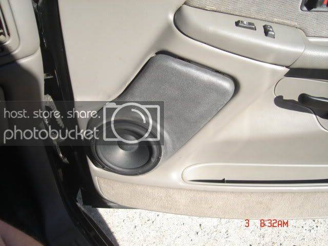

i have some rs-180s for sale or trade, ill throw in some baffles i made of 3/4 inch mdf.. I also have some tweets for sale with some really nice crossovers(bi-ampable), from the qsd 216 set (700dollar set).
For my truck there's ample room ON the door for an enclosure.
