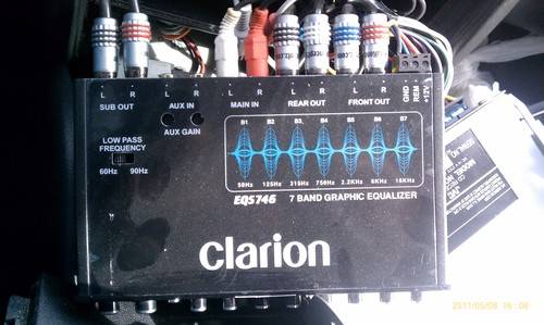

This basically the only good EQ I could find on Amazon: Amazon.com: Clarion EQS746 1/2 DIN Graphic Equalizer with Built-in Crossover: Car Electronics
I'm sure there are others but I get free shipping with Prime and a great return policy. Would something like that work or do I need to move into the $200 range? If I have the EQ splitting the signal for speakers/subwoofer, would I then need to mess with the crossover settings on the amps, or does the EQ take care of that the best?

That unit is good, looks like the crossover is just for a Low pass (the sub) The EQ may work as a crossover but I doubt it will fully clean some frequencies you don't want to send to a 6 1/2 inch driver, if you only have a set of components with a passive crossover you may get away with clean sound, using a coaxial may be a different story. For $50.00 seems like a good deal, you still are going to need a volume control for the full range speakers. Can you get at least a good 4 ch HU with a rear USB port for Ipad control for under $100? and bridge the rears for the sub, maybe it gets more expensive by the time you add a dash, antenna and wiring kit for it. You need some preamp for volume and an HU maybe easier if not cheaper. Just my opinion, at least you get a radio with an HU.
