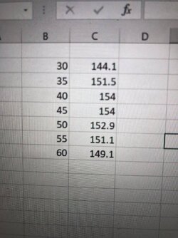

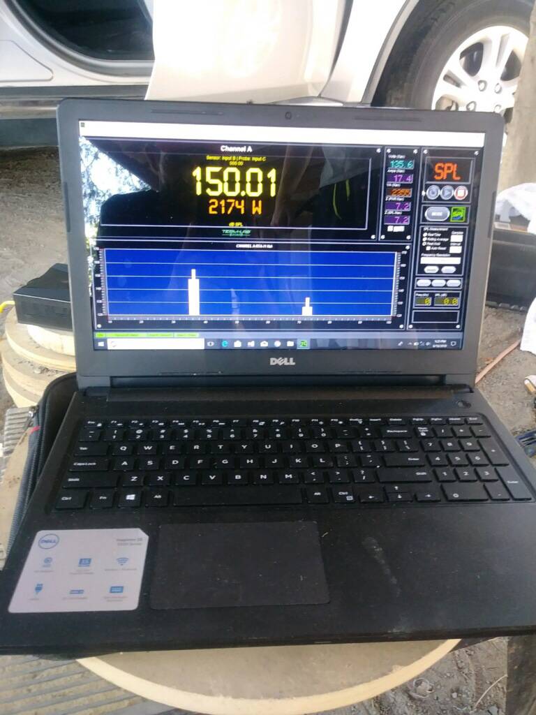

Popped a 150.5 @ 36 today, clamping right at 3k.
At 1 ohm or .25 ohm strapped? Are you strapped or gain matched?

Strapped at 2ohm...power was at 6.5ohm after rise.
The 80ah is more than enough. Currently on the stock alt it stays in mid 13s. My vehicle seems to be regulated at 14v as I have never seen it charge above that, now or pre stereo.
I have a 370a CES alternator that should go in this week. Hopefully that keeps me in the high 13s or low 14s.
The next step is d4 subs so I can strap at 1. Maybe a different box to try and offset the rise some.

Impedance should not be a factor in changing your box, particularly if your goal is to play music. If it sounds good it is good. Get some D4 ohm subs on there and see what happens.
Have not updated this in a while. Have gone through some different sub and amp combos this season.
Currently running 2 Wolfram 4500.1s strapped at 1 ohm on a pair of Sundown U 15s with zv coils and Nightshade spiders. Pulled a 154.5 today at 44hz.
