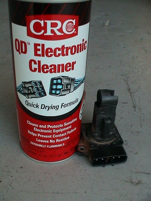

Well i know their is a spray cleaner they sell in autozone and advance auto. No on the accord I know their is a map sensor on the top of the engine, but im not sure if their is a maf sensor in the air filter compartment, but i will check
i use this and a q-tip (if needed)

i wouldnt use the q- tipp,more chances of messing it up.if you use the spray right,it will do a thorough job by itself.
EDIT;if you have to use a q-tip,you have waited too long before you cleaned it lol
