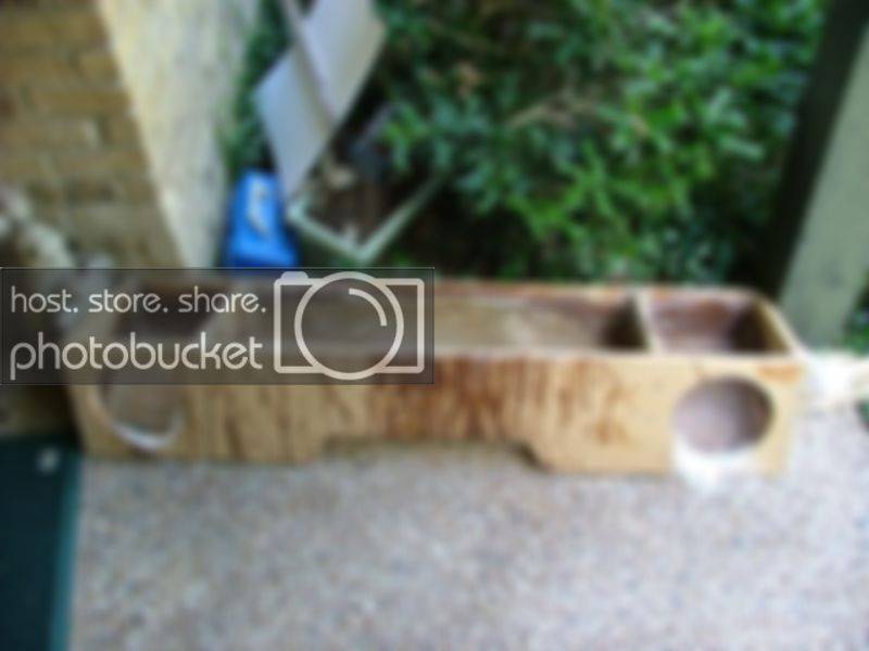

I have 3 spaces to put amps unless I can figure out a way to get it behind my seat, which I dont think I can... but 2 spaces that are 23x11 (under front seats_ and one thats 10 by 30 (under rear seat)... It would be convient if I could get both amps in the 10 by 30... or at least the sub amp because the space where the amp goes is right in between the 2 subs.
The middle compartment is the space under the seat im talking about.
