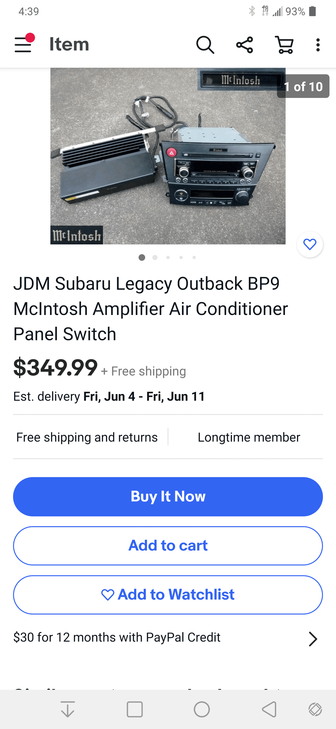

Macintosh system

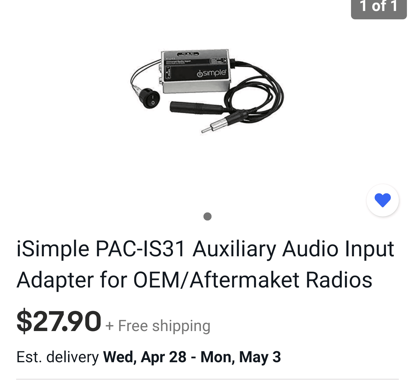

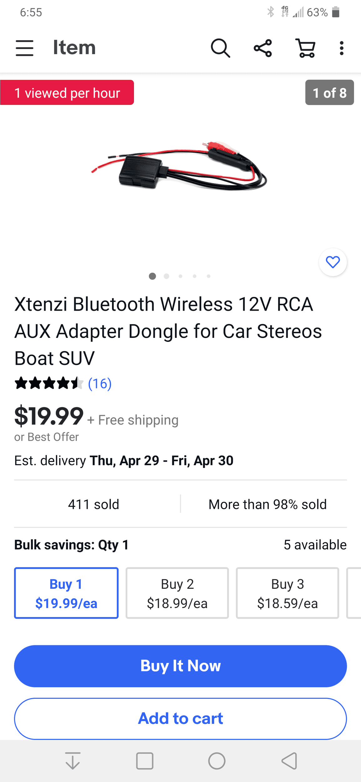

Your car does have an amplifier. I would leave that system in there, McIntosh is top of the line audio. Even if it is OEM, you would need a pricey aftermarket radio to compete with it's quality. If you want to add Bluetooth, I would suggest an inline unit.
