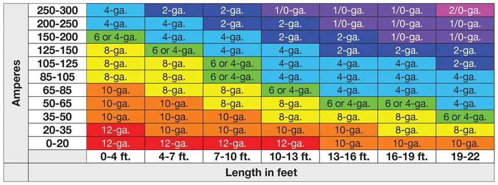

95mm2 should be PLENTY thick even if it's CCA wire (about 3/0 gauge iirc). This chart is for OFC wire, so you would want 1/0 minimum for a 150A alternator.
That is simply great. Thank you very much for this precious information, for me this is pure gold. Thank you again Jonny
