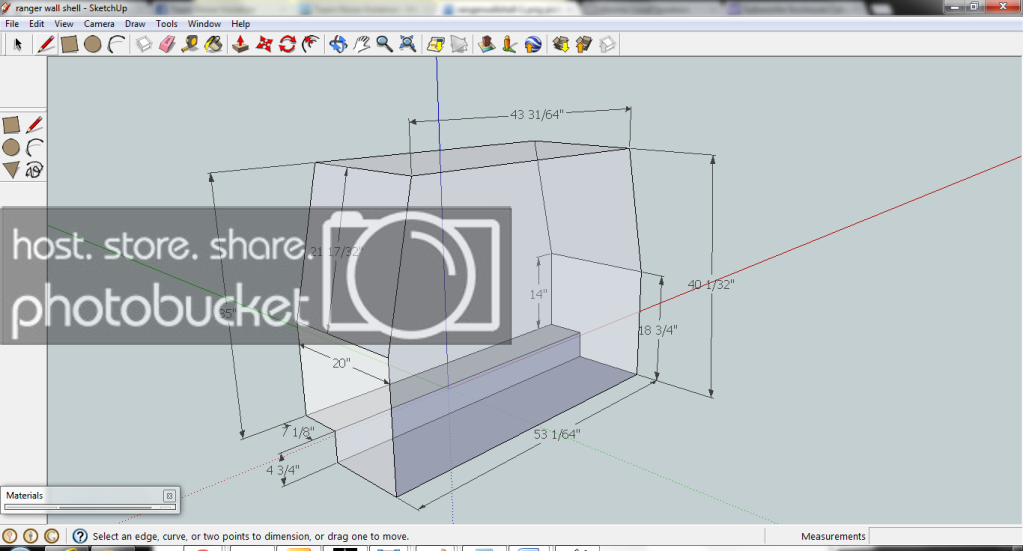

heres my max dims... can it be done? four atomic apocalypse 15s. if it can be done I will pay to have it designed.
I'm too lazy to figure out how much volume that is, but if there is not enough room, why not go with 3 15's. If you get dual 2's you could run them at .67, which will more than likely be right around 1 with box rise.
Could use a sub that likes smaller areas...
If you have 13ft3 net after port/sub/bracing and such then you should be good for various 15s. Obsidian comes to mind.
well I wanted to use atomic apocalypse series... I get them for a steal and they are monsters for getting loud... everyone tells me that there is no way that I can fit 4 15s in there.... 2 18s would be fairly easy though....
Yea, the Atomics like the average space you normally see for 15s so less then likely with having enough space. I didn't do any math on your enclosure so I have no idea how much space you have available.
can you figure out the vol. of it please. I will pay you $10. the front is going to be double baffled btw. I just dont trust myself when it comes to these things...
