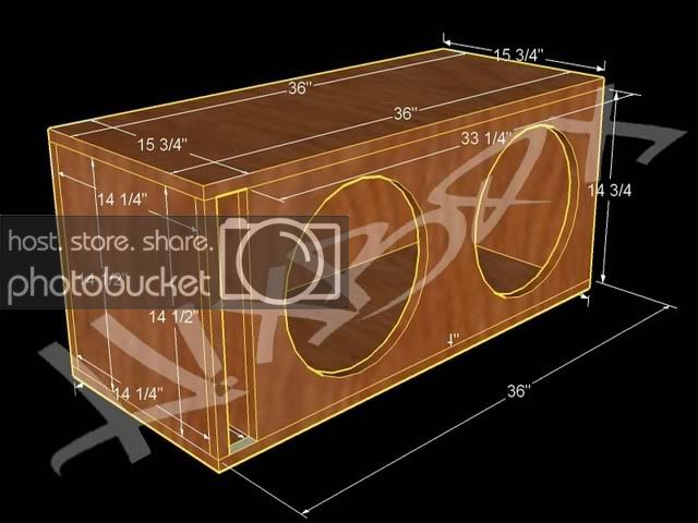

Alright guy's i know this is gonna be a real newbie question i plan on building a new enclousure this summer although i have never built a vented box or tuned a box or nothing like that here's what im going to build.
Thanks for Hixbox for the plan's and jeeper found out the cubes of space is 4.1. i wish i could pay someone to pay and just build this for me but im layed off and just saving up cash by piece by piece and im building it in the summer. but if anyone has any helpful site's on building vented boxes and how to tune them etc....i would really appericate the help.

that box is 4.13cu'. this does not count for port and sub displacement.
how long is that port? i see that it has an area of 29sq"...not a lot for two 12's. why does it show 14 3/4 tall on one side and 14 1/2 tall on the port side?
i can help you out, but there seems to be some missing info.
