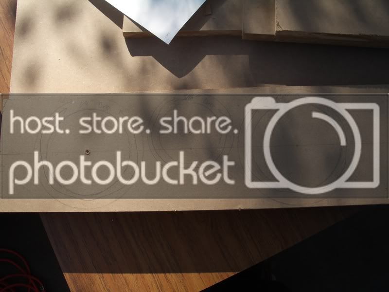

Heres a shot of the front for the right tower. About to start assembling it now.
The circles will be cut out tonight via cnc.
The middle lines that you see are me telling him I need that depth for that ring only, while the center needs to be cut out.
Okay Ill put them up on their side. Why does that matter?
And all of those things connecting at the same point is okay though right?

i cut my baffles with a 4 axis cnc machine. Make sure you dont cut all the way through or your baffle will lose suction to the board and start to move around, it may even fly out of the machine at least thats wha mine did the first time.
