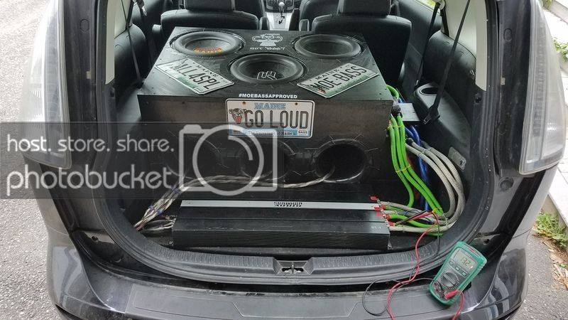

I feel like I might have posted the wrong specs for it. I just redownloaded the box tune calculator and put in my messurements and I'm getting a 20ft³ box with 19ft³ after displacement and a port displacement that is more around what your saying because I had had a few different designs the original design was 14ft³ but then I think I wanted to make it almost 10ft³ per sub so I expanded it out and bunch. When it gets light out I'll go remeasure everything cuz I swear it was 14ft³ but 48"x30"x28" is making a bigger box than that
That's roughly 23.33 cu ft gross.

I really wanna build a 1/3 forth order for these. Frank at FU said that his subs perform best in 4th order designs. When I first started I was deadset on a forth order but it was explained that with out a meter to find the resonance of my sealed section making a ported section to the right spec would be a fail. How would I find the resonance freq of a sealed section of a box? Sry if this is too complex a question to explain through text
You want to know what the res freq of the vehicle is, not so much the box itself. You design the box to peak at the vehicles res frequency to maximize the transfer function of the vehicle. A 3:1 ratio 4th order would be enormous for 2 18s. Make sure you have the room for it.
