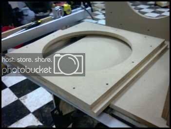

I would strongly recommend titebond II and 1 5/8" drywall screws (coarse thread)...then once its all done and you arent sure if its sealed you could put a run of clear silicon along each seam on the inside of the enclosure.

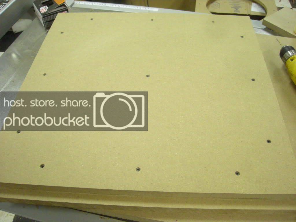

As for the double baffle, try this....put the two sheets ontop of eachother and hold them firm so they dont slide...in two opposite corners/areas of the boards drill holes through the first sheet and a bit into the next sheet...then lay down some wood glue all over the top of the second sheet (inbetween the sheets)
Now, put the top sheet back on and take 1 1/4" drywall screws and tighten them down into those two holes...no go about drilling holes and tightening screws throughout the boards so theyre held together...this will hold them together and the 1 1/4" screws wont poke ou the other side //content.invisioncic.com/y282845/emoticons/smile.gif.1ebc41e1811405b213edfc4622c41e27.gif
Like this (for just two sheets)..
Or this if your doing sheets that involve mounting a sub/sountersinking a sub..
Everyone seems to use Tightbond II for some reason, just use it. caulk the insides, try to make it look clean. since its your first box i assume you wont need a double baffle (prolly not large subs).
Thanks for all the ideas. I am planning on going to menards tomorrow monring and grabbing everything I need. I was actually thinking of doing exactly what Pioneer saturn said. Thanks for the pics! Now my plans need to come tonight:crying:
PS. Im on 56k out in the boonies. haha what a joke.
yeah u need 1 5/8 wood screws, strong glue that doesnt set to quick! i used elmers wood glue, and like 6 clamps! also make sure u counter sink all ur screws! looks nicer! and just some tile sealer for every corner. smudge it in there with ur finger! but make sure u take it off before it dry's cuz some of them will burn you! happened to me!
