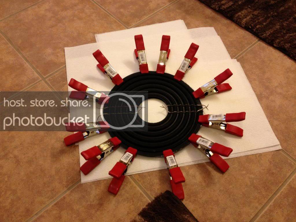

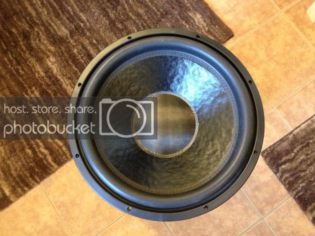

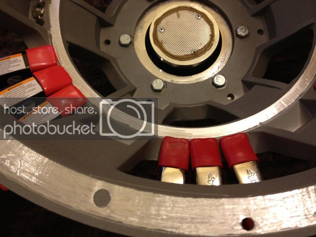

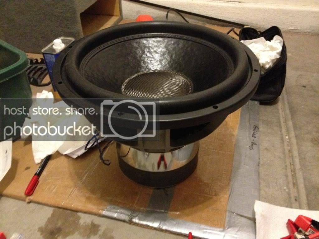

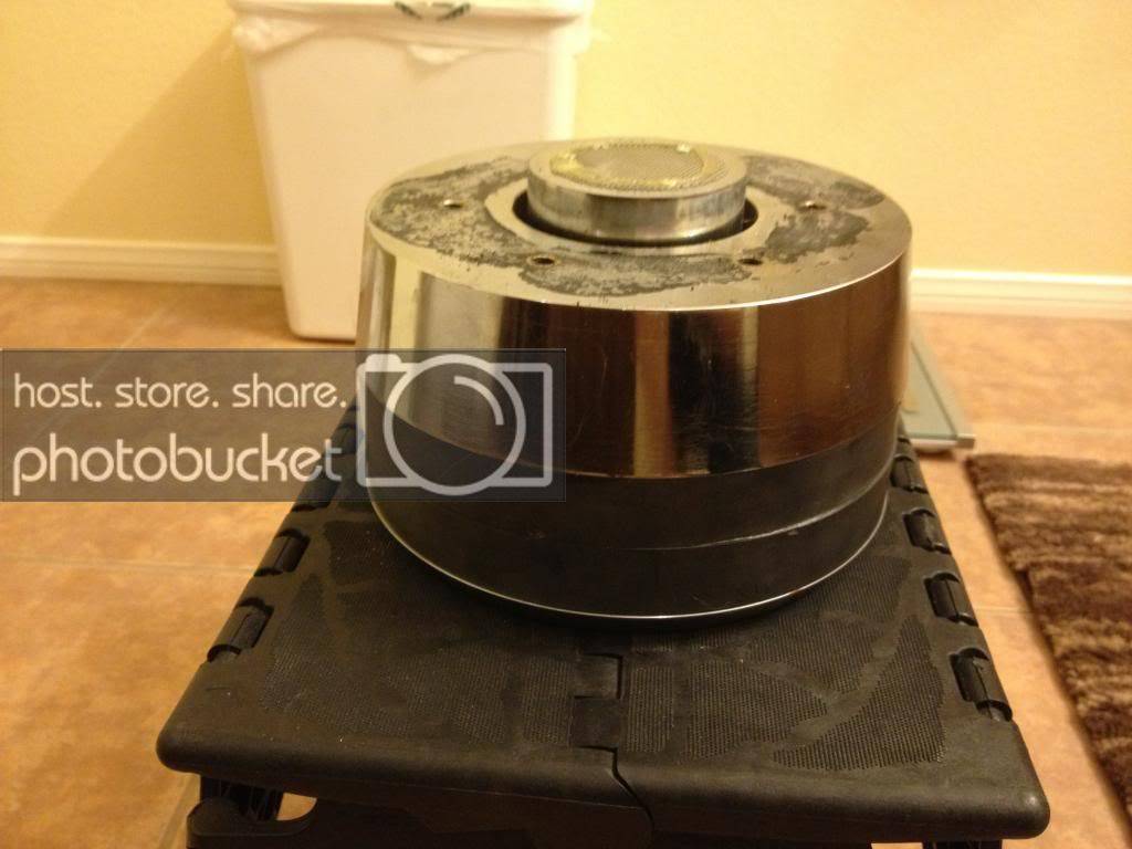

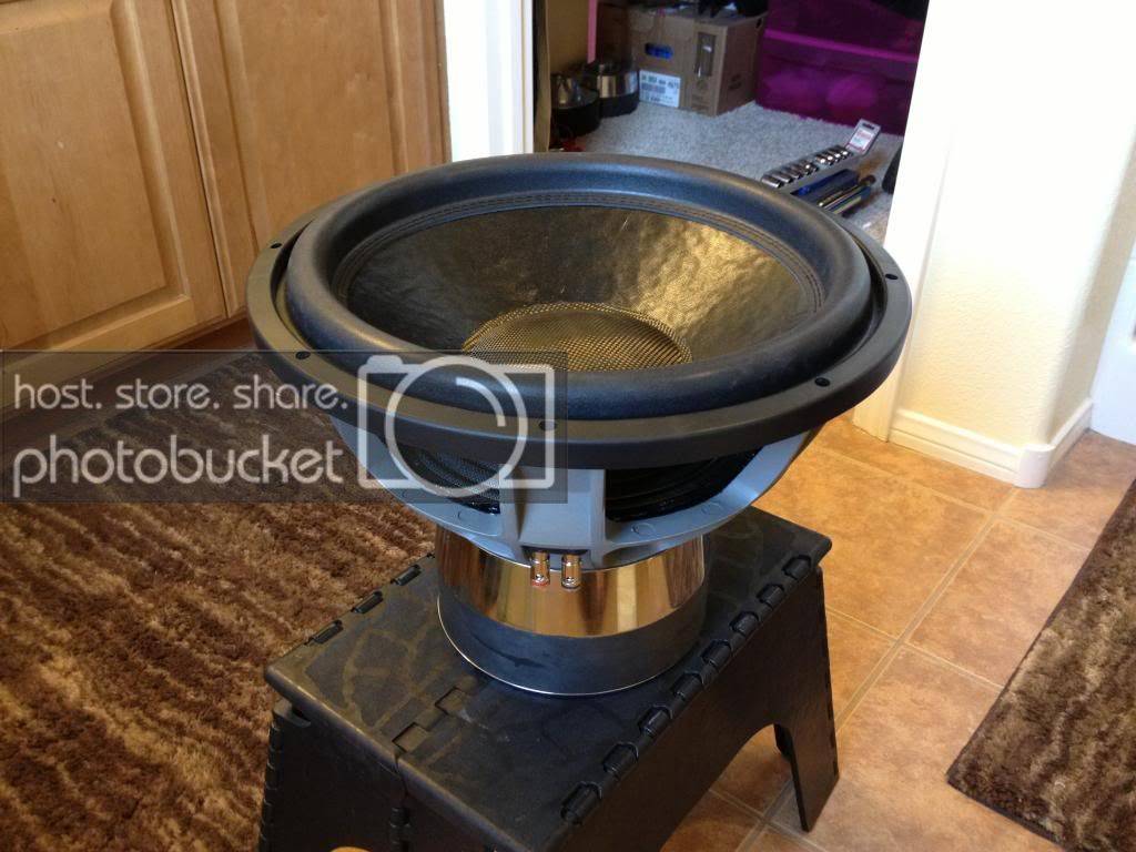

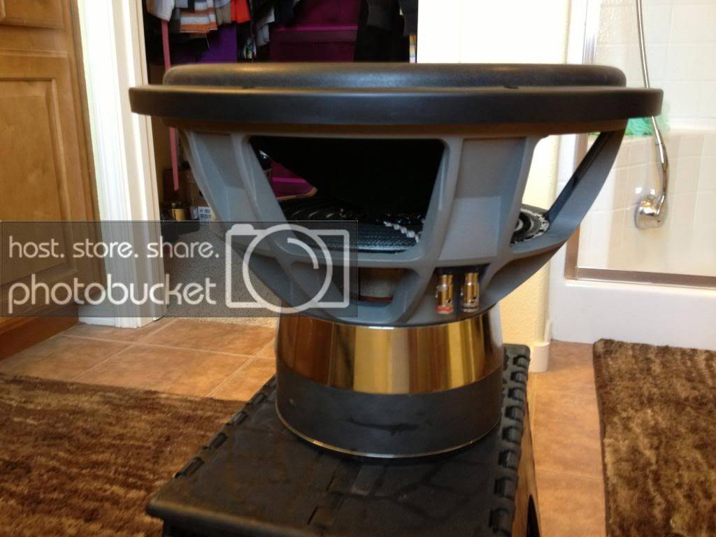

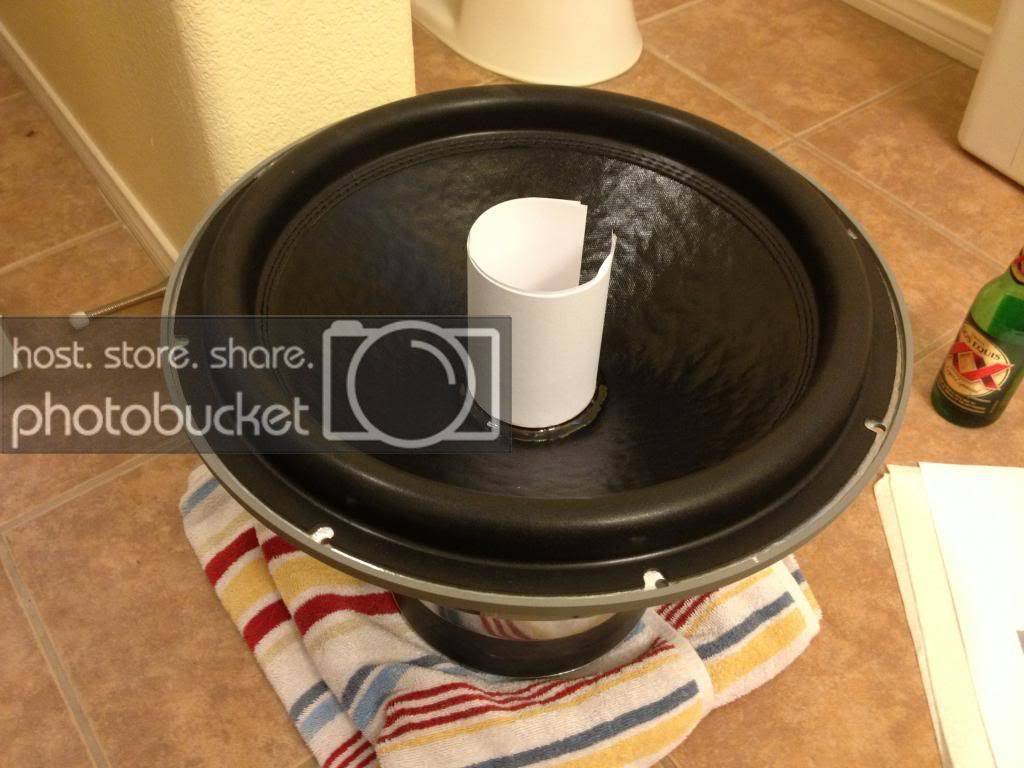

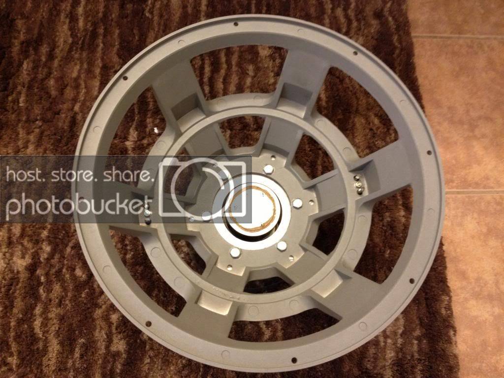

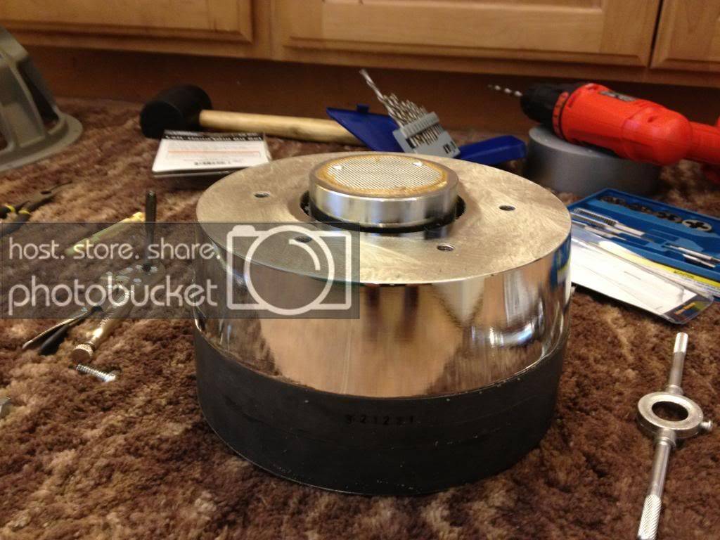

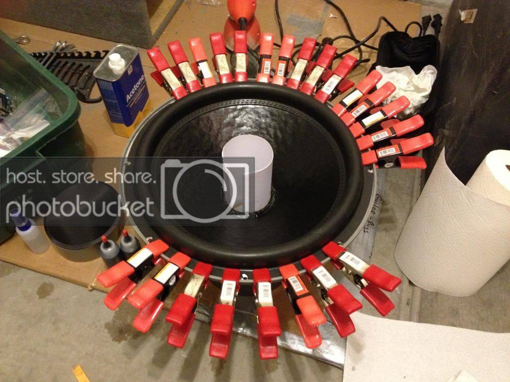

The dustcap was the last item waiting to be finished and I glued it onto the cone yesterday. Today after I got off work I decided it was ready to be tested free air. Hooked it up to my Audioque 1200D and got it moving pretty decently and so far I have to say I'm really happy!! The glue jobs could have been a bit prettier in some areas, but it was my first time so they will get better.
The sub plays just fine and no hint of coil rub or any other mechanical issue. I will be playing it free air during the week to break it in a bit while I wait for my DATS to get here from parts express so I can pull the T/S parameters off it. Was definitely a fun experience and I learned quite a few things along the way lol.
Next build will be my other AV.2 motor except it will be a 12" this time around and I'm going to color coat the basket. Anyways, here are some pics, hope you guys enjoy! //content.invisioncic.com/y282845/emoticons/smile.gif.1ebc41e1811405b213edfc4622c41e27.gif

Is the cone a sundown?
Yes sir, it's a 15" Zv.3 cone. Sundown sells a bunch of individual parts at a very good price.

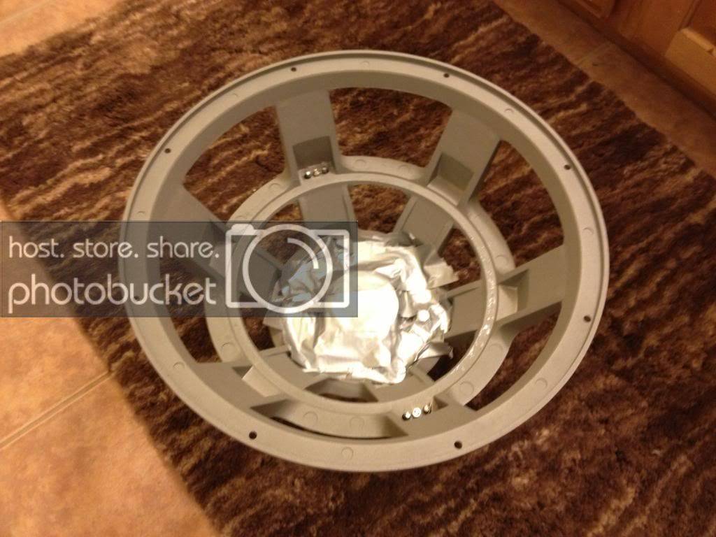

I would've given the basket a nice candy color, but it looks great! I'm starting on building subs as well, so my excitement is right here with ya'! //content.invisioncic.com/y282845/emoticons/smile.gif.1ebc41e1811405b213edfc4622c41e27.gif
I wish I would have decided to powder coat it when I started but that's ok, the plain gray is actually starting to grow on me. But I'll be adding color to the basket for sure on the next build.

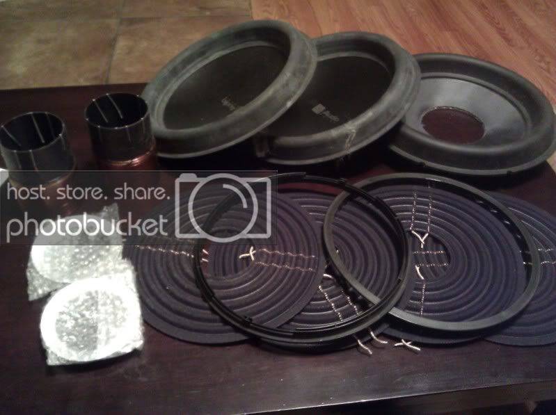

A motor, basket, coil, spiders, terminals, cone, dustcap, glue, bolts and a few beers lol. It's a little more complicated than that but there's tons of information out there on how to do this. The next build I do I'll explain all the steps I did in more detail //content.invisioncic.com/y282845/emoticons/smile.gif.1ebc41e1811405b213edfc4622c41e27.gif

I'll be doing another build in about a month and I'll make sure I do that one step by step. I understand how you feel though. I was a bit nervous as well before putting this sub together as I didn't want to waste over $100 worth of parts lol. But just take it slow and be careful and you should be ok. Nice parts btw! I especially like the audiopulse cones //content.invisioncic.com/y282845/emoticons/smile.gif.1ebc41e1811405b213edfc4622c41e27.gif Where did you buy them from?
