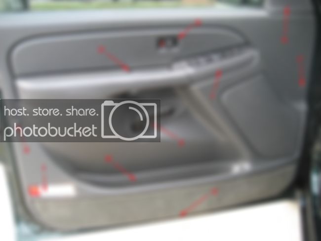

Started on my project for the Rainbow SAC 465 kicks I just received and have some questions. I have both doors started and have the mold done for the passenger side. Here is a pic of a Silverado door panel to give an idea of what I'm talking about.
This set is 2 mids per side and one will go in the factory spot and the other is going into the fiberglass pods that will fit just below the window controls where the tweeter is mounted behind the factory grille. Teh factory grill is no longer to be used. Obviously the tweeter will be moved elsewhere.
