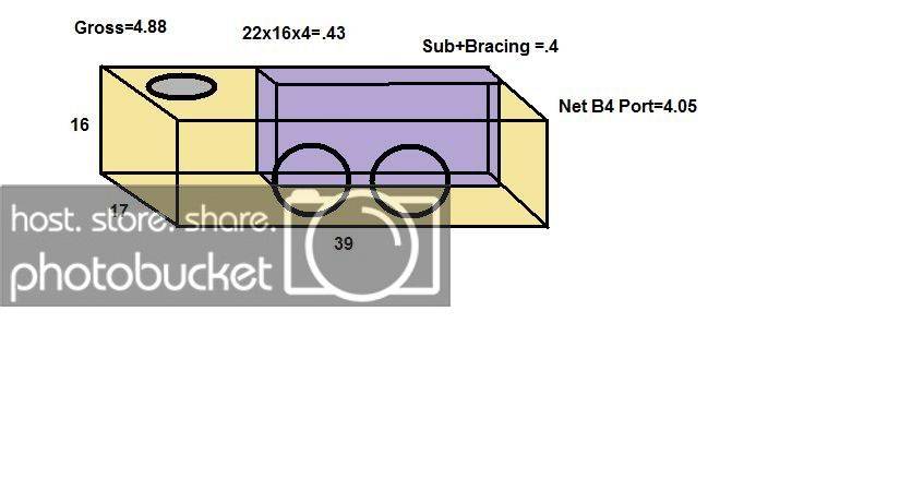

2 3" aero's should do but personally I'd use a single 6".
Yeah I want to use a single 6, but it'd look like a chimney because the length required is longer than the box has room for...Plus they're $40 whereas the others are ~$10 ea.
Not sure how I feel about having a chimney....
Subs back, port(s) up.
16"height external, 14.5"height internal. Tuning 30hz.
Box is 16h x 17d x 39w with an amp rack alcove that takes up 16h x 4d x 22w on the rear,right side.
Purple area is empty space for amps. grey circle is for port(s)
Elbows and you can fit whatever length you want //content.invisioncic.com/y282845/emoticons/smile.gif.1ebc41e1811405b213edfc4622c41e27.gif
True, though trying not to spend on ~$100 on port pieces lol.
4-5hz higher can make a pretty big difference in the low end.
Yeah. ~32 would be the highest I'd want to go with these, and that's pushing it. Though can't argue with db gain.
i would go with two four inch ports i used to psp in a recent set up for two type rs 4.0 cubic feet tuned to 32 hz and it performs flawlessly. i would not advise the 3 inch ports over the four.
