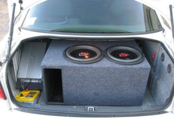

I just put a customer in 2 DD2512D4 and an M2a 2weeks ago. He was one of those, "I gotta have 4-15's in my trunk" guys. I talked him into the 2-DD2512s and the M2a, got it all installed and he about crapped himself. We lost a florescent light in the bay while setting his gain.
He came back in the next monday to have the box mounted, he bragged about how his friend wouldn't ride w/ him unless he turned it down...lol. Its easily in the mid/mid-high 140's for daily music, but I put the fear of god into him about that clip-light so he should be fine keeping it undistorted.
