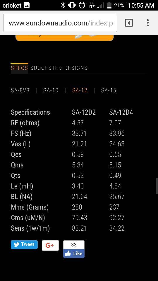

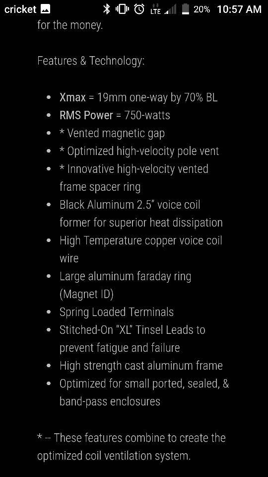

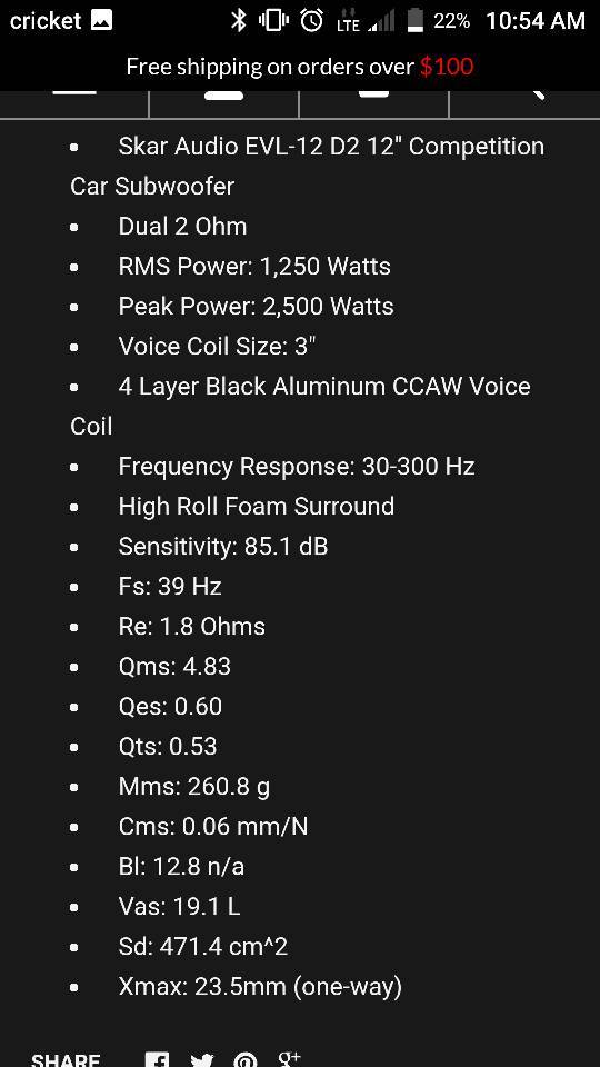

Okay cool. So I've decided I'm going to go with the 12s. Now it's mainly between the Skar audio EVL 12s and Sundown SA 12s. Both same price but the skar looks like it has a better coil on it and says they handle more than the SA series. Sooooooo between the two which would you ultimately choose?
Sent from my Z983 using Tapatalk
Sundown > skar every single time without a doubt
Thanks hertz! You help me make that decision. I'll be buying the sundowns here soon [emoji16] I'll update when everything is coming into place!
peeps run 1 k all say to the SA's.. just from the bl spec looks like the SA has better motor, which is what some peeps say about sundown, motors better than skar..
Sounds good to me. Sundown sa12s it is then
Ive owned both. The ultras are better. The motor is like 8lbs heavier
Okay that's a decent reason right there. The 1db increase wouldn't affect much especially up around the high 130s low 140s. It's still my daily. Can the CABs handle 1kw like the SAs can? I'm sure with it being heavier it should right?
yeah i think u be good lol.. that should probably cost $250 at least, and look at the bl has better motor than skar and lower mms so moves easier with same power., yeah the db may not be a reason to get it, but kr said it was best 2.5" coil sub u can get, that's high praise and in case u didn't know he has a little experience with skar, i'll leave it at that..
