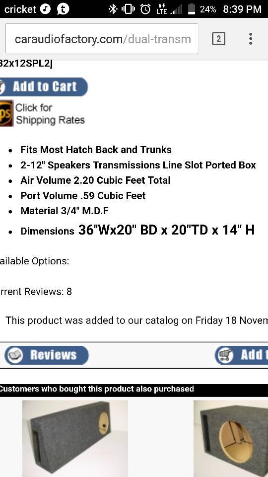

I forgot something important. I listen to all types of music. This setup is great for rap and EDM but ***** for my Rock music completely. Sooooo I was thinking king maybe a T-line? Or a complete 2 15s sealed? Opinions?

peeps run 1k each all the time.. tline boxes are sub specific @CSCStang here makes great ones but he's always busy
