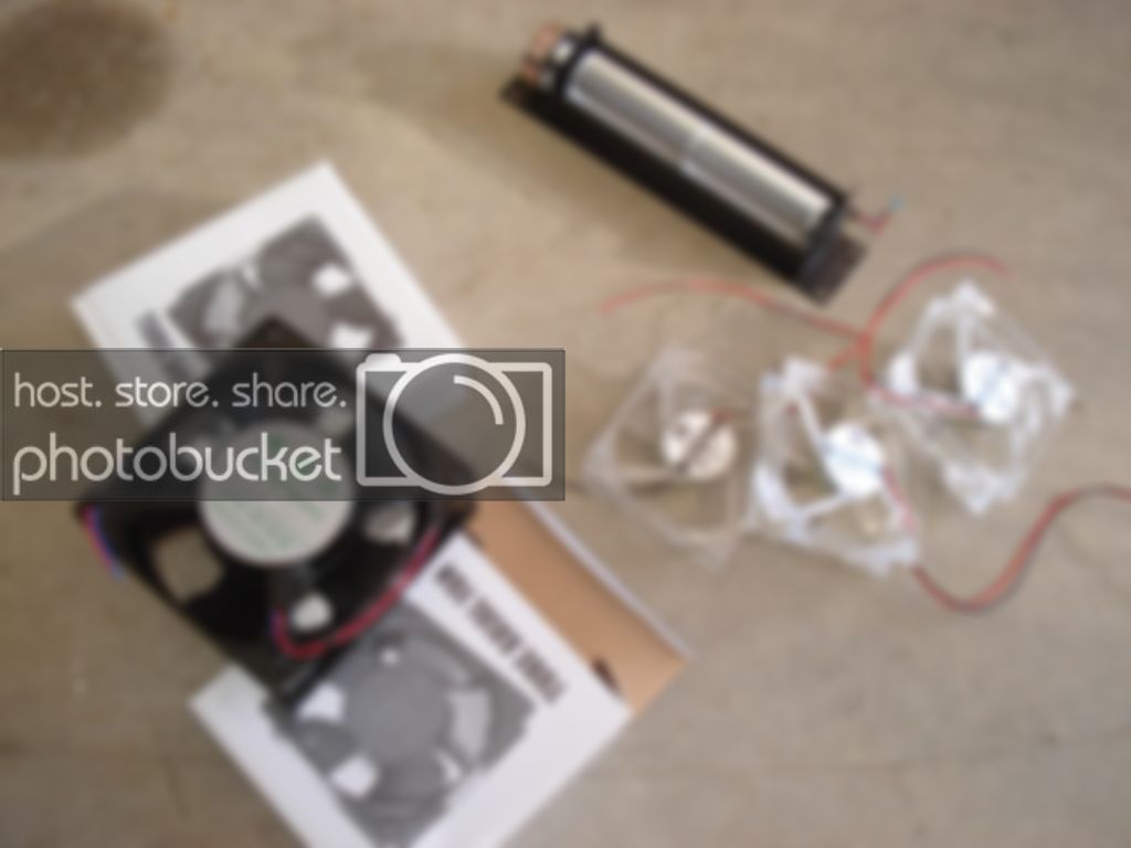

In order to get them replaced, you can't splice into them. So what you can do is find MOLEX to Fan adapters. It should look like this:
I'd cut off the connector for the fan, and then wire it like that. So you don't have to cut into the original fan.
