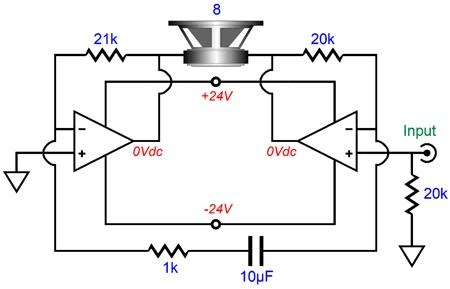

I will start it off. I believe there are such things as "Bridged - Mono Amplifiers." Some would say you can't bridge a mono amplifier. Believe it or not, many mono amplifiers are bridged. Here is what I would present as proof.
Please feel free to insert your opinions, proof, disproof, facts or other.
Bridged-Mono Amplifier.
I believe what this shows is two mono amplifiers in a strapped configuration. Two monos but as a whole they are calling it "bridged".
A misnomer? Maybe, but electrically I think they are the same thing. When repairing my 2 channel US Amps 500a I noticed that the positive wire of the left channel was soldered in the negative through hole of the circuitboard. I asked the tech that was guiding me about this and he said it was common design. He said it is basically two mono amplifiers in one case.
That is exactly correct. The additional amp is there increase the rail voltage and make a more powerful mono amp. I linked the site where they discuss it. It is all the same circuit on the same board with 1 input and 1 output.

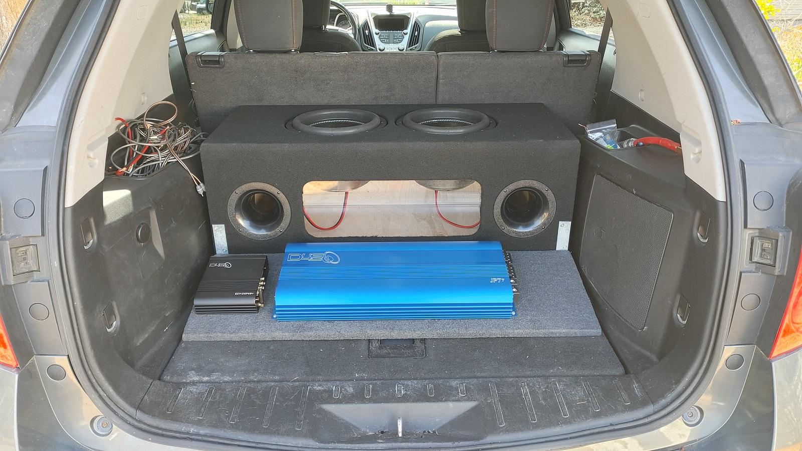

Haven't experienced it, but if they have the same excursion at the same frequency, and are the same size, does paper move less air than poly?
Are you swapping in drivers that have a lower output in general? Crossovers different? Higher LF dropoff below a certain threshold?
More excursion does not mean you will have more bass. Excursion is desired if you want to feel the bass.
True... I have often wondered at what size and mechanical limits does a subwoofer become too slow to keep up with music?
A lot of people believe it takes excursion to make loud hard-hitting bass. It does not. Power, speaker design, and the box determines how loud and hard the bass will hit. Excursion is only nice because it allows us to feel the pressure of the bass.
