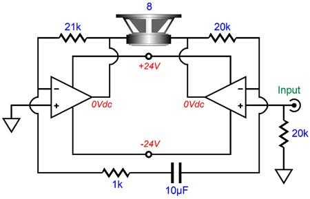

Which is the diagram I have posted. Two amplifiers bridged in a mono amp. 1 input, 1 output.
Two amps is not "a mono amp".
This diagram represnts "a mono amp".
Two of them would would be mono ampS.
It take more than one mono amp to make a bridged configuration.
One mono amp cannot be bridged.
Bridge Amplifiers
"A bridge amplifier holds two internal power amplifiers that put out a differential/balanced output. This arrangement takes advantage of solid-state power amplifier's ability to swing high current, while being voltage limited. In short, a bridge configuration allows us to get four times the amount of power output from power-supply rail voltages than what we would get with the same rail voltages with the conventional single power amplifier. For example, with +/-24Vdc power-supply rails, a single solid-state power amplifier might swing voltage peaks of +/-20V, which into an 8-ohm load equals 25W. In contrast, two of the same power amplifiers in a bridge configuration would yield +/-40V peak voltage swings, which equals 100W into 8-ohm loudspeakers." - Tubecad.com
Bridge amplifiers would take on more voltage and therefore create more power. Possibly 4 times the amount as that of a single mono amplifier. Radios, as in single ended. As to whether two mono amps can be combined, if you consider pre-amplifiers and power amplifiers a mono amp, then yes, you can bridge them together. Using a pre-amplifier and a power amplifier would do.
