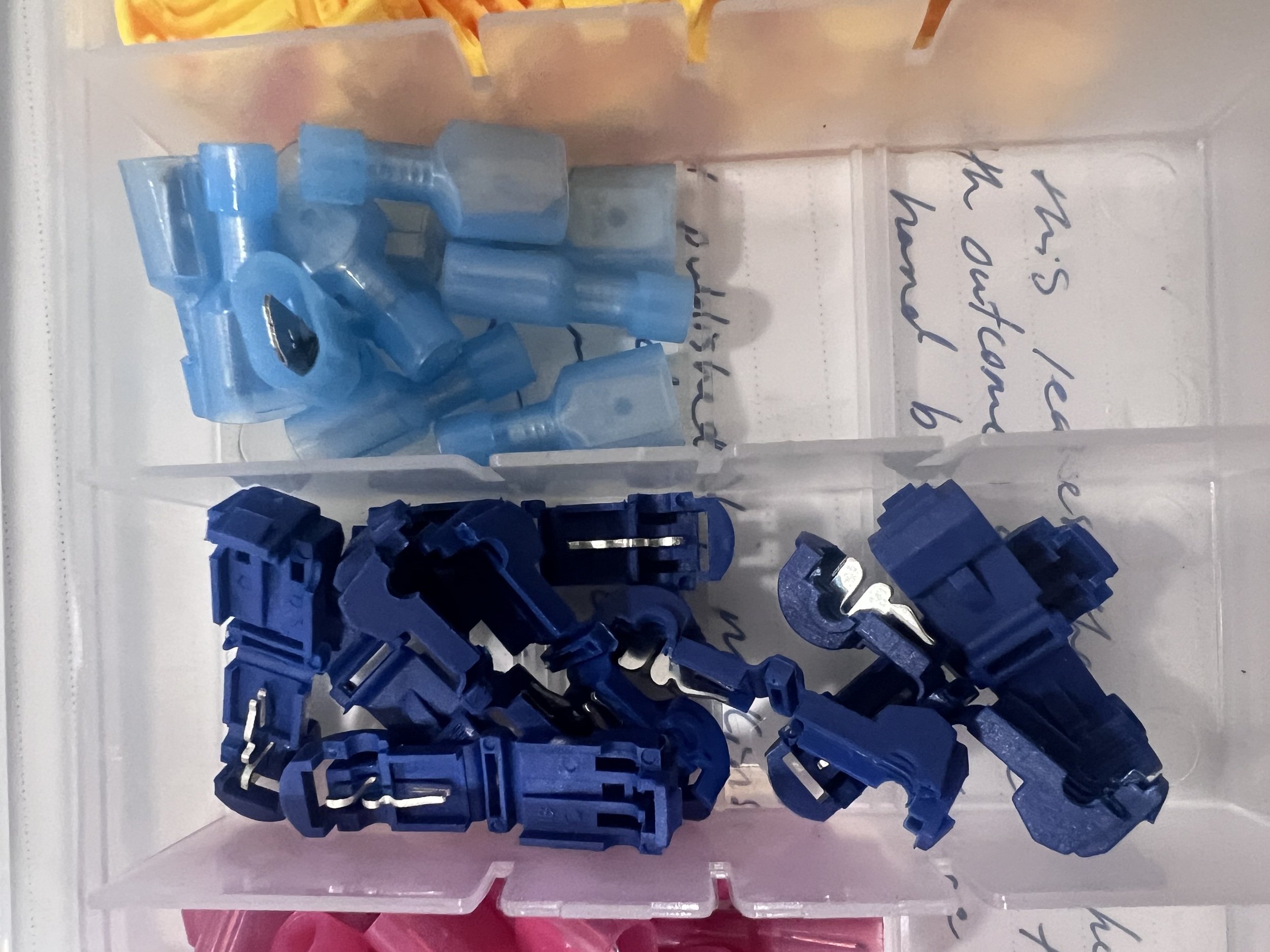

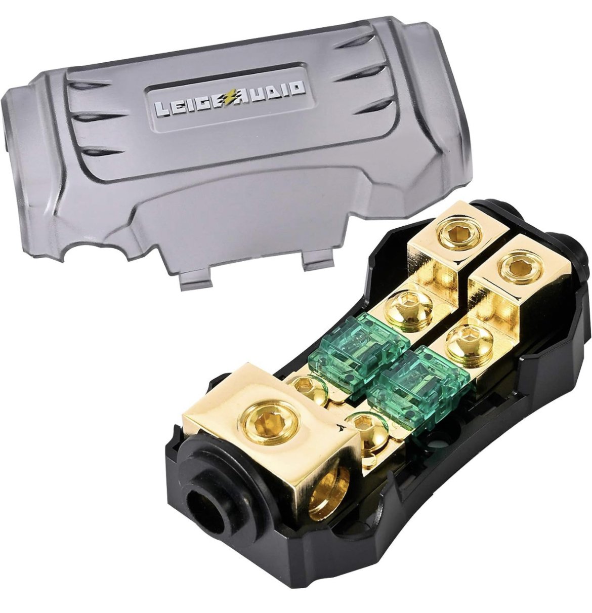

My original setup in this car was an Infinity 12” (forget the model) but years ago I changed to a Kicker 43CVR122. I’ve had this wired in parallel to an Alpine MRP-M500. Close to 20’ of 4 gauge power to the battery with a BOSS 100 amp fuse 4 inches from the battery and a Leiges Audio 4 gauge to 8 gauge reducer fuse block with 4 inches of 8 gauge running to the amp. I used T Tap connectors at the rear outs on my stock head unit with close to 20’ of 16 gauge speaker wire running to the hatch where my amp is. I’ve got about 9 inches of 4 gauge ground wire running directly to the chassis where I sanded down to bear metal. This setup has not given me any trouble over the years.

What are you using T-taps for?
