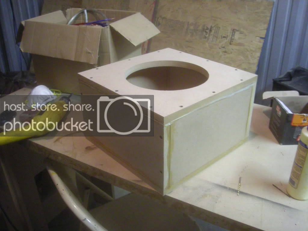

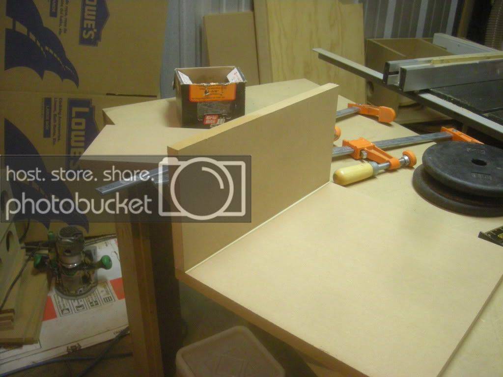

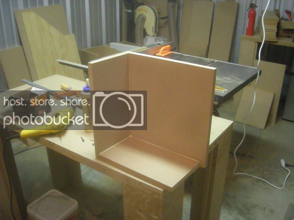

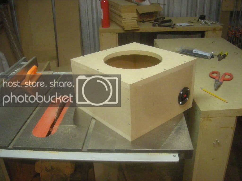

This was a fast build to say the least. Came to 0.633 cubes
Cleaned up and finished..

looks good for a sealed box why not double baffle it though
The better question is why would you? No 10" subwoofer is going to weigh enough to necessitate a double baffle (unless you're talking about something crazy, which I doubt you'd be putting in a sealed setup anyways) and on top of that, sealed boxes build very little sound pressure in relation to a ported box.
He said it wasnt necessary, and I would agree
