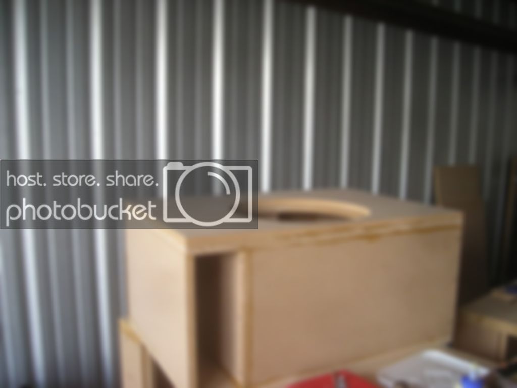

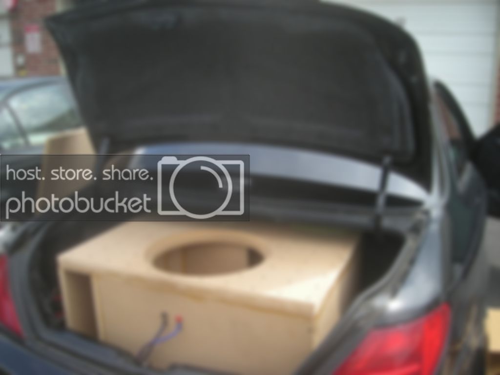

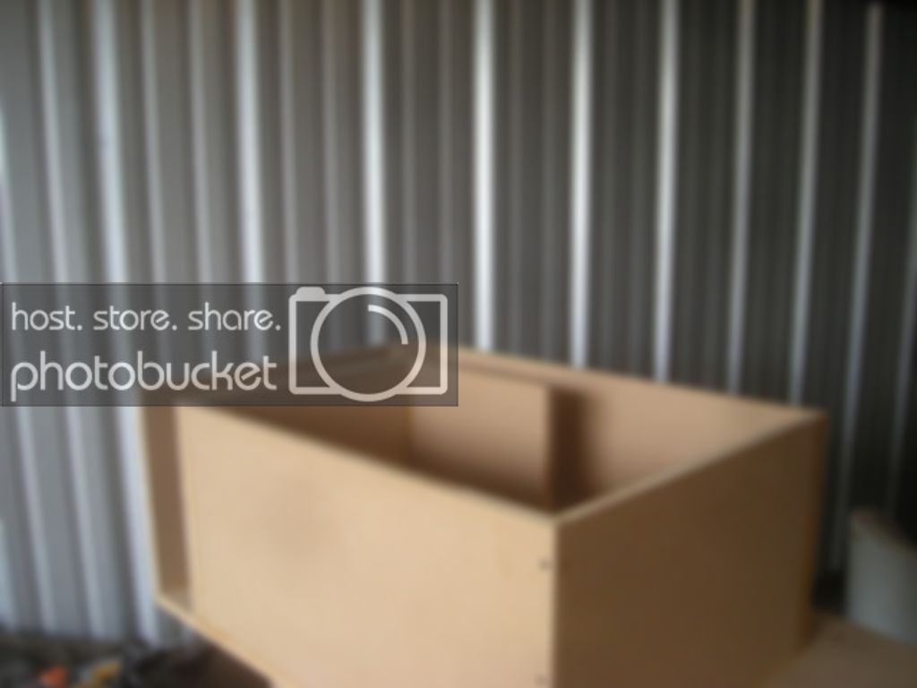

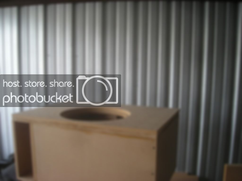

This enclosure was thrown together for the maxxsonics comp in chicago to run 129.9 no-sweat. It'll be a 15" Sundown Z15 off of a BXi-2400 but for the ride there my 15" TC9 will be giving us some bass.
Specs come to:
-3.5 cubes net
-33hz tuning
-60.75 sq inches of port area
It was a heck of a squeeze getting it in there..and when .5" of material got in the way of getting it in, he kicked it in...and I mean a 'this is sparta!' kick...I lawled //content.invisioncic.com/y282845/emoticons/laugh.gif.48439b2acf2cfca21620f01e7f77d1e4.gif
And it was scooted further into the trunk, not right up against the back like in the last pic. I also didnt get a pic of the 45's in the box...there were 2 more 45's added, one that you can see on the inside corner of the port's bend and one on the back right corner that's larger..
