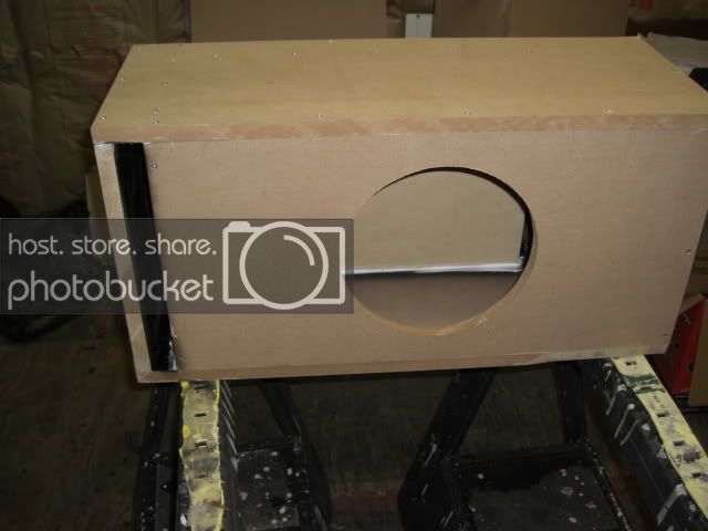

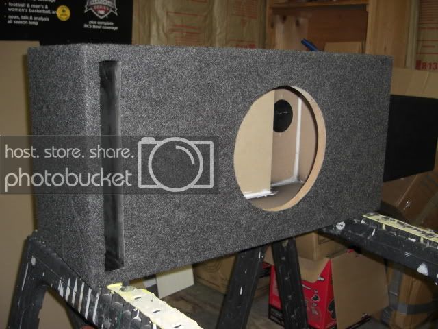

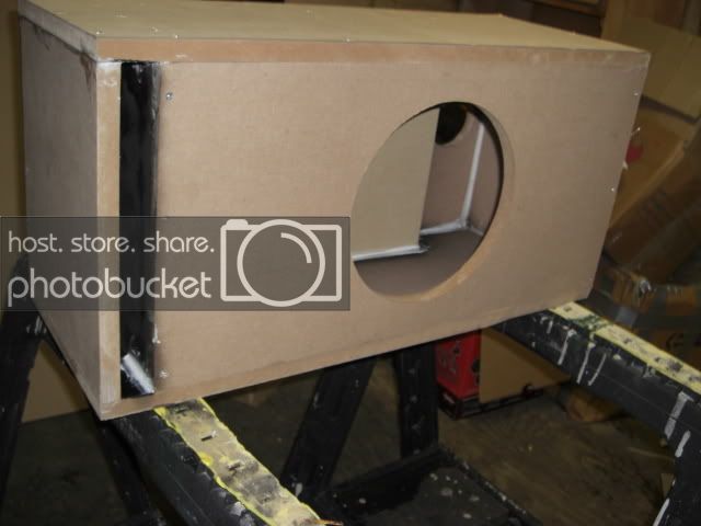

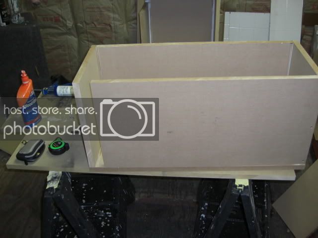

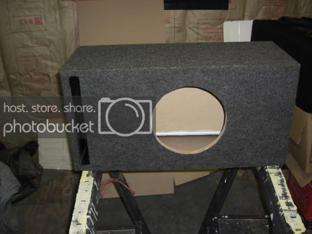

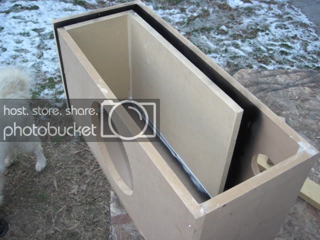

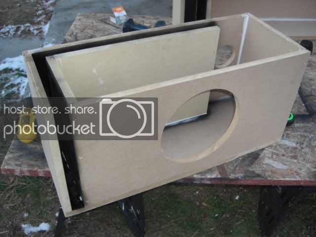

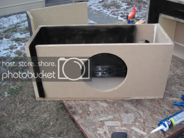

Box Specs are:
1.5 cu ft
Tuned to 28.5
15.6" port area
Sub is SSA Icon 10 D2
Powered by a US MD1
Pics.....
Now I am just waiting on the Icon to arrive
Good stuff, Vitveet is a cool dude that does good work. Nice box //content.invisioncic.com/y282845/emoticons/thumbsup.gif.3287b36ca96645a13a43aff531f37f02.gif
yea I am excited about meeting up with him tomorrow and picking it up, and hopefully I will have the Icon waiting on me when I get home:)
^^Nice meeting you man! Hope you enjoy the enclosure and the sound of a correctly designed/built ported enclosure!
LMK if you need anything, thanks!
V.
nice box but i would have tried to get a design with a bit wider of a port. ull probly get some port noise with that.
I agree about the port area... I wanted a wider port but to have it tuned to what I wanted this was best, and suprisingly I dont have the port noise I thought I would...
now I am just running into some problems with the wiring:crap:
