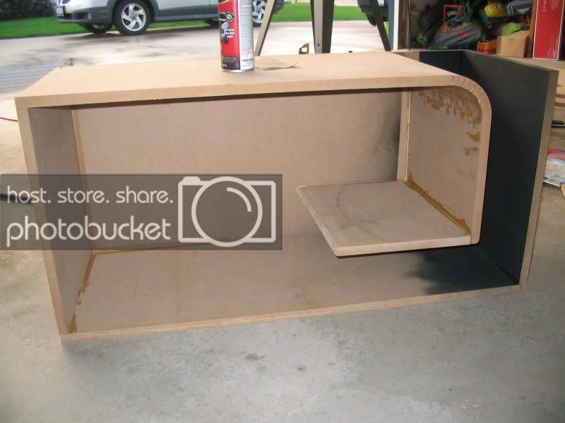

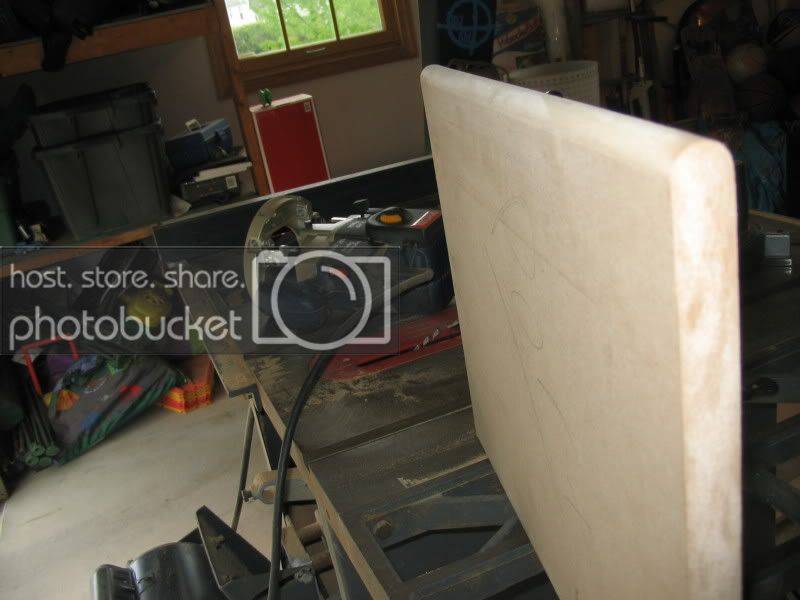

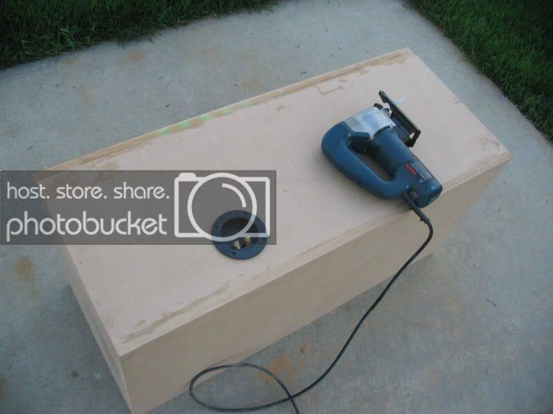

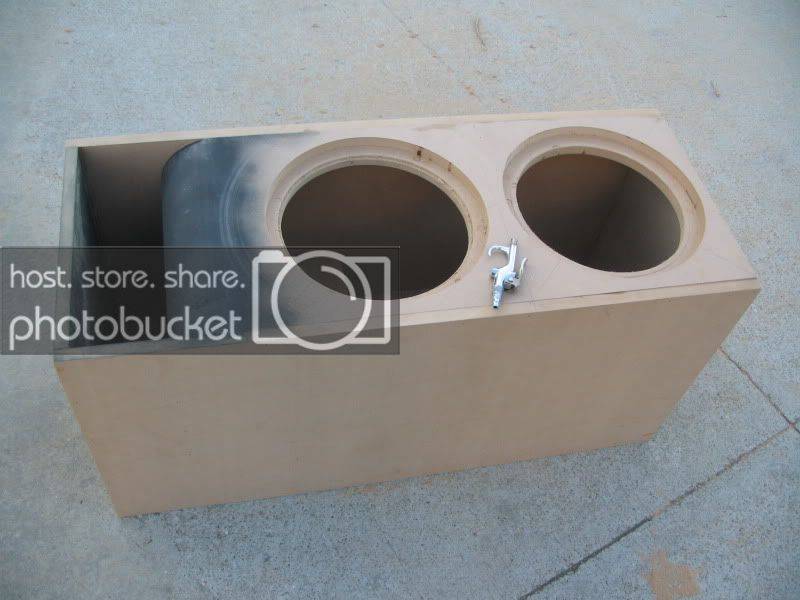

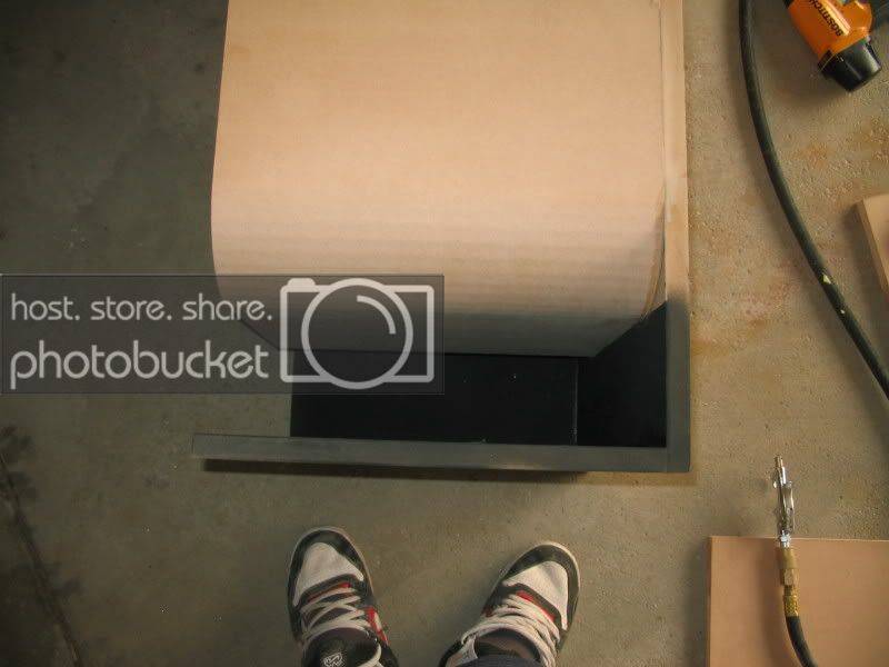

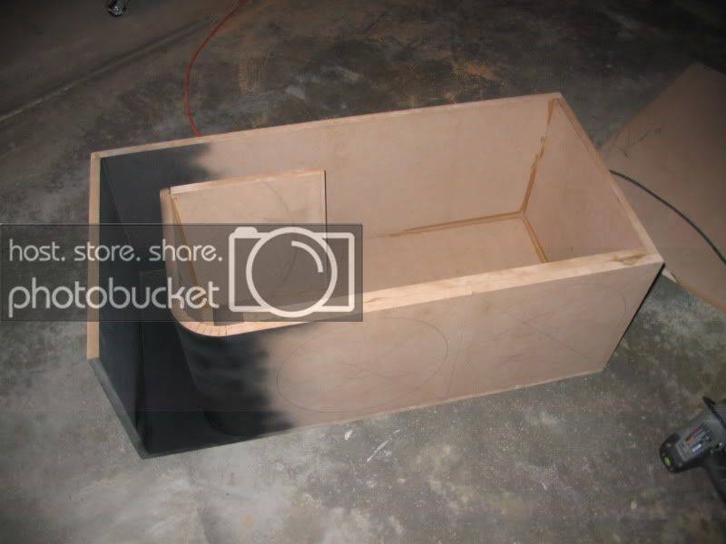

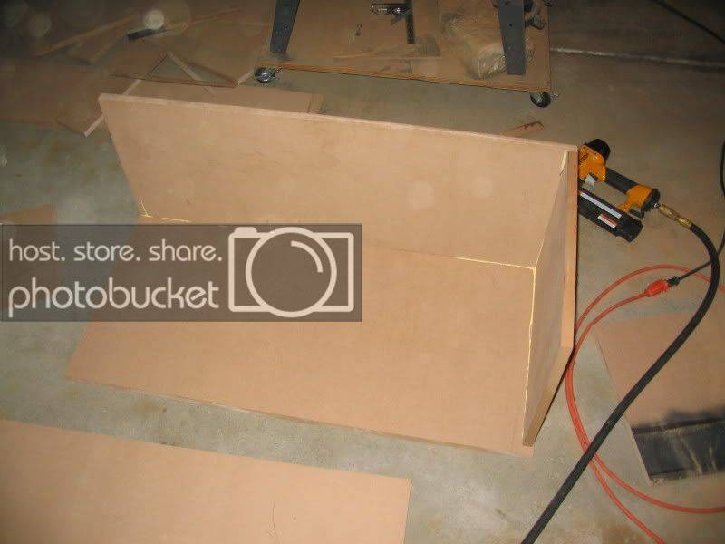

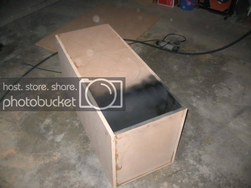

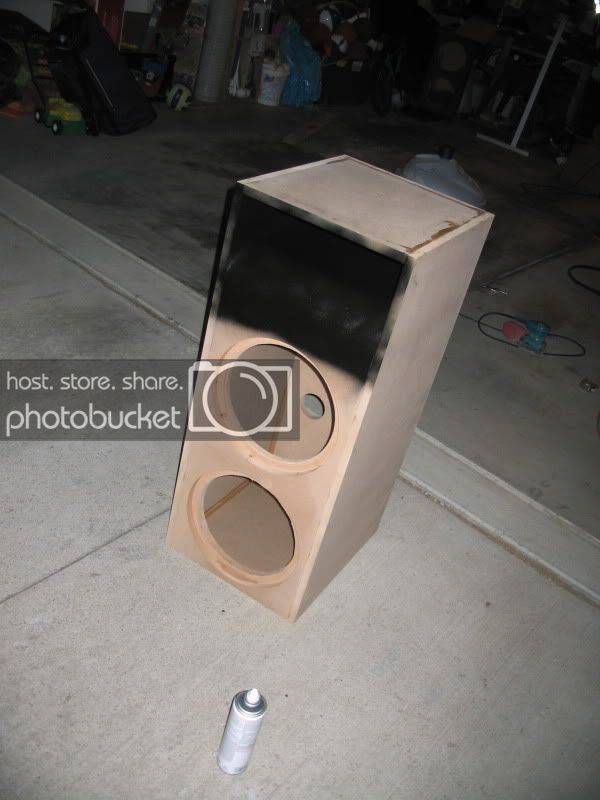

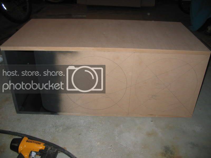

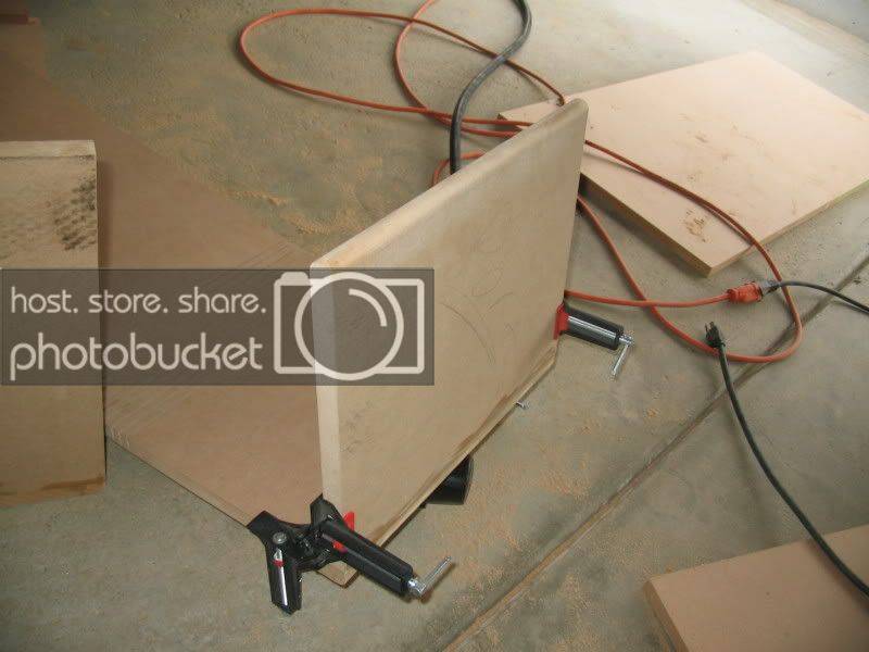

This enclosure is for his 2 12" dc Level 4s. It comes to 4 cubes tuned to 33hz after displacement. Onto the interesting stuff... pics...

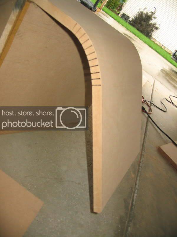

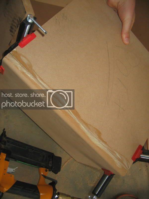

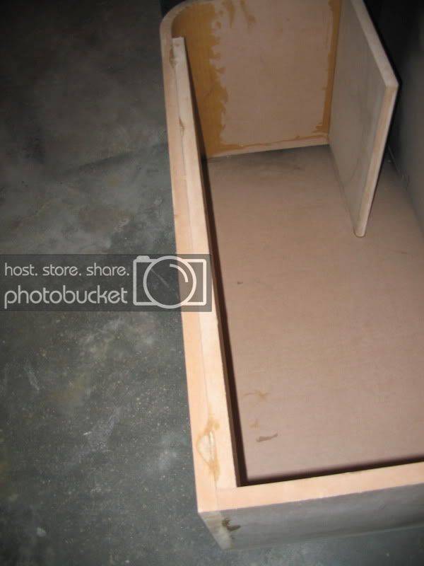

How does one kerf the mdf like that. Like how far do you cut in the wood and spacing? Looks awesome keep up the good work. And it also gives me an idea if you would so happen to share how to do it. Best way to share would be in a pm

Is there a certain distance you have to give yourself for the kerf? I would like to do a kerf port with (2) 15s, but only have 42" of width at max, wasnt sure if thats enough space.

Thanks man. //content.invisioncic.com/y282845/emoticons/biggrin.gif.d71a5d36fcbab170f2364c9f2e3946cb.gif as far as the added length of the radius, just depends on what radius i want to use for each box. i use a 3 inch alot of the time but sometimes bigger like 4 or 5.
