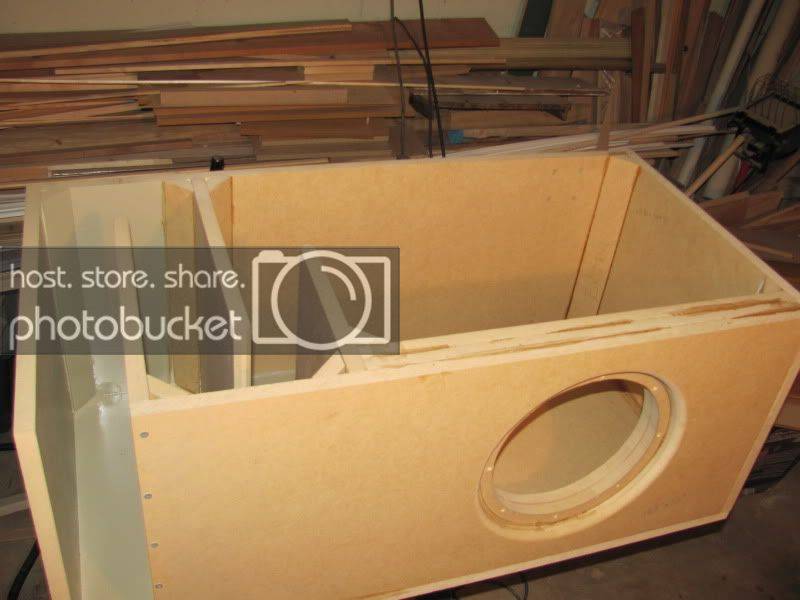

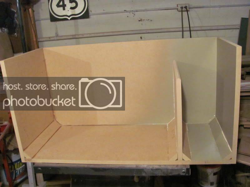

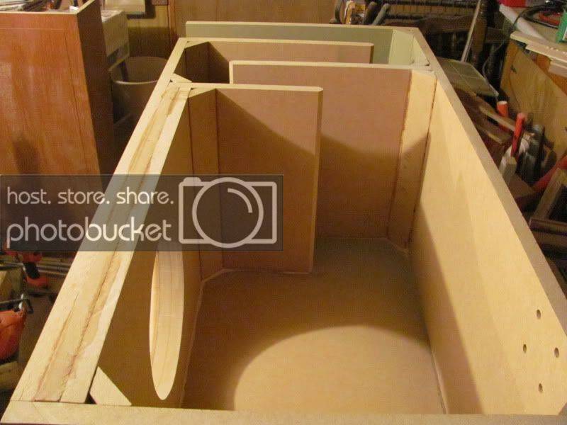

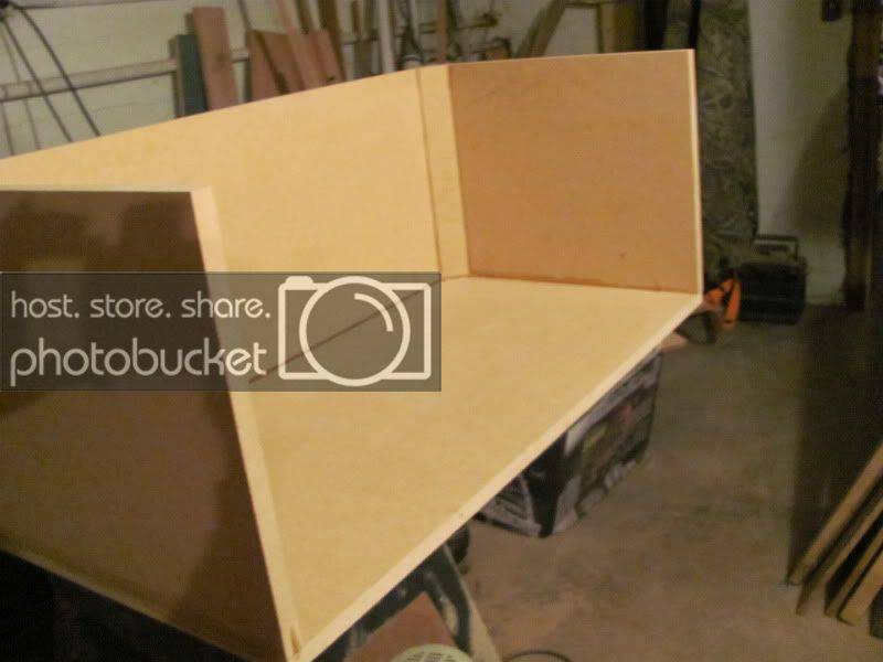

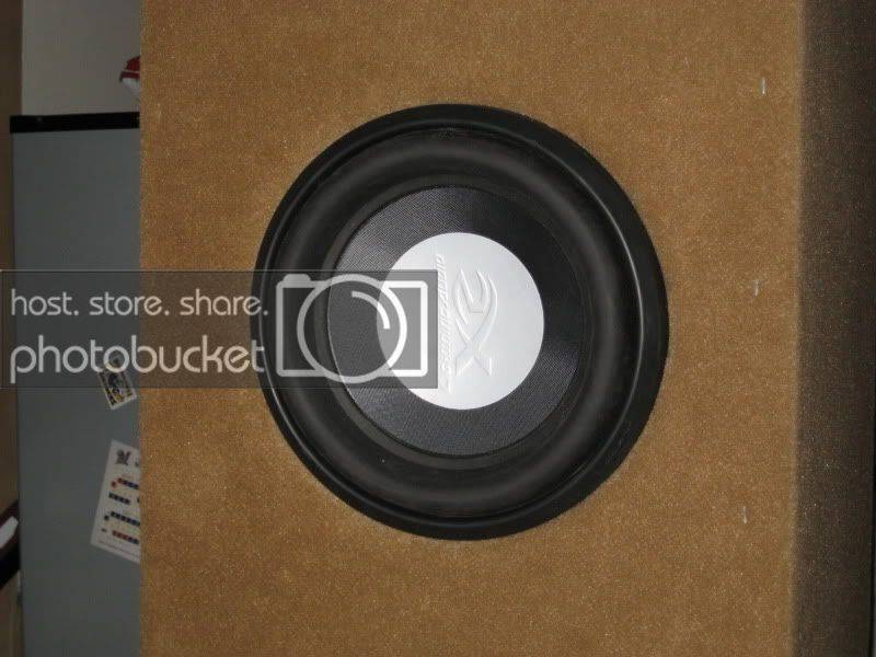

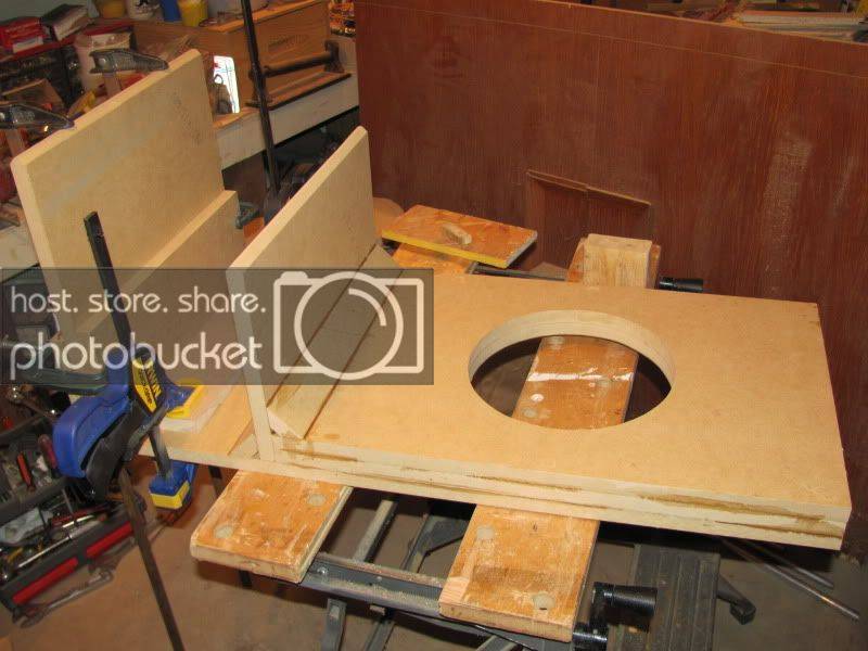

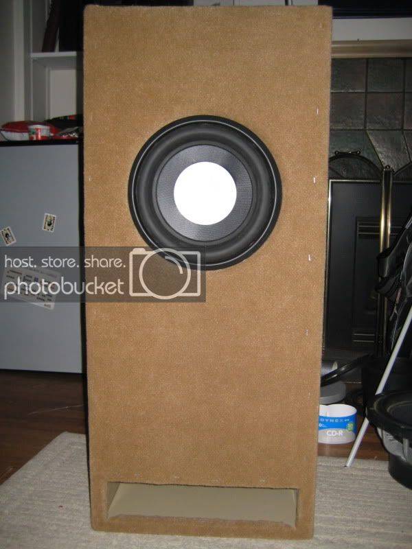

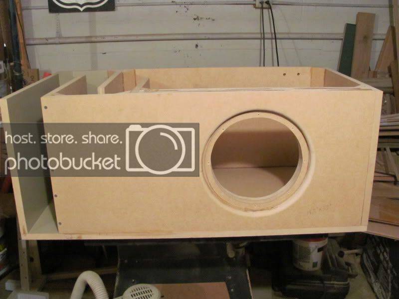

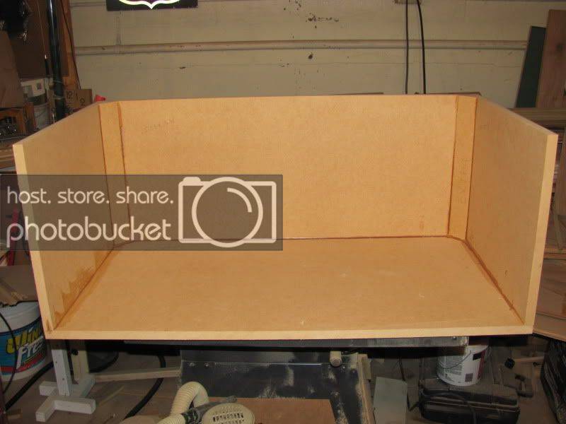

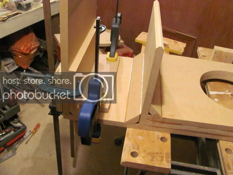

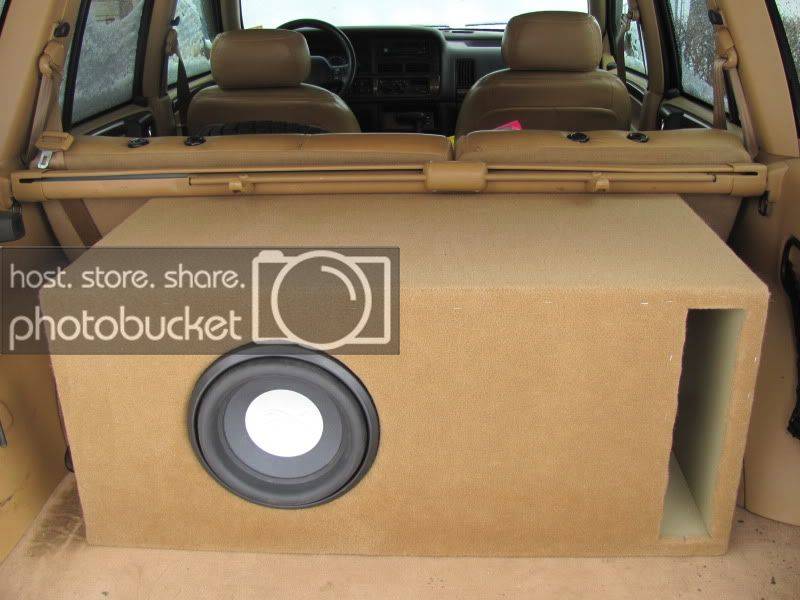

Hey guys, just wanted to post up some pics of the box that I just built for my Lightning Audio X2.H10.V4 Neo. This was only the second box that I have built, and the first one was a huge disaster lol, so I cam very happy with how it turned out. It is 2.75 cubes after displacement, tuned to 32hz. Triple baffle with rounded flush mount, and all corners are 45'ed. I will have some pics of it in my Jeep in the next few days, the carpet matches the interior color pretty well.

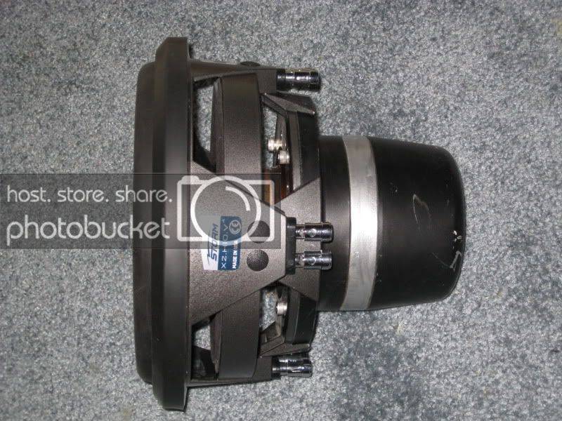

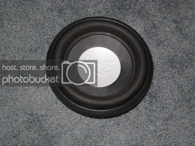

Here are some pics of the sub:

And the box:
Lol not gonna find these at walmart, I think they stopped making these around 04 or 05? And as far as videos, not yet, I might be able to make one sometime this weekend though.
Haha I was waiting for someone to say that. It's a pretty light sub since it's a Neo, but I would like to give a TC4000 a try sometime, so I figured I would build a bit overkill.
