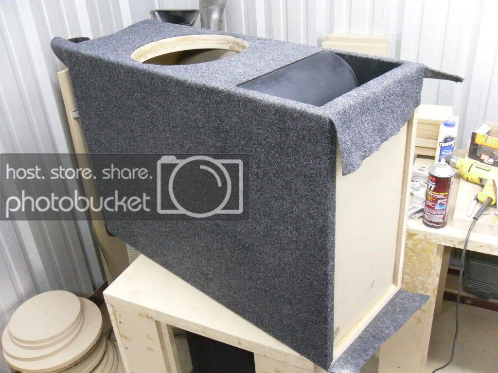

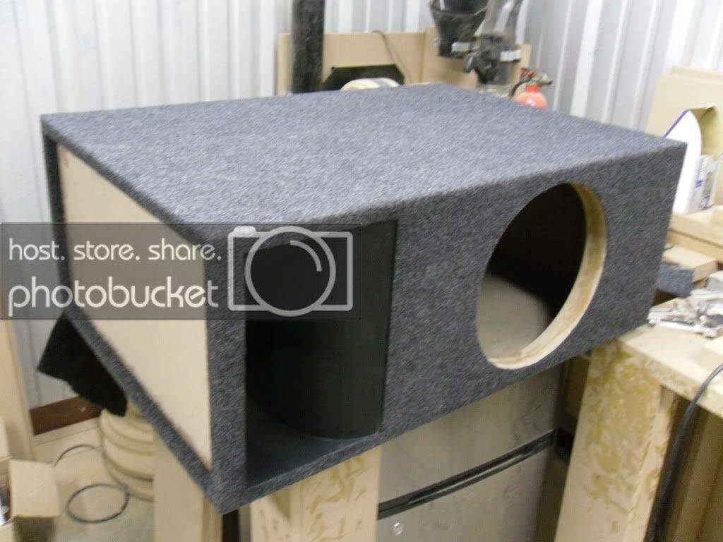

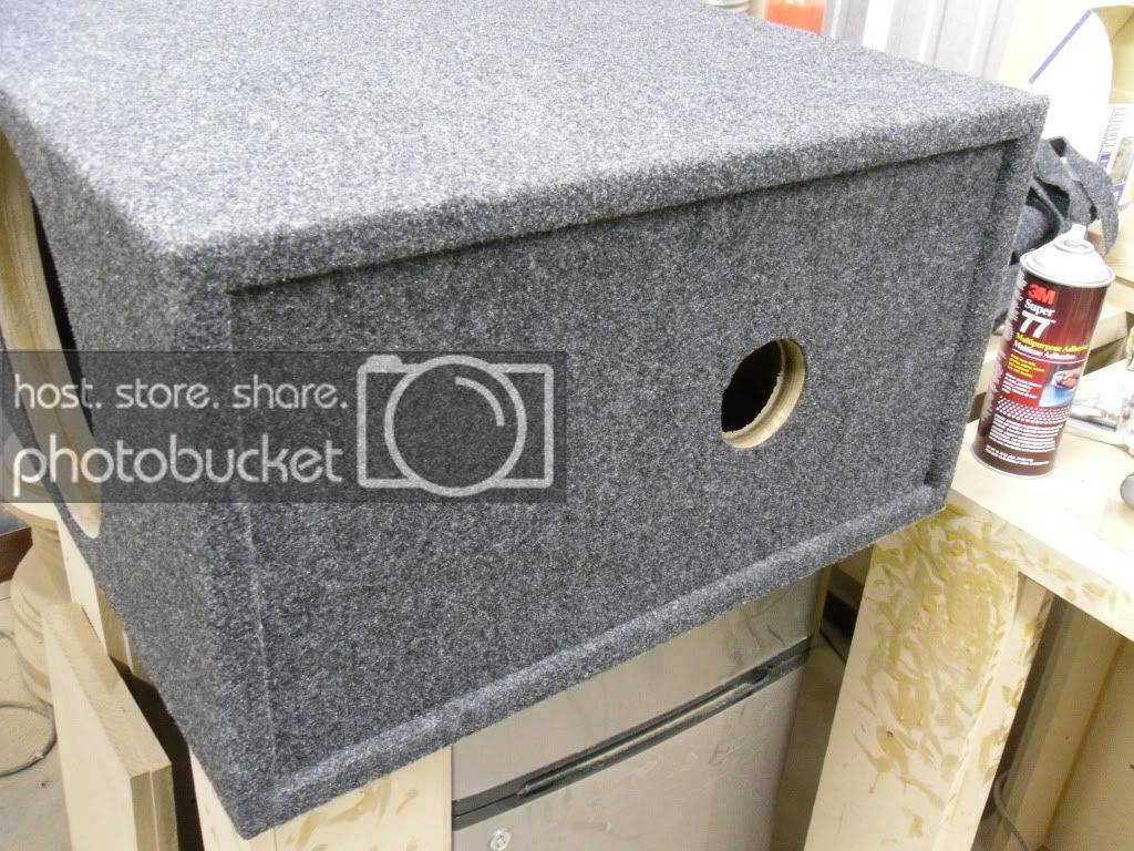

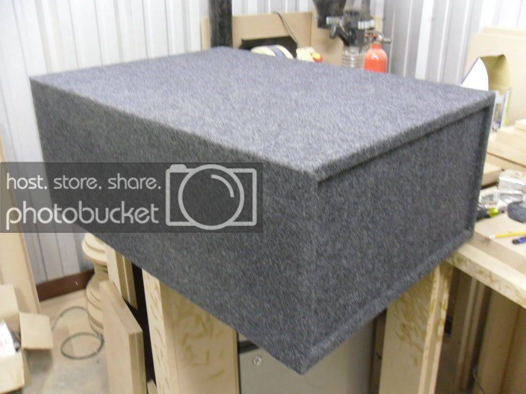

What do you use to tuck/cut the carpet on the side of the box where you have it recessed?
I wanna build a box like that with the recessed sides, but I dont get how you get that turnout. And then you just cut a piece to fit on the side and ran your blade around the edge?
Looks really good Id love a pointer or two
Thanks. And as for the side carpeting I usually go with a .5" recessed side and use spray adhesive, utility knife, and a large flathead screwdriver to do mine and it's always a good idea to have a pair of needle noes pliers handy as well.
I start carpeting by 'rolling' the enclosure in carpet, leaving a couple inches overhang on the sides to carpet the lips of the side panels. Then I cut each corners carpet at 45-degrees so they mate together nicely...spray adhesive along the lip and use the flathead to press the carpet down into the lower corners.
Then I do the same to the other side...then go back to that first side and run the blade on that lower corner to cut the excess away (going to the other side before cutting allows the adhesive to cure before going back and cutting, this ensures the carpet doesnt move on you when you run the blade along the corners...this is when you may need the needle noes pliers if it moves etc.)
Then cut a piece of carpet a little bigger than the side panel, press it in.....do the same on the other side, letting the adhesive cure while working on the 2nd one...then go back and cut the excess...and you should have clean looking sides //content.invisioncic.com/y282845/emoticons/smile.gif.1ebc41e1811405b213edfc4622c41e27.gif...hope that was enough discription
Ya man, I just can never seem to get my carpet to cut cleanly, it always has a spot or 10 where it didnt cut all the way through or it pulls the carpet with it or something
And my blades are brand new, didnt know if there was a specific blade, Im just using a regular contractors blade
That's why I move onto the other side now, it lets the adhesive cure a bit and holds it much better after a couple minutes rather than you going straight to it and it still being able to slide everywhere.
And I have this one: http://www.mypencil.com/mall/BOS10480.jpg
It's a tank and with good pressure can cut through just about anything (I think 11 dollars or so at home depot and comes with 2 extra 'sleeves' of blades already in it too)
And it does take time to get carpeting down, eventually its just 2nd nature

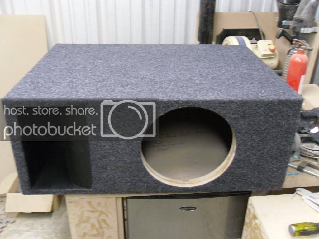

Looks good ...what that wrote on the inside of the box?
Thanks. And I write all of the specs for the enclosure and who it's for, the date, etc. Just so the specs and info are handy if its resold or whatever //content.invisioncic.com/y282845/emoticons/smile.gif.1ebc41e1811405b213edfc4622c41e27.gif
