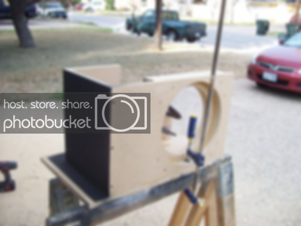

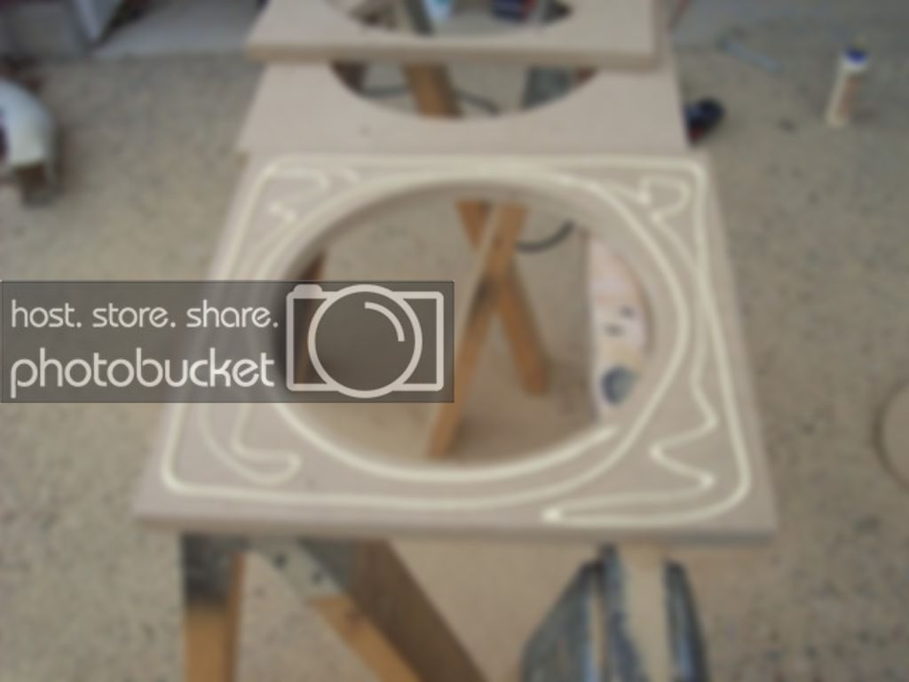

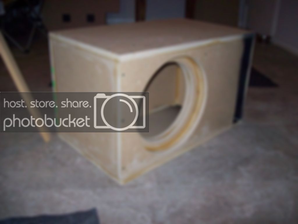

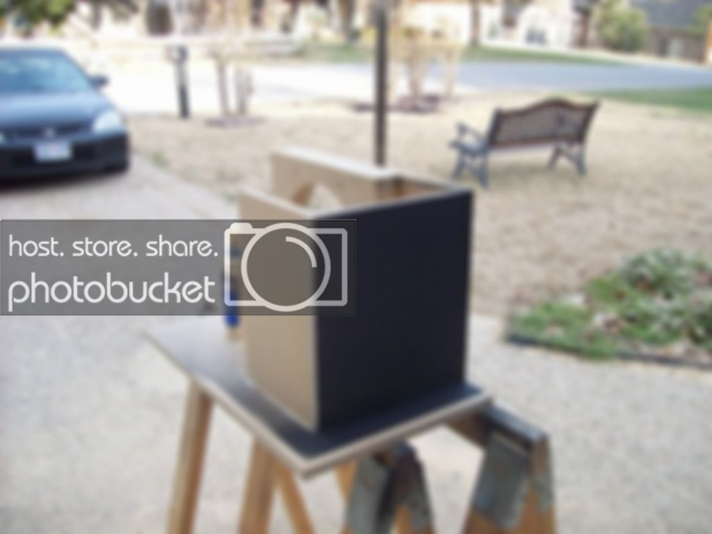

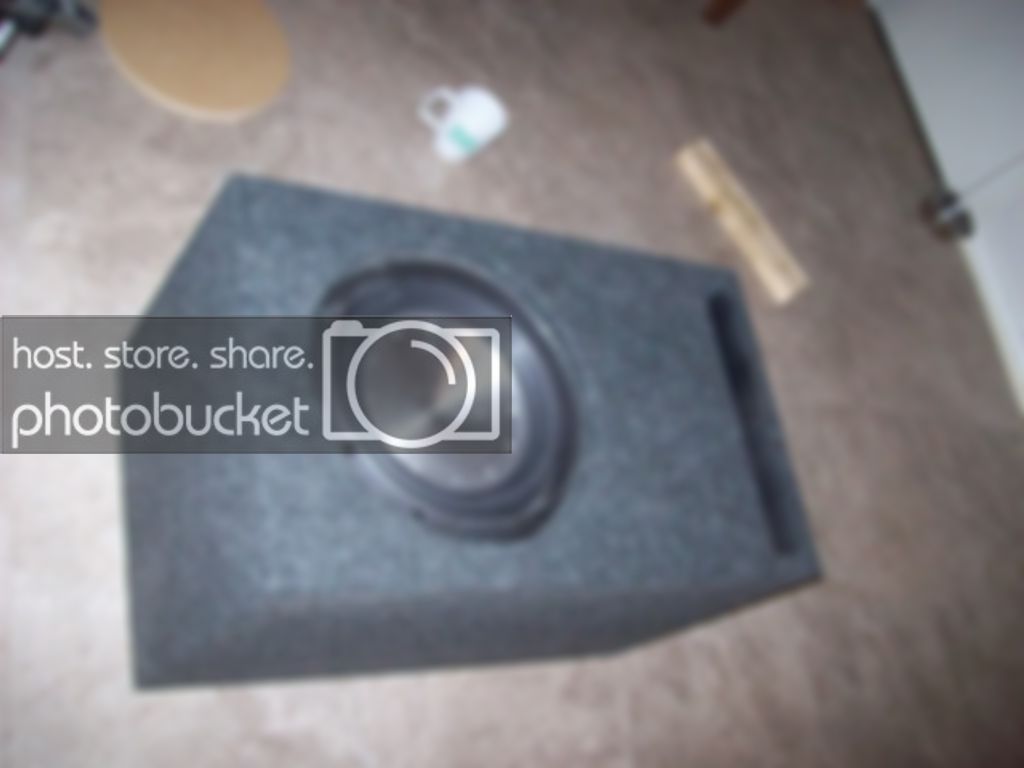

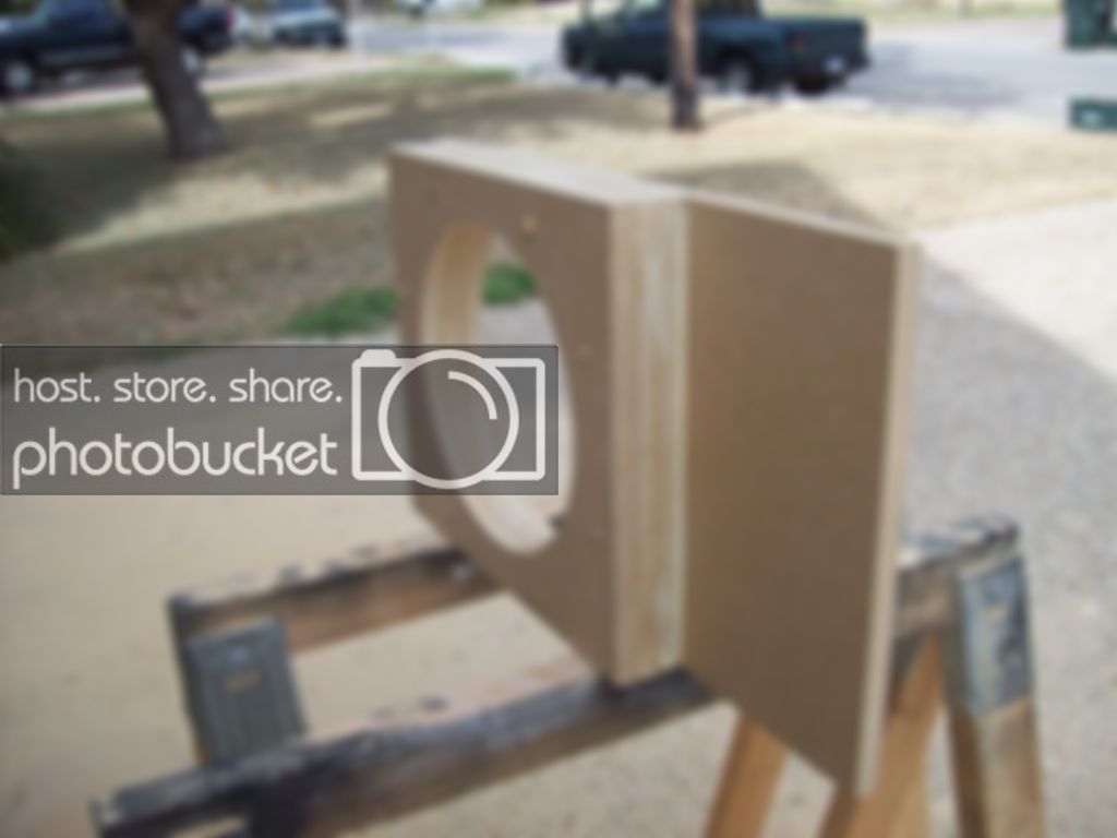

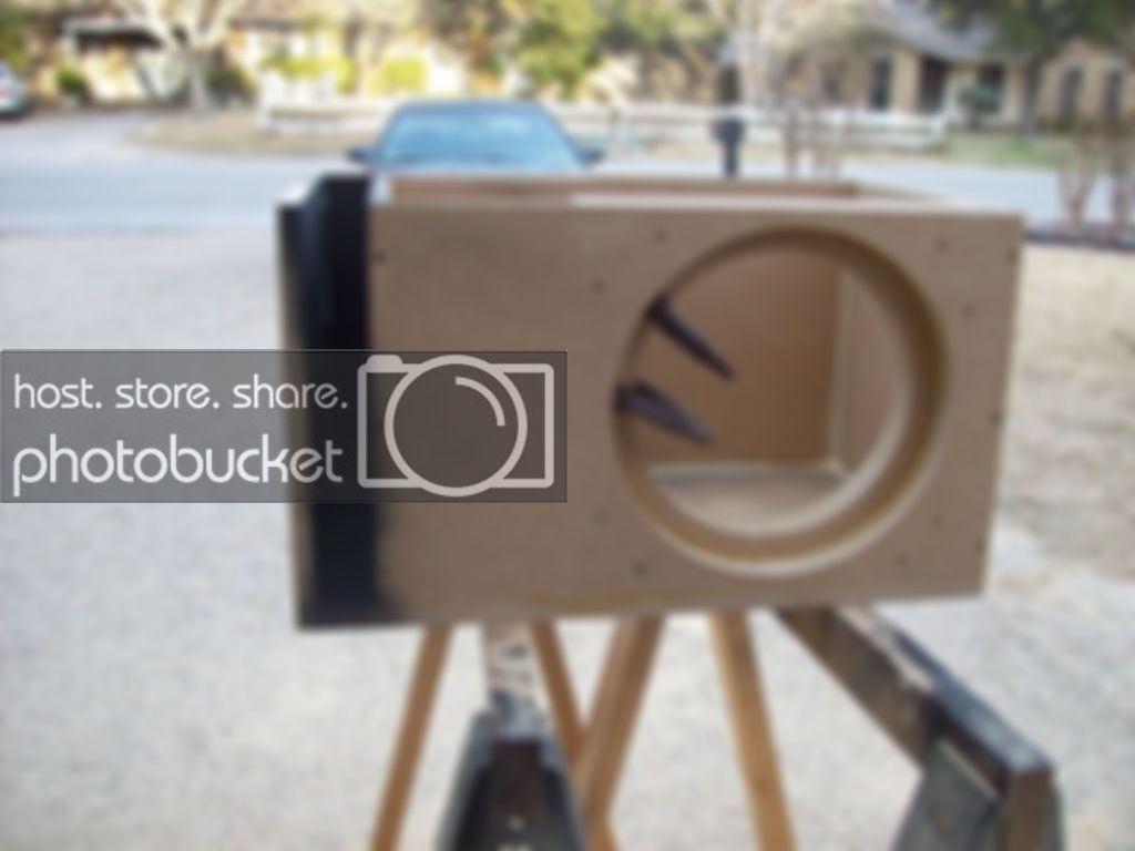

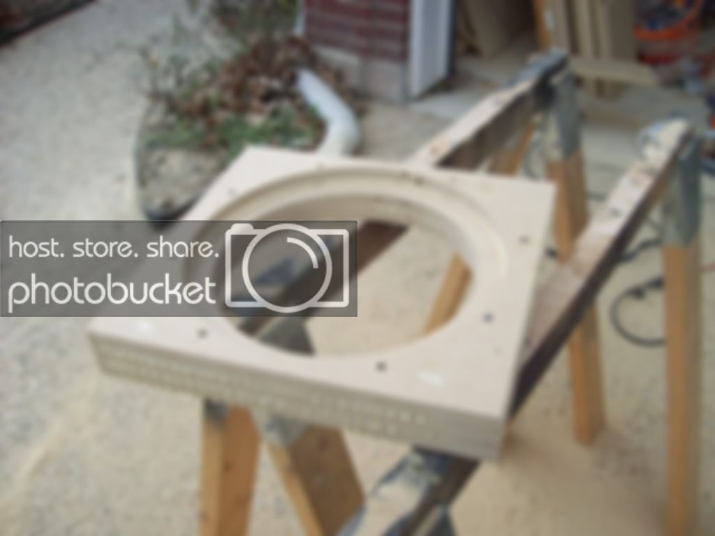

2.2 cubic feet @ 37 hz just under 15" per cubic foot of port area. Real simple but looks good and is loud

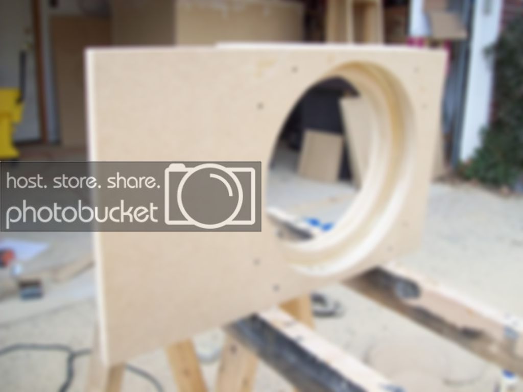

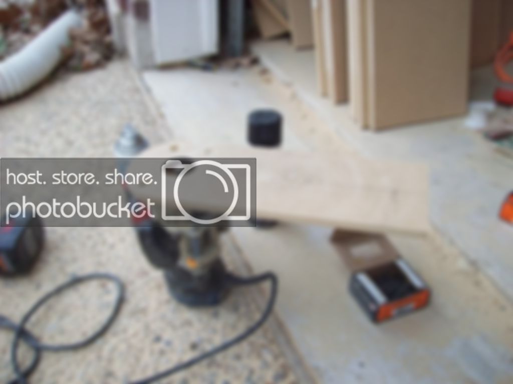

My little router jig I made

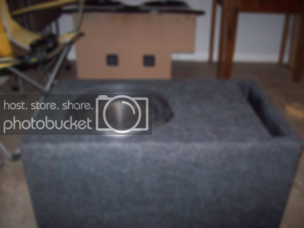

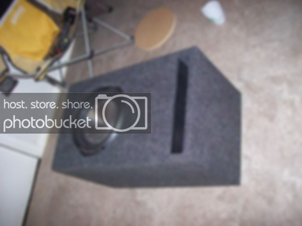

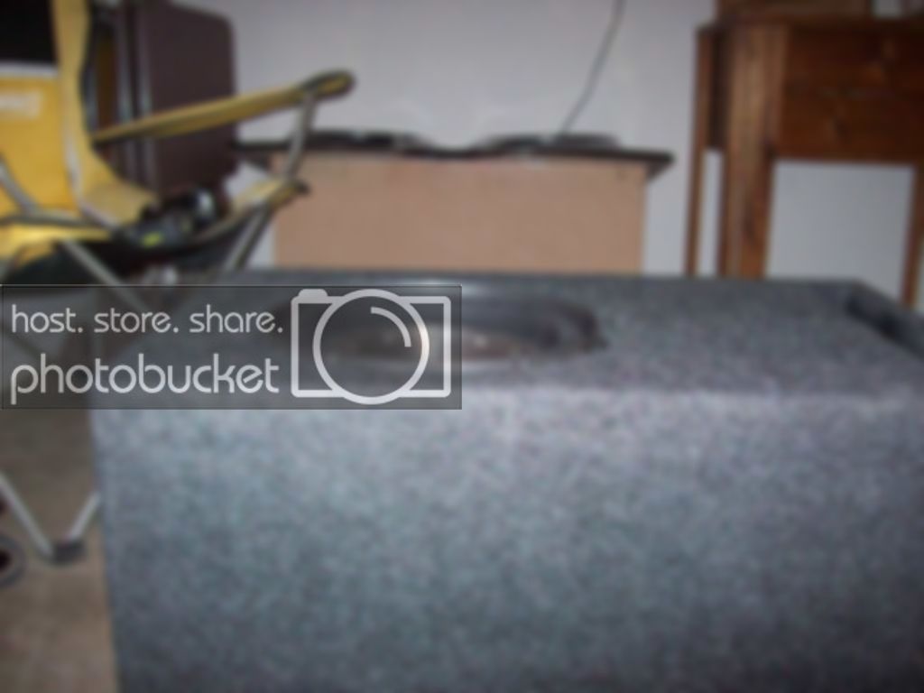

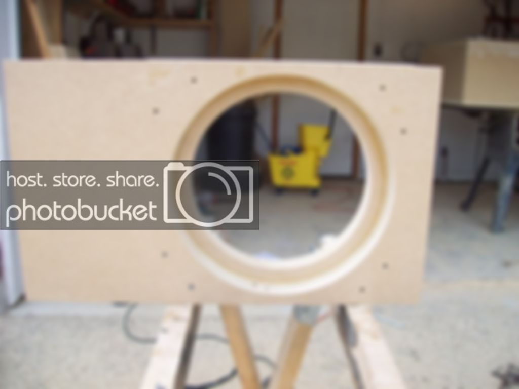

All finished just got to carpet it to make it look perty

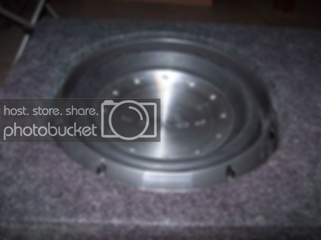

I didn't get any of it installed and the guy already left. It went in like an 02 Jetta. He likes it facing forward cause it don't make his trunk rattle //content.invisioncic.com/y282845/emoticons/confused.gif.e820e0216602db4765798ac39d28caa9.gif
