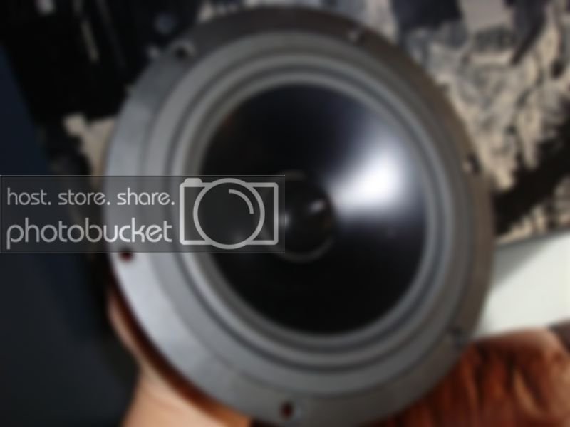

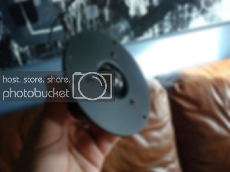

I decided a while back I was going to build my own Loudspeaker. So, I did.
The drivers used in the design are Dayton RS180-8 and Dayton DC-28F-8.
My basic design goal was something that sounded decent, wouldn't be too expensive and would take up a very small footprint.

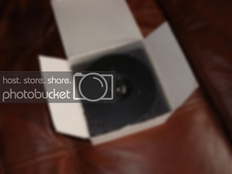

Drivers:

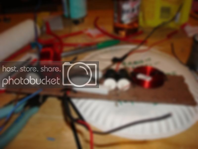

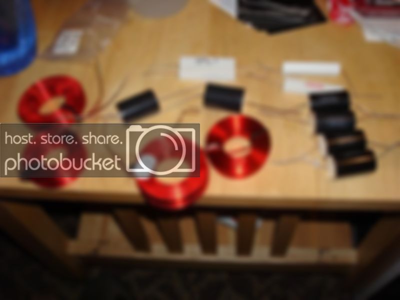

Crossover Parts:

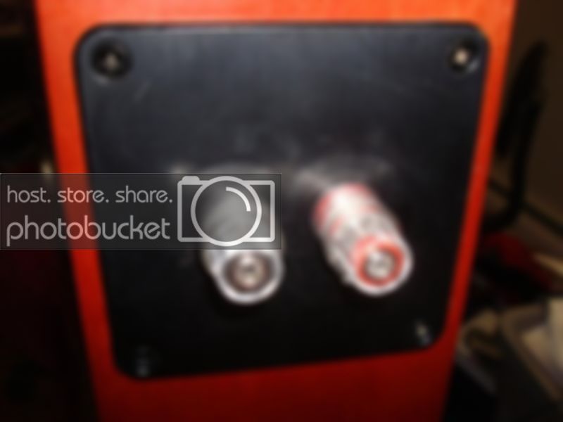

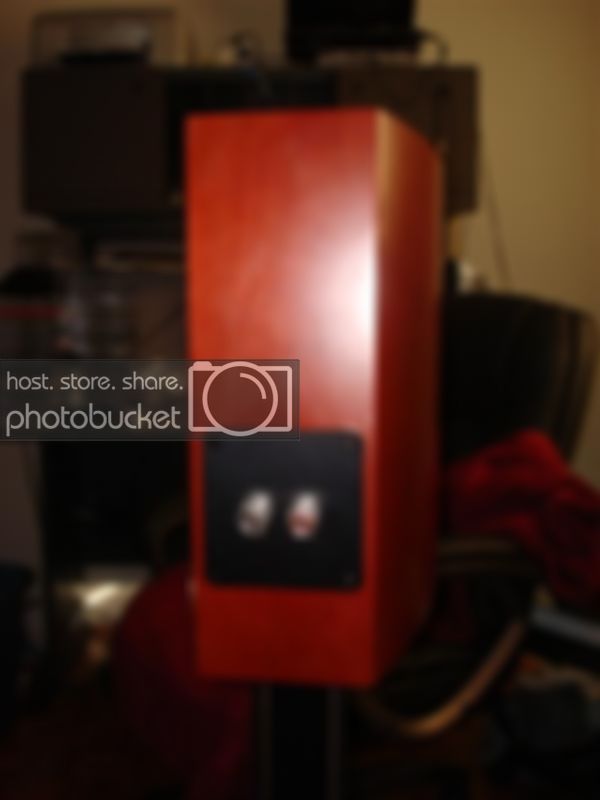

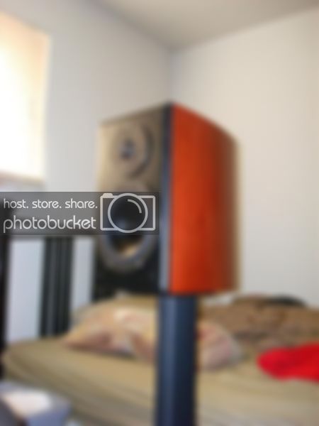

Back Plate: Finished Pictures:
I'll post more about it later...
It obviously needs to be cleaned up a bit before it is totally finished.
Also, I am getting some Black Machine Screws to hold in the drivers.

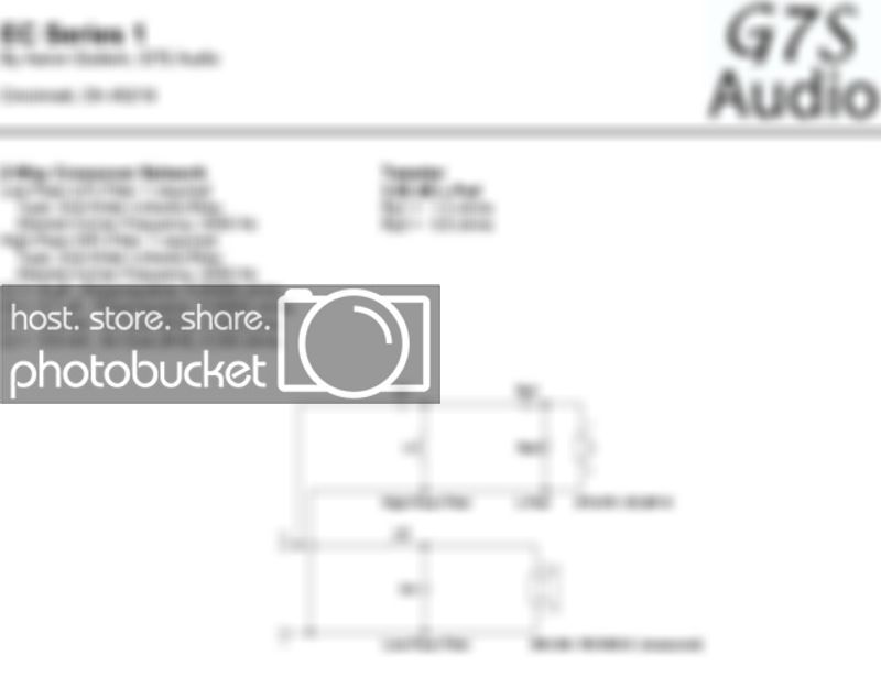

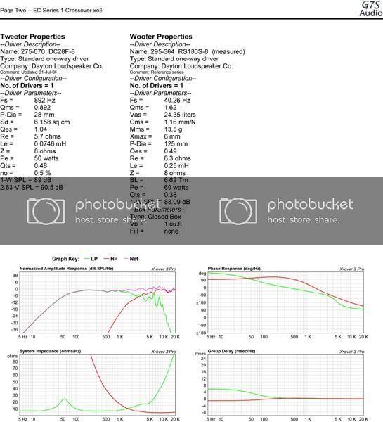

Here is the crossover design. Just a simple 2-Way 2nd Order LR.
looking good..whats the response on these babies?
I haven't swept them yet. I'll get around to that eventually. But, they actually sound really good. I was surprised.
If you look at the one picture with the crossover information, you can see the 'expected' response based on measurements I have taken and that others had taken...

The red cabinet, black face is my favorite look "The zoolander blue steel... errr red steel look' //content.invisioncic.com/y282845/emoticons/suave.gif.858fc102f7646e678ee8af7e1fbc41d1.gif//content.invisioncic.com/y282845/emoticons/satan.gif.9c6a335ed7aeeed3ee273e573f1fcaac.gif//content.invisioncic.com/y282845/emoticons/peace.gif.2db28b618ed8d1964ebbe2f5021d2c39.gif

The red cabinet, black face is my favorite look "The zoolander blue steel... errr red steel look' //content.invisioncic.com/y282845/emoticons/suave.gif.858fc102f7646e678ee8af7e1fbc41d1.gif//content.invisioncic.com/y282845/emoticons/satan.gif.9c6a335ed7aeeed3ee273e573f1fcaac.gif//content.invisioncic.com/y282845/emoticons/peace.gif.2db28b618ed8d1964ebbe2f5021d2c39.gifhttp://www.urbanhonking.com/cowboyz/archives/zoolander.jpg

Crossover Parts (The way I would do them now vs Before)
