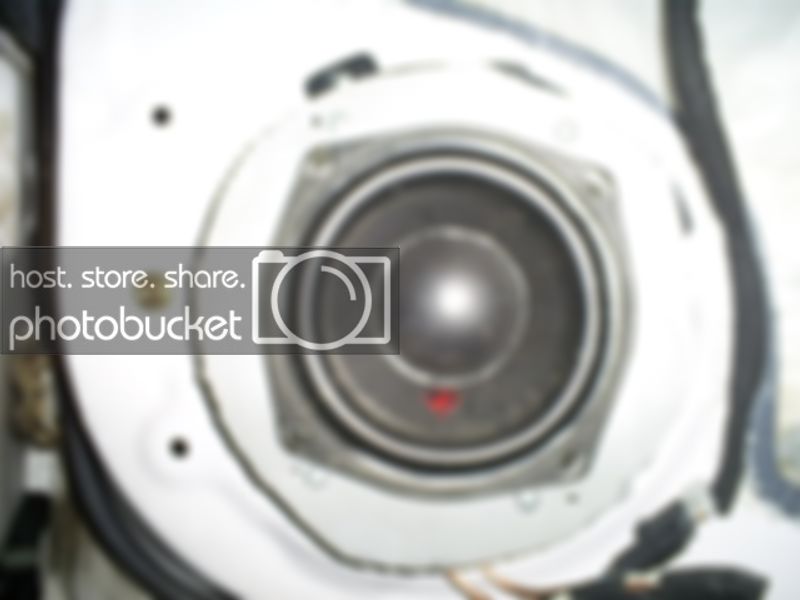

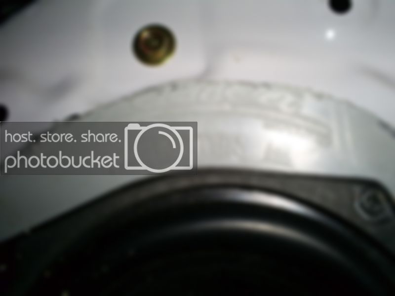

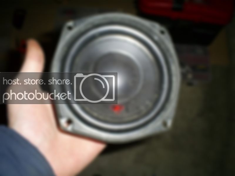

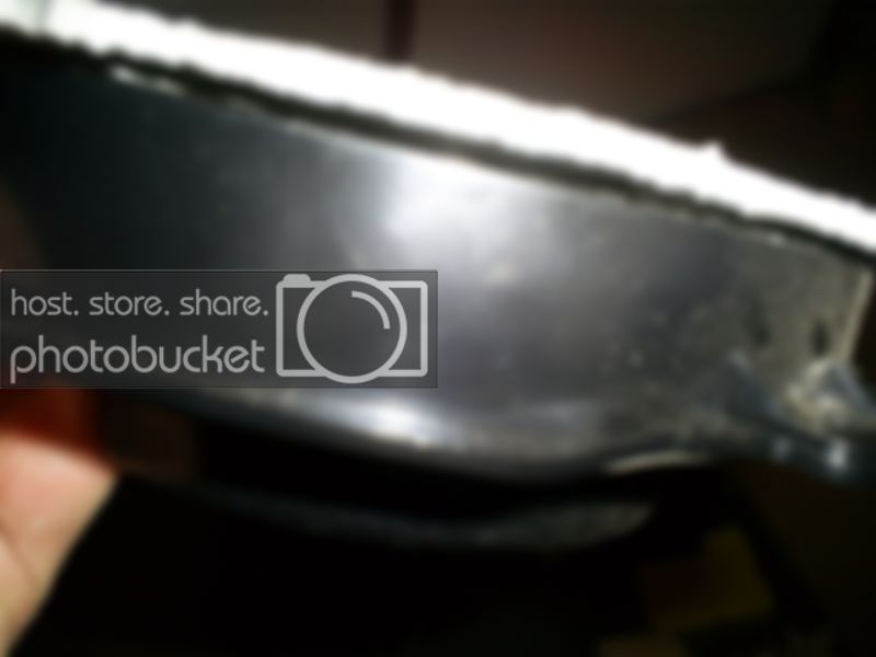

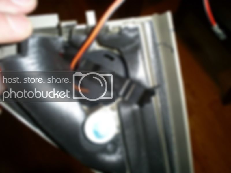

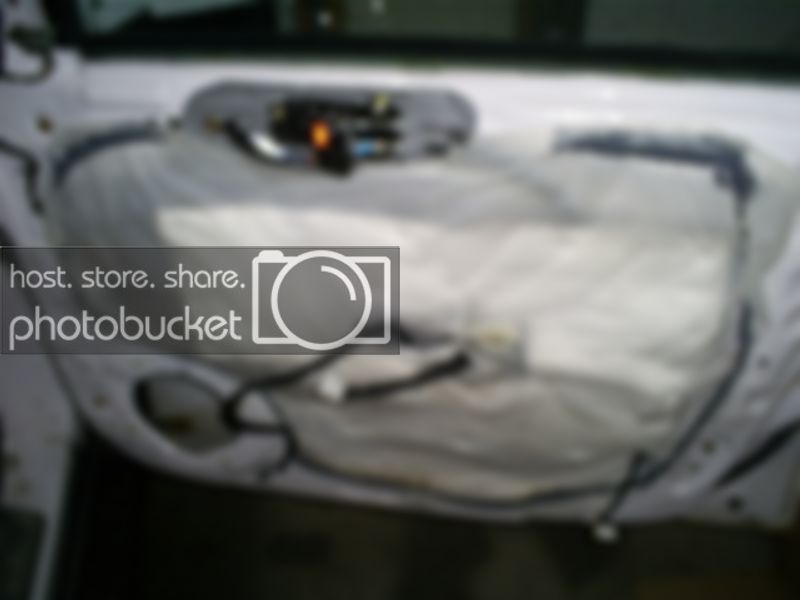

As you can see there were Oz audio mids in the midbass locations mounted with plastic bucket lids, LOL. Plastican ftl. There's one pic were you can see a huge air gap between the bucket lid and the stock plastic mount.

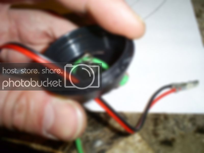

There "were" pioneer tweeters in the stock locations but I blew them when I though they were a component set with the midbasses(before I got the doors off) and accidently bridged them to the kicker and sent them a full range signal,opps.//content.invisioncic.com/y282845/emoticons/crap.gif.7f4dd41e3e9b23fbd170a1ee6f65cecc.gif

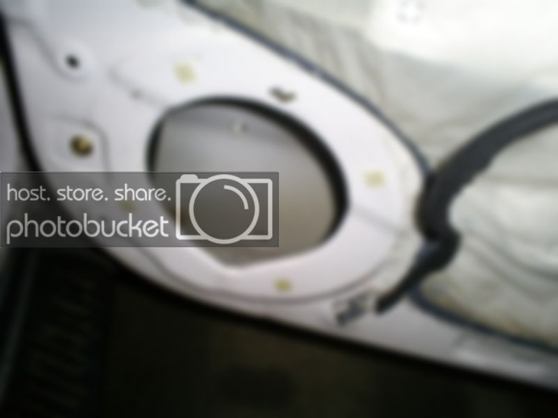

I should have just taken the doors off right away(which took all of 10 minutes when I finally did, because someone had already broken most of the clips that held them on) and I would have avoided that. I don't normally deal with other peoples installs other than replacing or installing new stuff and this has been a learning experience,no doubt.

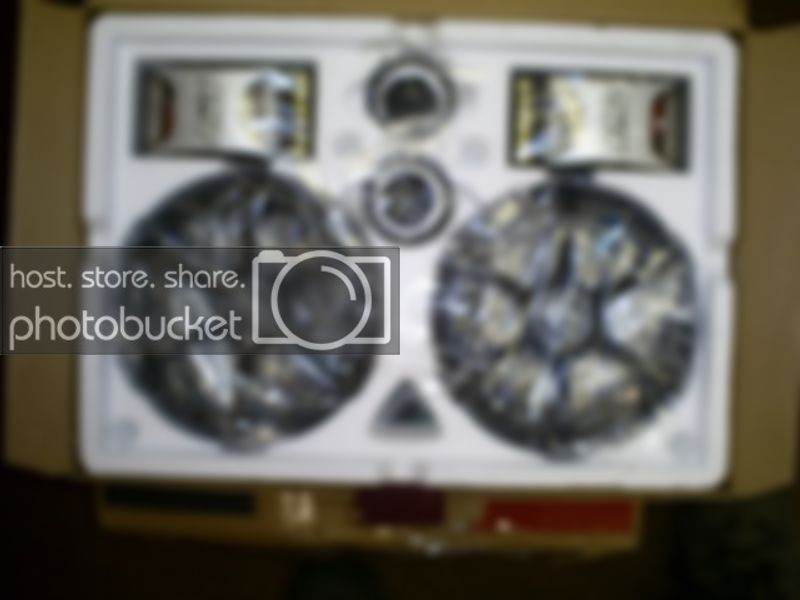

So now I will be installing a set of the newest forum boner, Phoenix gold rsd 6.5's. We are going to try it with just mdf rings and only deadening on the rings between the door/ring and ring/speaker because I just don't want to get into properly deadening someone else's car as I don't have the time. I'll post more pics when the rsds are installed.

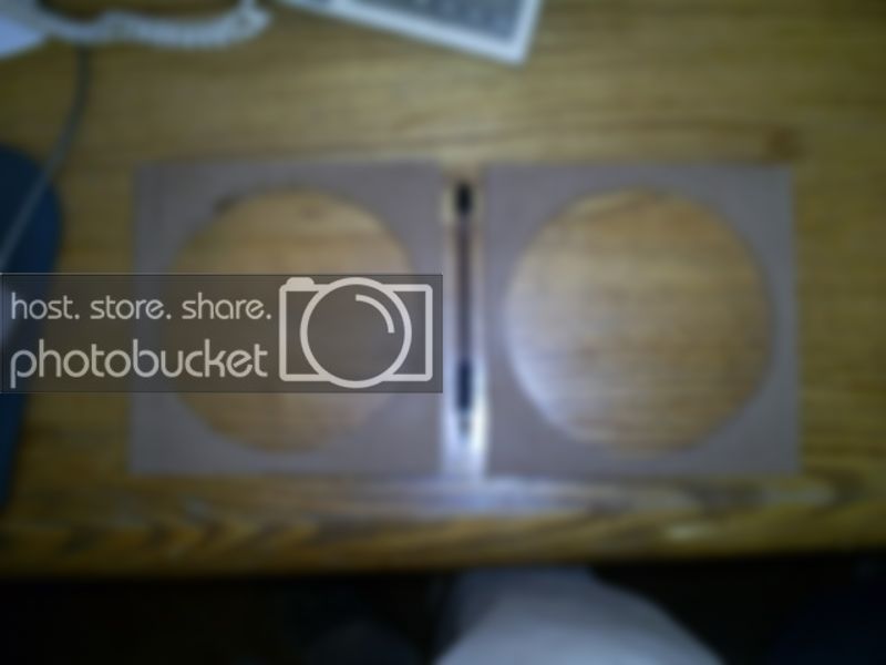

Mdf mounting rings are made.

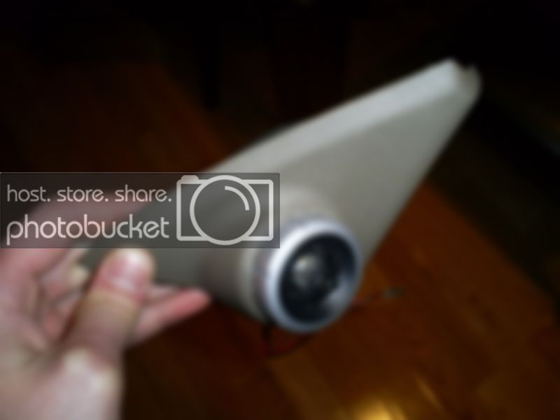

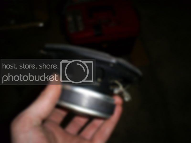

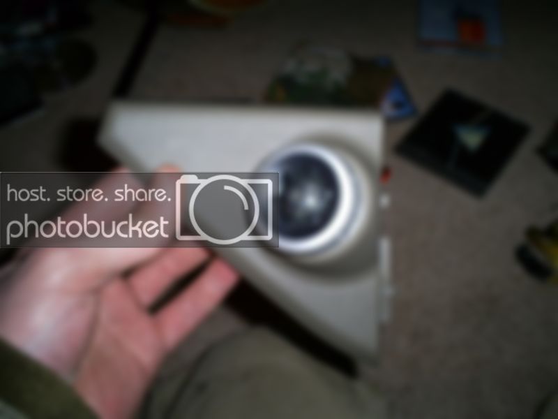

Tweeters are mounted to the sail panels and ready to be connected.
It took me a while to figure it out, but there are springs in the backs of the mounting cups that allow the tweeter to swivel. At first I though it was part of the voice coil before I got it out of the cup.

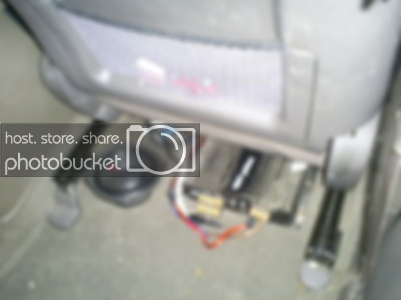

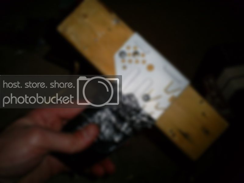

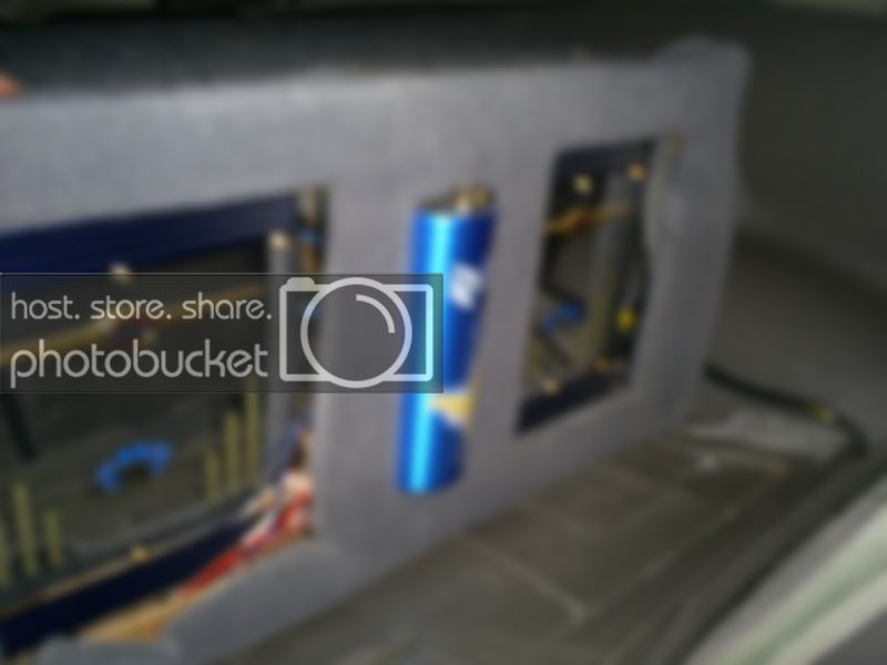

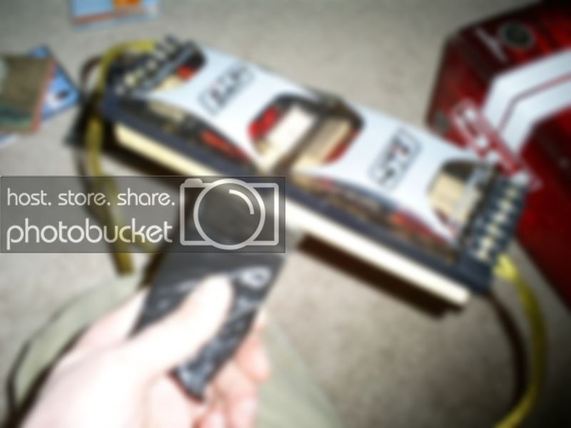

I built this little thing to hold the crossovers under the seat next to the amp. The black thing sticking out of the side is a piece of a h/u mounting bracket wrapped up in duct tape and screwed to the underside of the wood. This will slide in between the amp and the carpet to hold the crossovers in place.
