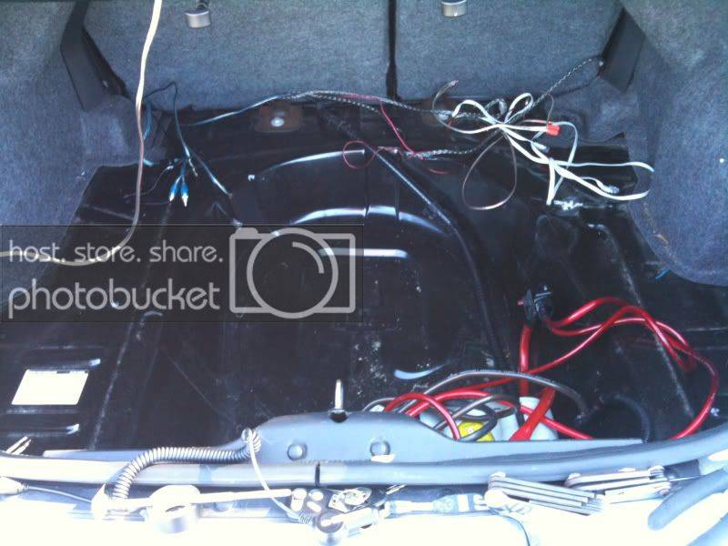

What's in your trunk?

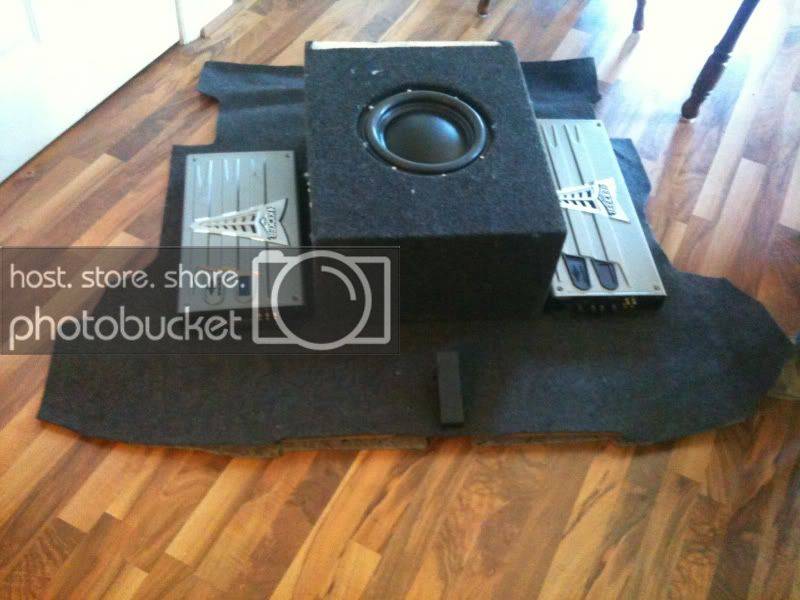

heres the trunk
heres the layout on the trunk carpet!!

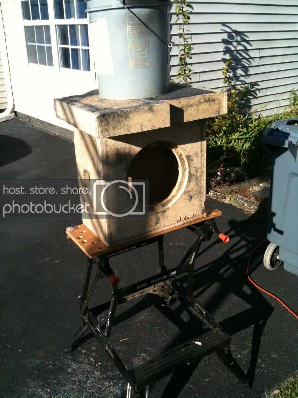

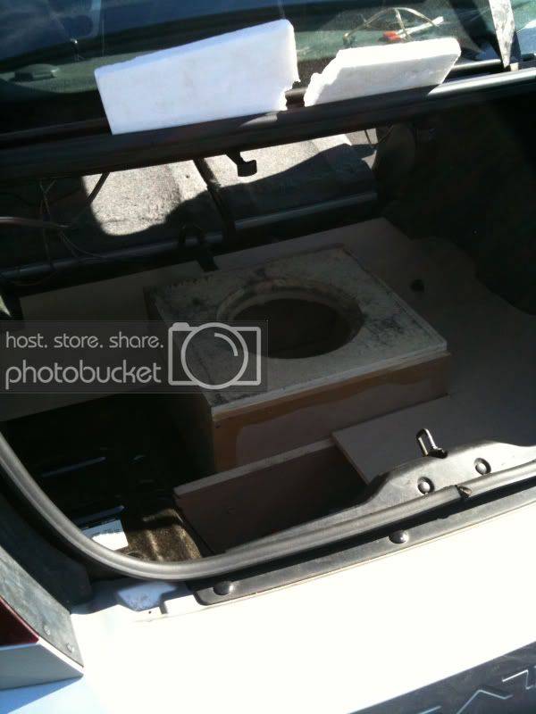

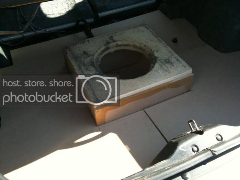

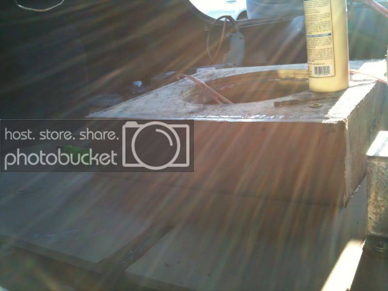

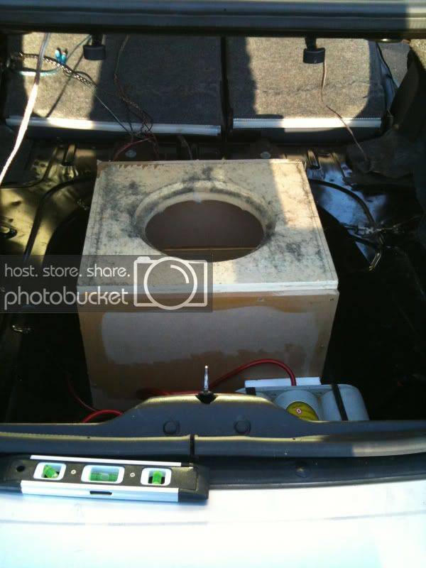

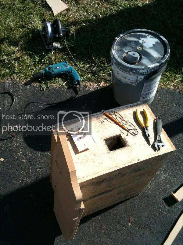

ok i know its kinda ghetto but instead of building a new box I modified my existing box (1.6cuft cut down to 1.2cuft)

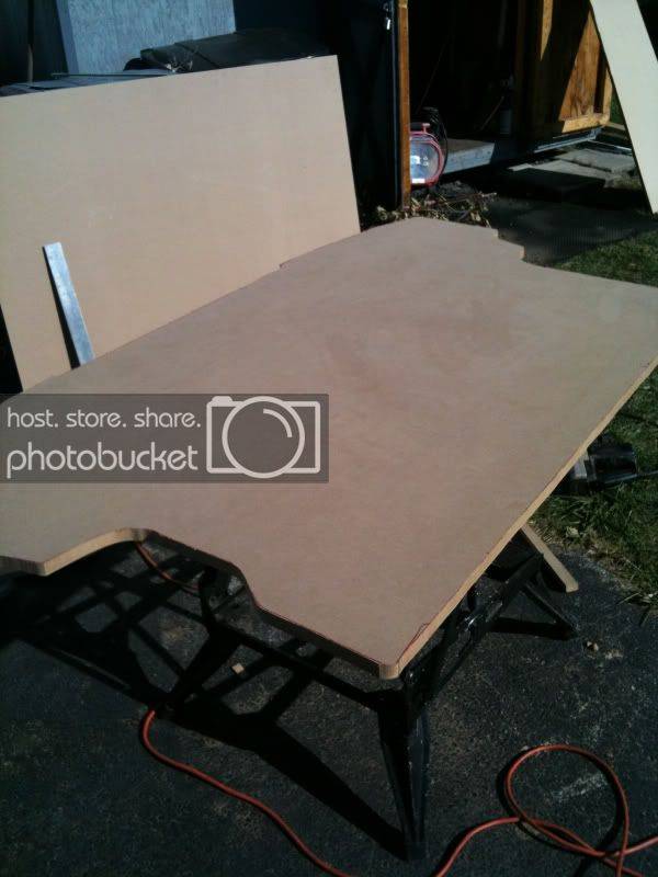

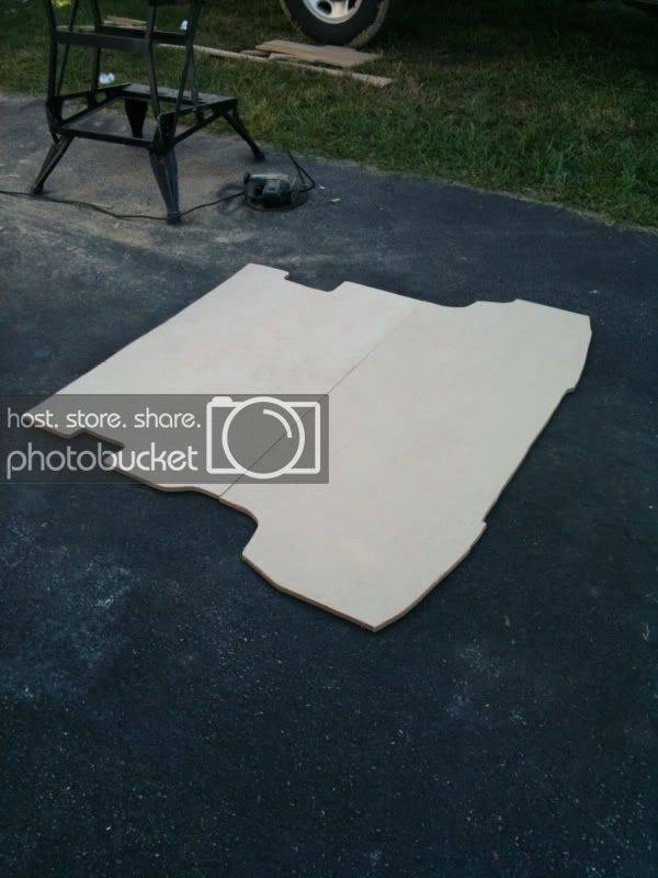

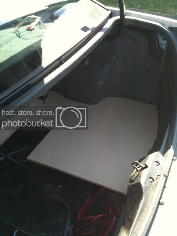

OK next heres the bottom layer of 1/2 mdf that is the bottom floor

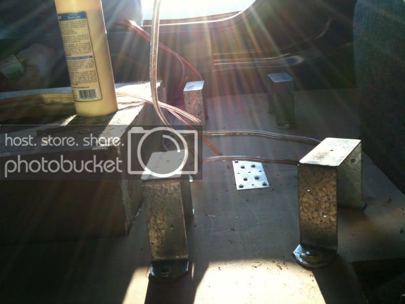

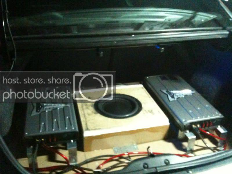

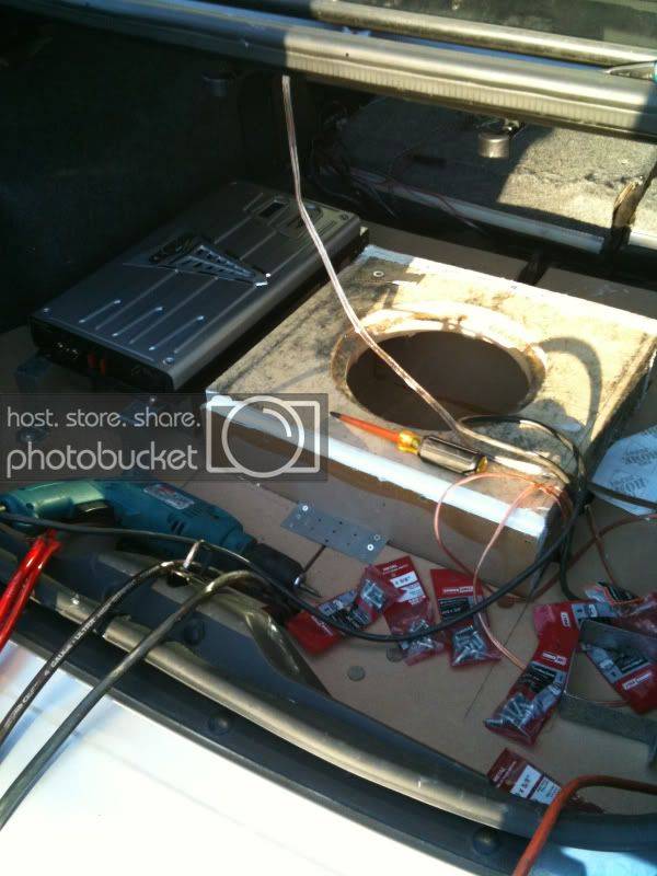

Now the mounting of the amplifiers, the box was sticking up out of the hole 3 inches, so while at homedepot getting the 3/4 mdf i was checking out different boards to find one that was 3 inches and i found these
they are used for building decks but were perfect for what i wanted to do

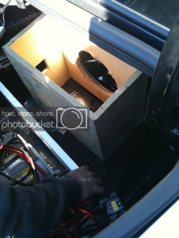

showing the cut out made for the main power wire tht travels the length of the car to the trunk where the battery is located

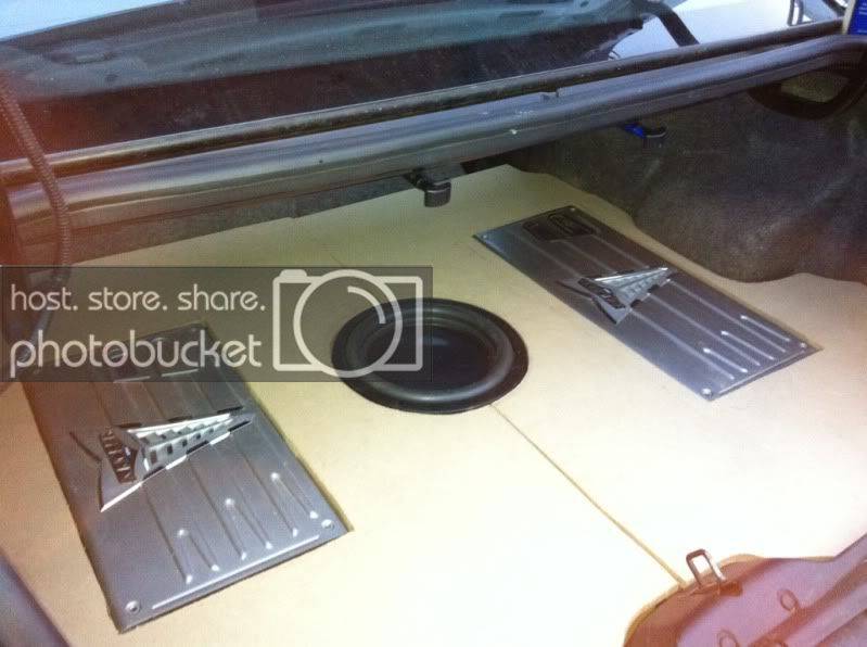

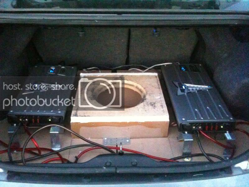

ok these is where I am at currently

dude wicked clean build, saw your other post about the fabric good luck on that man. btw how are you doing the beauty board? are you gona cut it so the amps and sub will stick out? i think thatd look sweet.
they are going to be flush so all you see is the sub and the tops of the amps should be getting the beauty board cut tomorrow morning for a test fit and im still looking for the fabric got a few leads nothing solid yet. Also thank you this is my first build and im extremely happy with it so far!!!!
