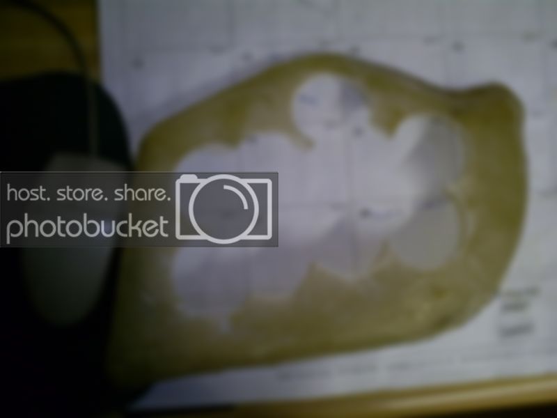

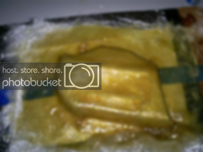

started off with some cardboard, tape and my old stock grills to build a frame to glass over. they needed some reinforcement with wodden dowels and hot glue.

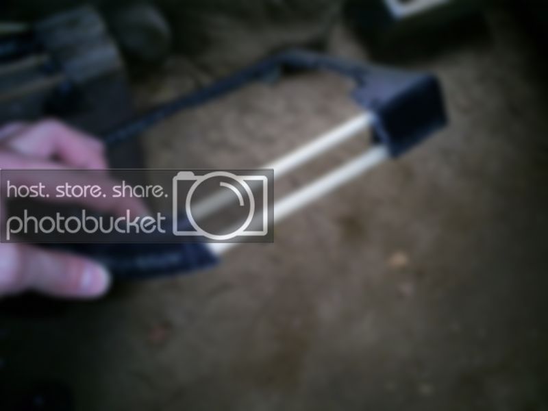

I had cut the bottom of this grill out to try and make it fit stock so it needed reinforcement with more hot glue and dowels.

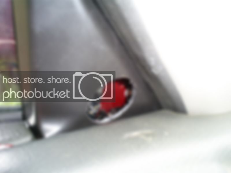

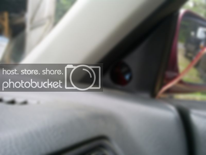

I kind of botched the tweeter mounting on the driver side..you can't really tell in the pic without the tweeter installed but it's slightly below the dash with the door shut, so I have to go to the junk yard and get another one. oh well live and learn.

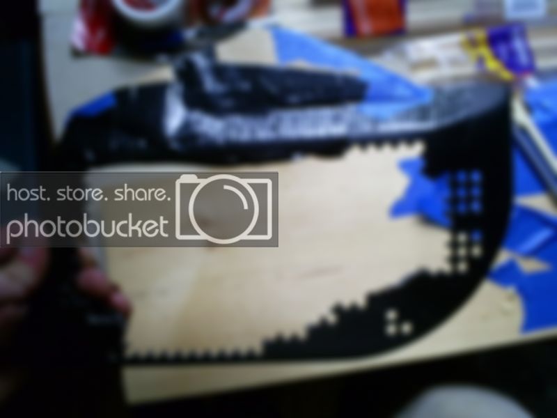

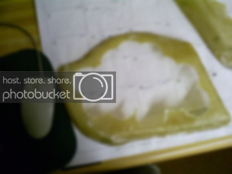

These are the grills after tinfoil and fiberglass...waiting for them to dry right now...I don't care about the indent in the middle of the grille as I will be cutting it out to let the sound through anways.
Hopefully all goes well and I can cut them out and wrap them in fabric and mount them to the door tomorrow...

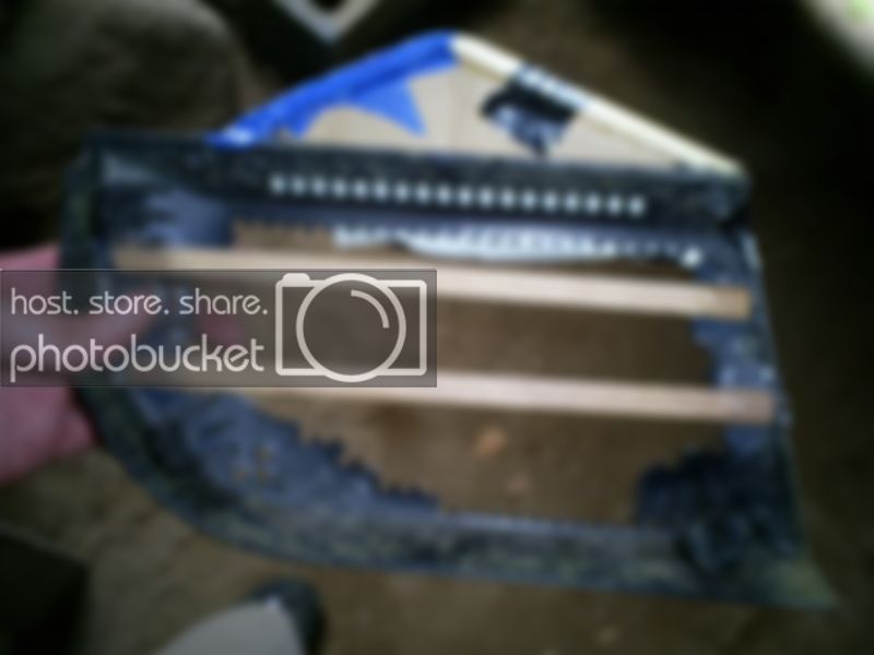

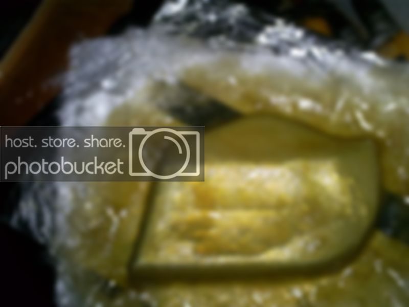

Got the grills cut out of the mold. Was a total pain in the *** because I'm at work and the best thing I could find to cut with was a hack saw and a hole saw...and I was a cheap *** and didn't buy a respirator so I was trying to hold my breath and that just didn't work out too well lol...but I do have a bench grinder here which helped a ton with fitting them tight to the door...I think if I had to do this again I would make a mold of the old grill with tin foil and then fiberglass that because the grills I made were slightly larger that the old ones since I layed the mat on top of the old one. Hope that makes sense because it's a tough concept to explain without seeing it first hand...anyway here are a few more pics...I still need to jig saw the rough edges on the inside but I have to wait till I get home...then wrap in fabric...then glue the pegs on to hold the grill to the door...uggg it never ends.//content.invisioncic.com/y282845/emoticons/crazy.gif.c13912c32de98515d3142759a824dae7.gif Oh yeah btw, I bought all my glassing supplies at walmart....I think it's fine for something like this but I can see how better materials would make a difference if you were worried about strength issues like when building a box.
