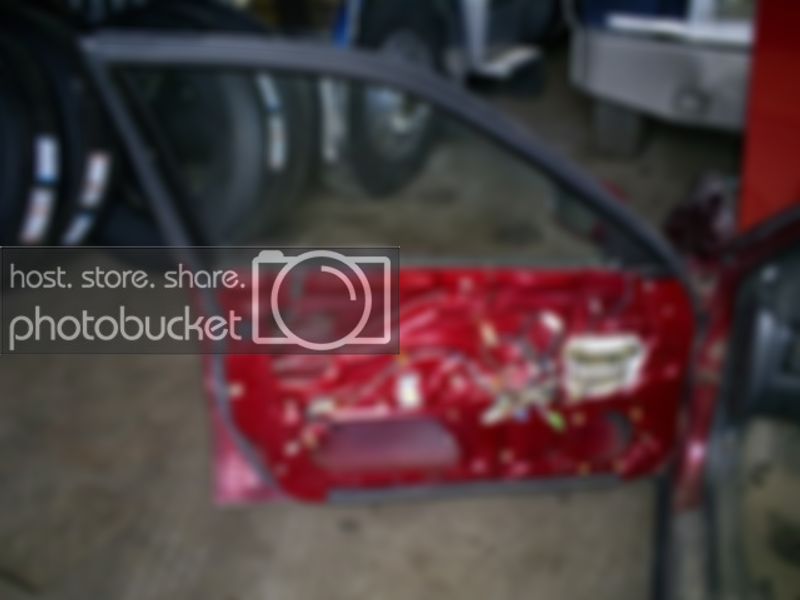

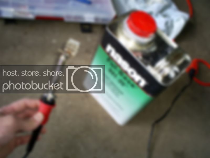

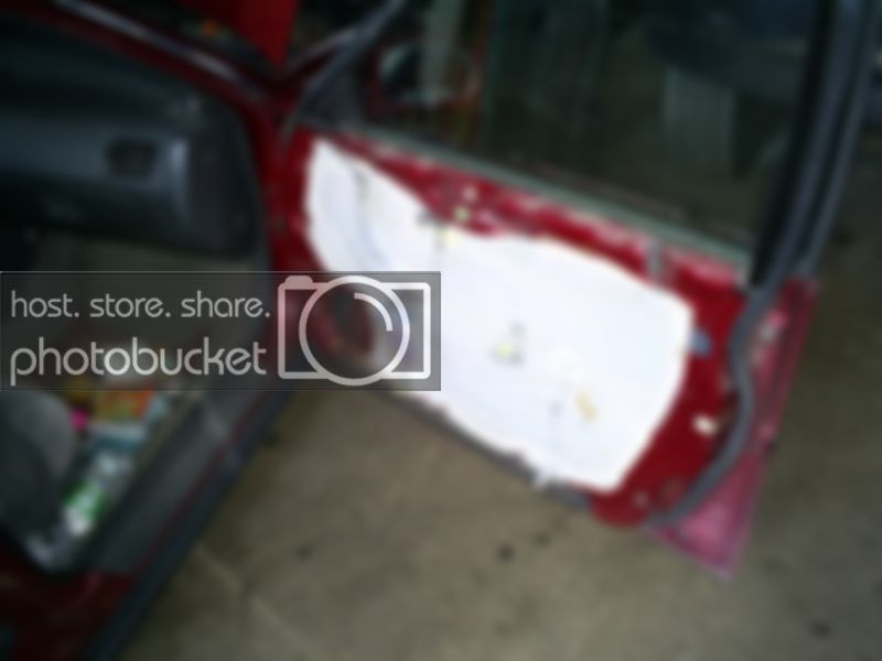

I used a hot razor and some industrial strength paint thinner to take the gum off the door...

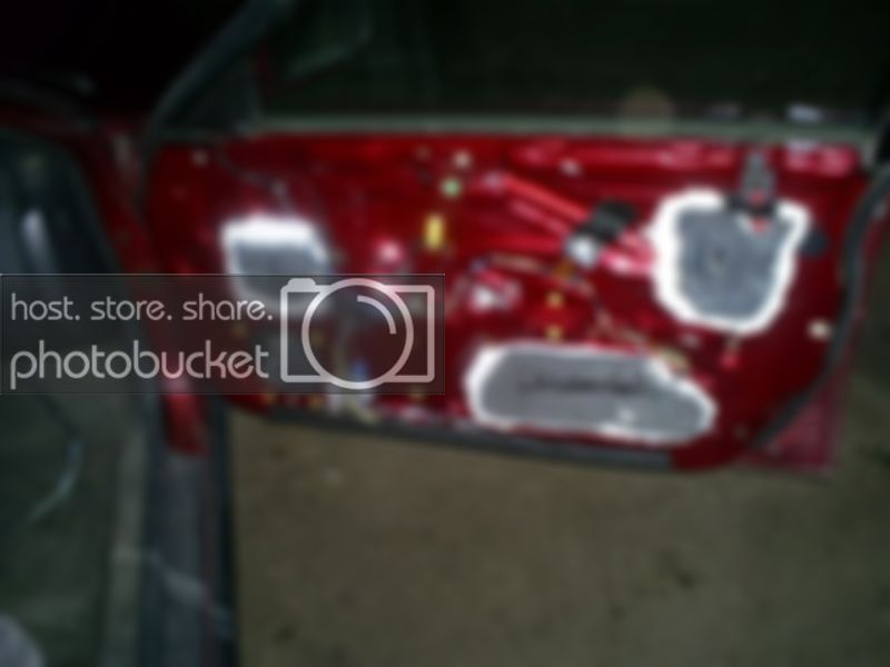

Driver side door cleaned and ready to go...
Still have to do the passenger side...

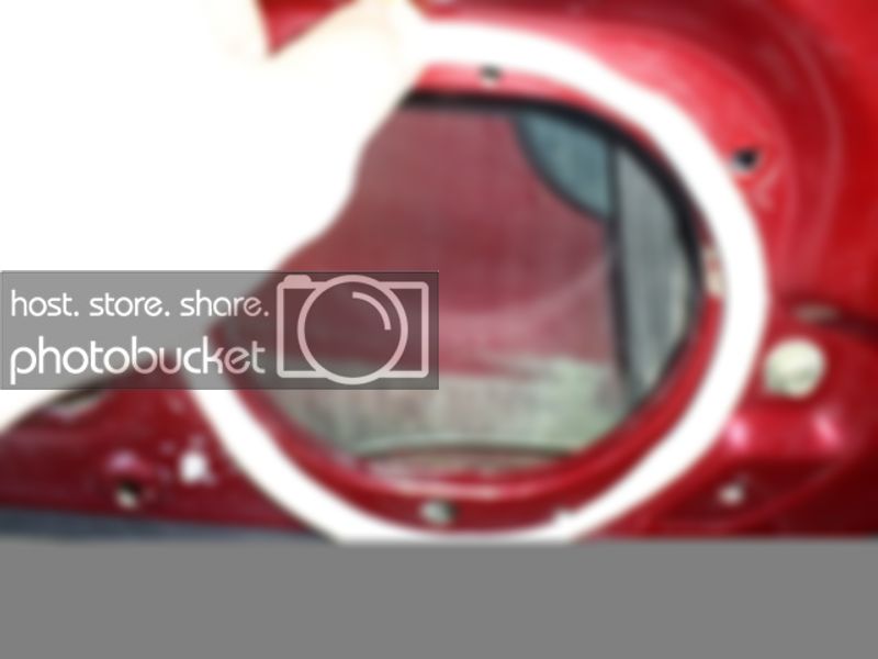

This is a paper template I made to make the mdf mounting rings...
A shot of the mid and mdf mounting ring...wish I had something other than a cheapo jig saw...would make my cuts a lot more even.

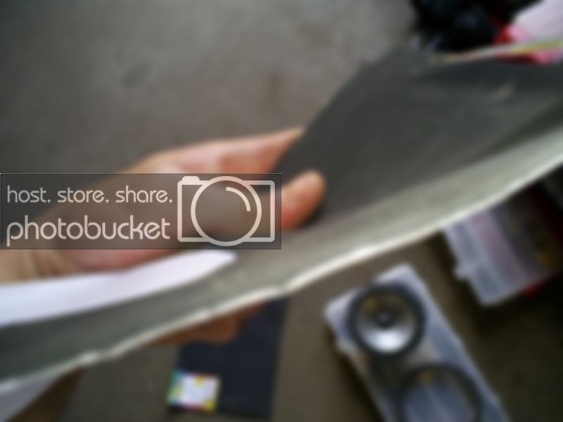

This is some stuff I get at walmart in the craft dept....good for temp install and making cheap speaker gaskets.

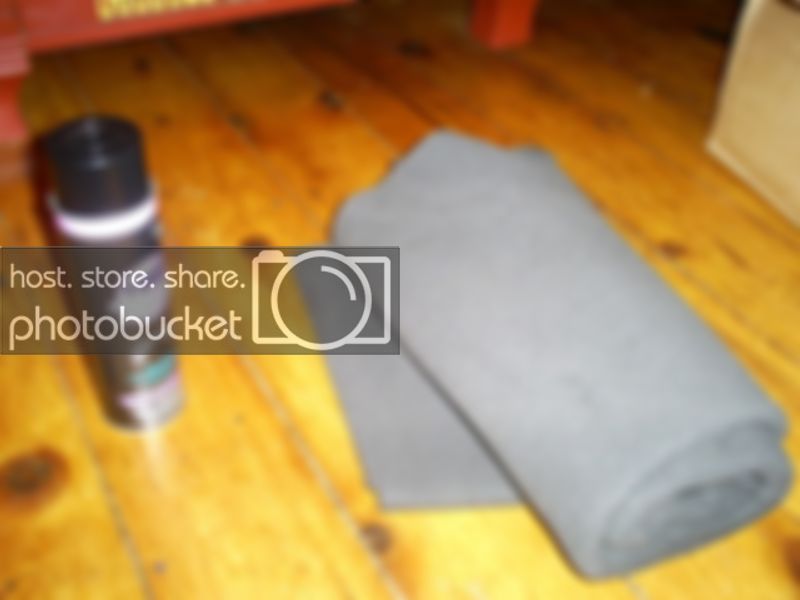

But....there was also some other things in the box...I'm pretty sure they were free,there was no note or anything, courtesy of Rick, owner of raamaudio.
//content.invisioncic.com/y282845/emoticons/yumyum.gif.0556df42231b304b9c995aefd13928a8.gif
Free ensolite and spray adhesive!

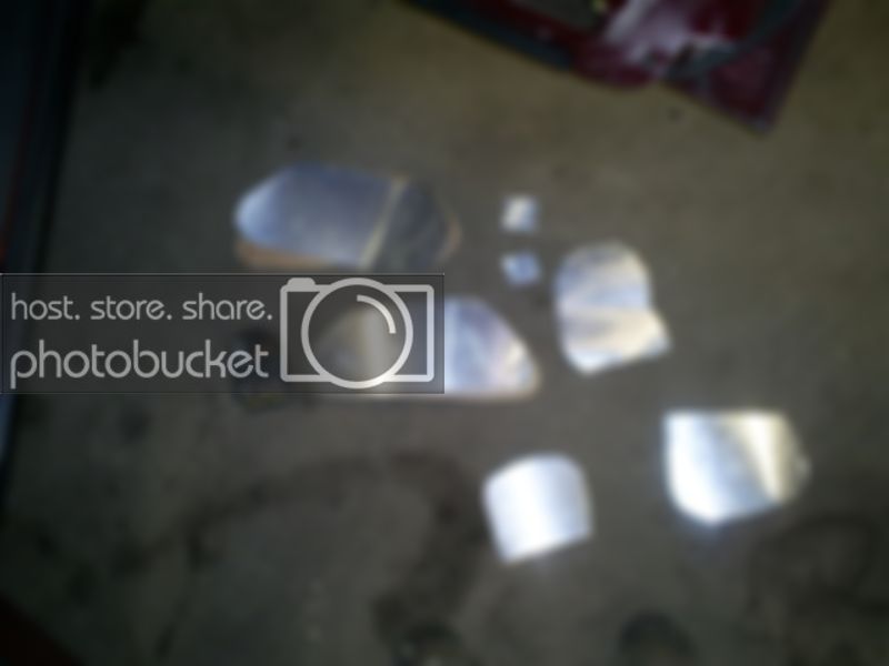

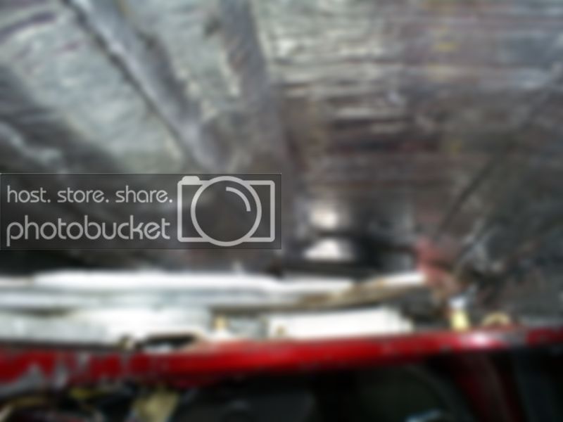

Well I am making progress but this is a serious pain in the *** and is also very time consuming...I've spent at least 5 solid hours and I think I'm about half way done...and the glue will not come off my hands....I could use paint thinner but i've had so much on my hands lastly that I don't care to use anymore.

Thanks...I hadn't gotten much response before this I think because I post at odd times when there is not a lot of site traffic....yeah I used a lot of large pieces which I slid in through the gap between the window and the top of the door...also I had a drumstick which helped alot in pushing the deadener into the gaps and channels..and yeah beer is a BIG part of this type of work...my stomach can attest to that this morning //content.invisioncic.com/y282845/emoticons/crap.gif.7f4dd41e3e9b23fbd170a1ee6f65cecc.gif I've been driving around for a week or so with the door panels flapping around in the back seat...I hope this project comes out good because fawk, this is a lot of work and expense...
