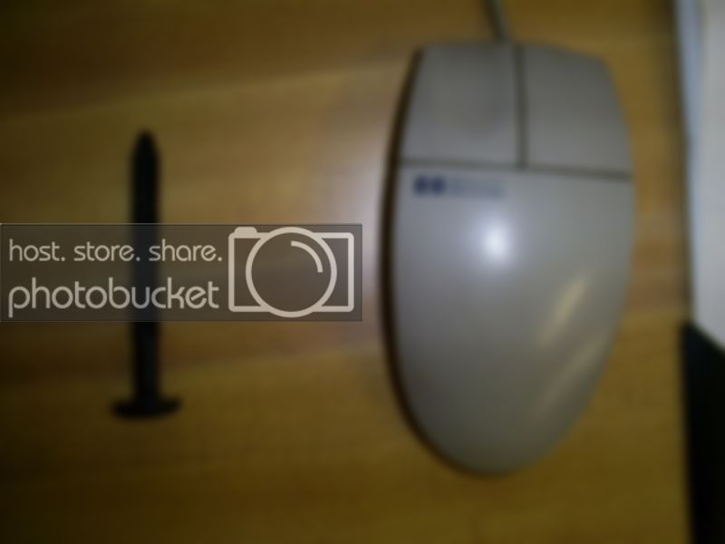

Ok I think I might have something that will help me....these are window shutter clips that hold your shutters on your house...I've used them before to hold grills on because they fuit snugly in the holes that are in the door but you can pull them out so the grill will come off without removing the door...I had previously modded the stock grills when I had different speakers in the doors to do this, but I don't think they will work in this situation so I am still in need of some type of frame thing to stretch the cloth over.

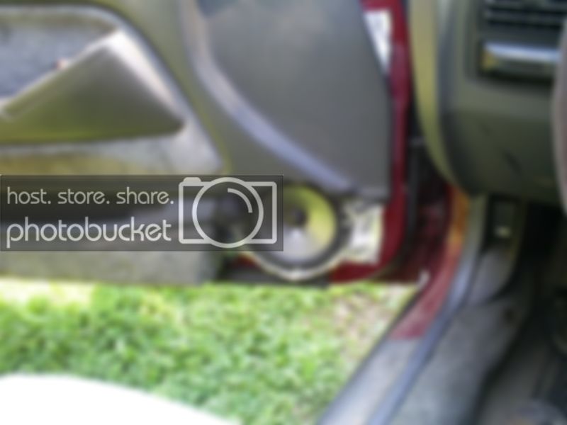

Well it still needs alot of cosmetic doctoring but my install is finally to the point that I can listen to it...all I can say about deadening is DO IT if your thinking about it....holy previously unheard midbass...it already sounds alot better than my old set up and I'm not done tweaking it yet, going to put the tweeters on a long wire and move them around to center the imaging.

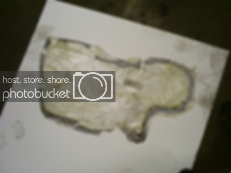

I saved the plastic moisture barrier to use as a template

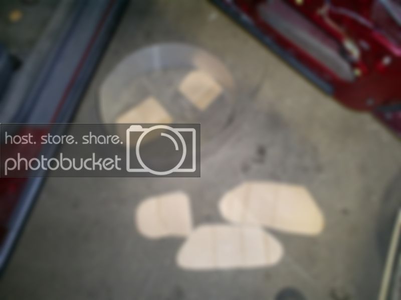

I also made templates for the tin plates by stuffing cardboard in the doors and tracing it with a magic marker.

Are you mounting your tweeters down by the mid? If so I'd put them up higher for sure...
Yeah I just have them mounted low for the time being...going to put them on long wires and see where they sound best. I used to have them in the a pillar and I think they will end up back there because they are not even close to loud enough being mounted in the doors
