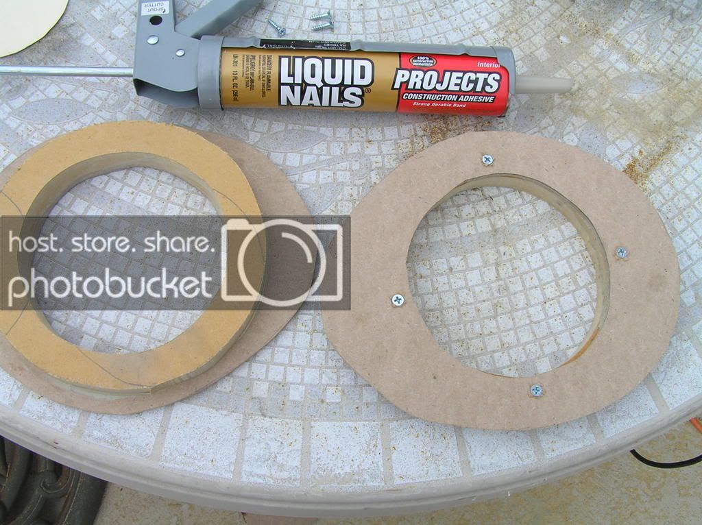

What is the point of building the baffel? I'm new to all this stuff and see a lot of guys doing it. Is it for sound quality purposes or what?
Using baffles is 2 fold for me. I needed to space out my speaker since my aftermarket speakers are much deeper than the stock speakers were. Next, speakers mounted straight to metal is not a good idea. Metal on metal is usually never a good thing. So to help absorb the vibrations many people use a baffle made out of some composite, fiberglass or for us cheap skates we use MDF.

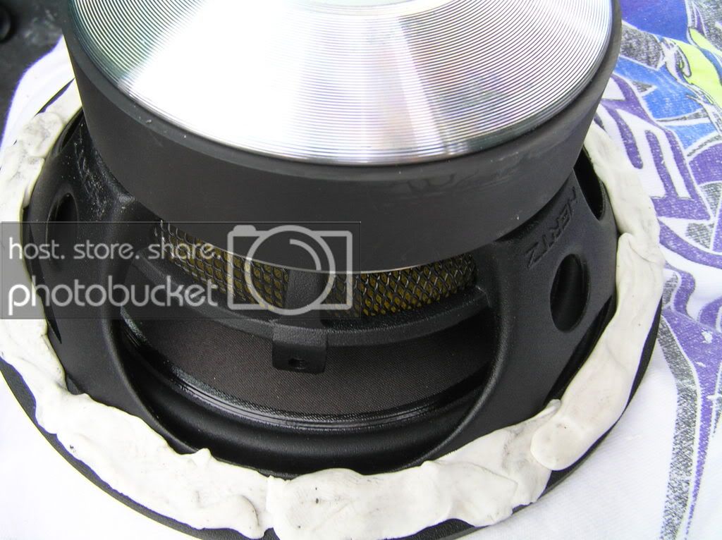

A good solution, if you're putting 2 pieces of MDF together, would be to glue a few sheets of sheet metal or alumium between them to increase the mass and aid in blocking the back wave. You could also pack it in wax-based modeling clay to add mass and rigidy to it.

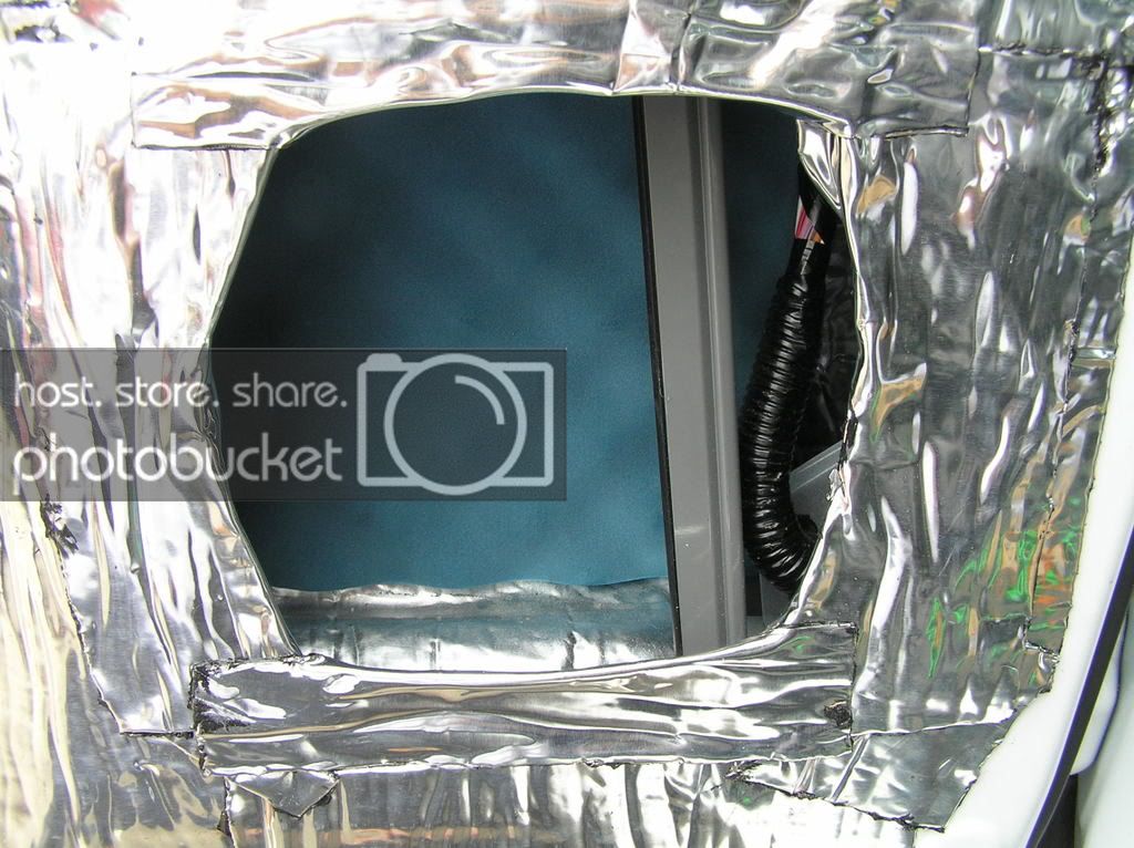

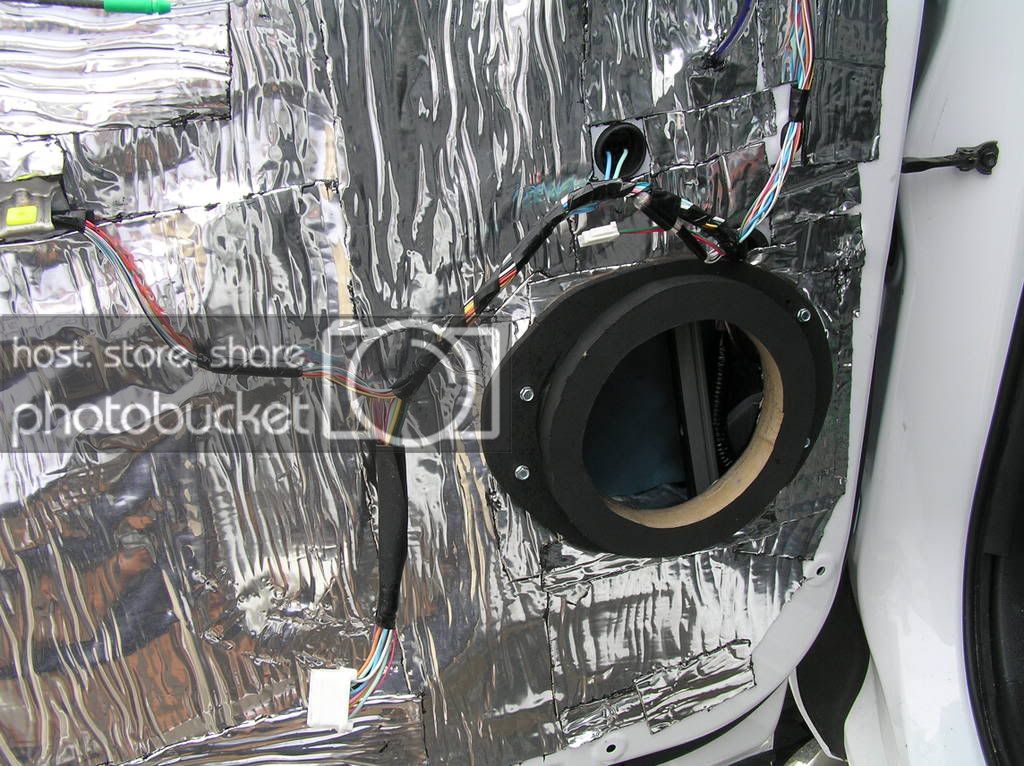

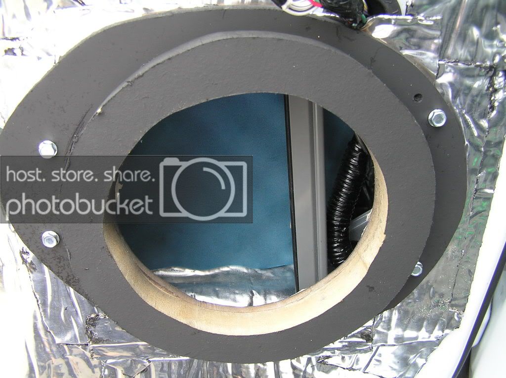

I decided to continue the build this Sat. and build some baffles that will cover the stock 5 x 7 hole. Then I will know that I have done my best to totally enclose the door and deaden it.
Simek4Life: Please read entire thread before commenting.... I already stated on an earlier post that I had made the spacers months ago and now I want to enclose the area as well as I can so I am remaking baffles this Sat..
Build complete. Let me know what you think!
I love them! The mid bass far out performs my expectation and I listen to Sirius 90% of the time and the sound quality is at 64 kps which is quite low compared to a CD but it still sounds off the hook!
