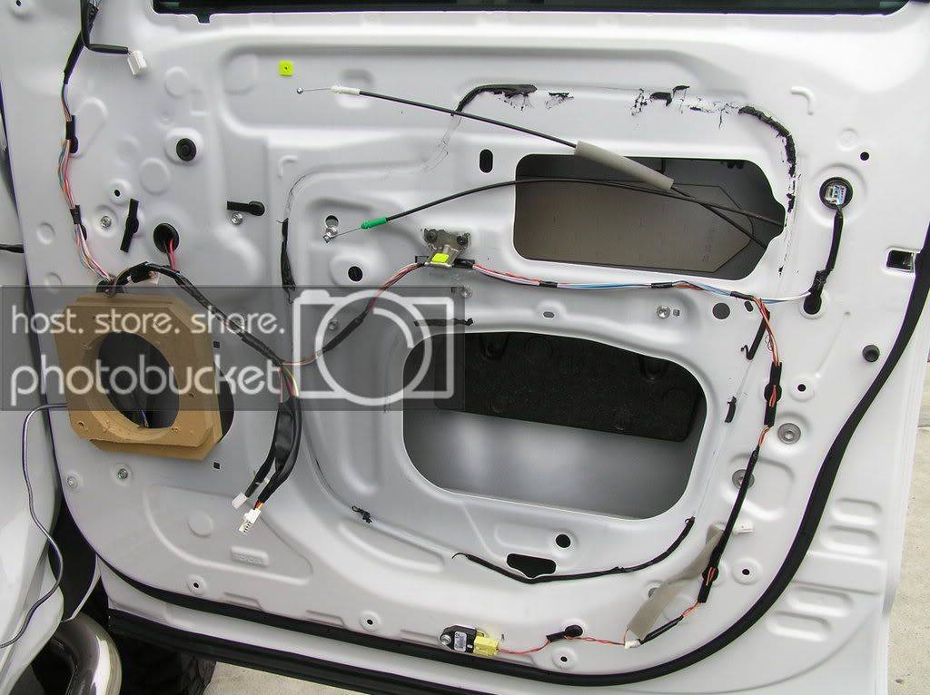

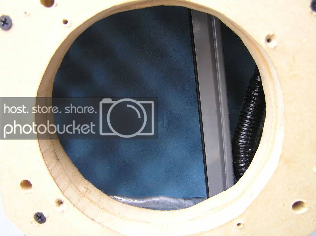

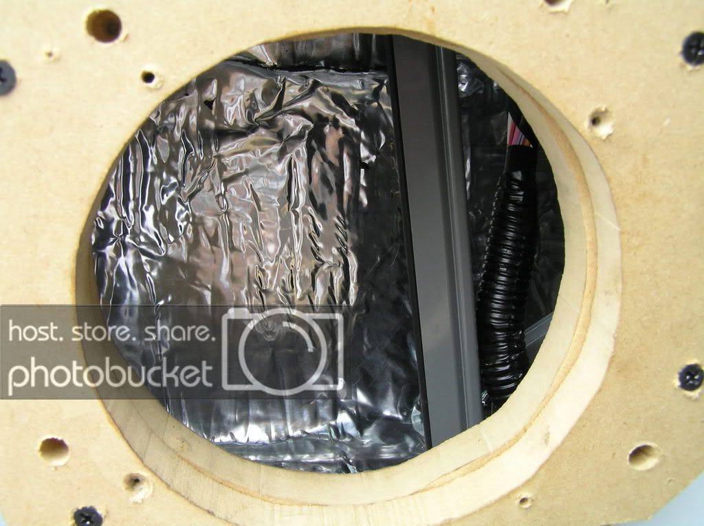

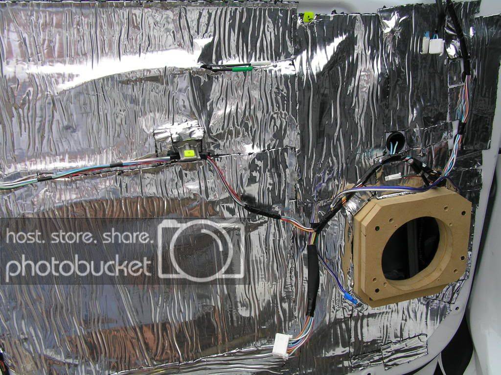

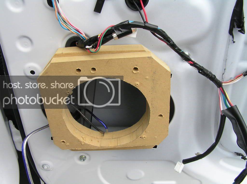

I bought a set of Hertz Mlk comps and I needed to add another 3/4 inch mdf spacer. Then I added Raamat to the inside of the doors as much as I could. Then I added the egg crate backing. Then I deadened the door as much as I could. I am waiting and should recieve the comps Tuesday. Here is the build so far.....

My roommate has them and I've had plenty of ear time with them //content.invisioncic.com/y282845/emoticons/smile.gif.1ebc41e1811405b213edfc4622c41e27.gif. Make sure your door doesnt get water in them becauase those MDF rings will expand, mold, and crack... I prefer using birch or those thick plastic mats.

question did you cover up the huge openings in the door before you put deadener over them?
Word... You should use thin birch, or sheet metal to cover it.... Some don't which is fine but you can even use cardboard and cover both sides with deader.

This is not a perfect build as I have only a carport and very limited space to work. I did what I could to help the speakers perform better. I had to cut a few corners but I wont have any rattles and the doors is sealed up pretty well. Thx for everyones input!
I almost went with the HSK's but I dont want to do this again for a long while so I bit the bullet and bought the higher line MLK's. Hopefully it will be worth it!
