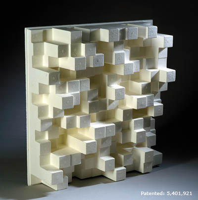

deflex pads are near usless because they are too thin/small. diffusion could be achieved behind the speaker with varying depths of 2x2 and 1x1 blocks glued together to form something like this (RPG Skyline):
^ that is an example of diffusion. quite a bit more substantial than a deflex pad...
i will experiment with this concept in some future builds.
yep. and it's worse because it's not immediate but a combination of reverberant sound inside the door. the speaker cone moves air but has little transmission loss so it doesn't block sound either. good speaker designs address this by minimizing the amount of sound that makes it back to the cone.
Wow thats some interesting info man. Are the placement of these protruding and recessed blocks in this diffusion device engineered in a certain way or are they random?
Computer generated for broadband absorption and they work in an array.
But a homemade would be random.
