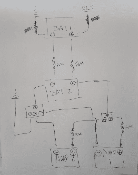

Is the battery in the trunk the primary battery or an additional battery? If it's a 2nd battery, you should have 1/0 gauge wire from the +/- on the front battery to the rear battery, You should then run 1/0 gauge to +/- distribution blocks, one for both the +/- .
I always parallel ground. In your scenario, I would wire as follows:
If the battery in the trunk is the main battery, then just go off what i show here from BAT 2.

It is a secondary battery. I was told I could just use 2 separate fuse holders off the battery instead of a block. My main question is can I use the same ground spot for the 2nd battery and the 2 amps or do I need 3 separate ground areas.
A single sufficient ground is preferable to multiples. Multiples can cause ground loops which are problematic. As illustrated, one frame/chassis ground point up front and a single frame/chassis ground point in the rear not multiples in the rear. You can ground directly back to the battery if it is frame/chassis grounded in the rear already or use a distro as shown.
Do you have parallel runs front to back?
