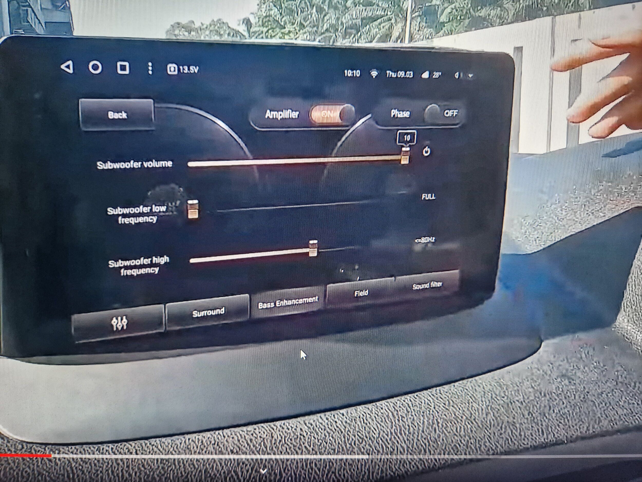

Under EQ settings under Subwoofer there is also an AMP on / off so i assume this if for the Sub. (In photo above)

The Subwoofer has:
Subwoofer Low Frequency and Subwoofer High Frequency aswell as Subwoofer Volume sliders.

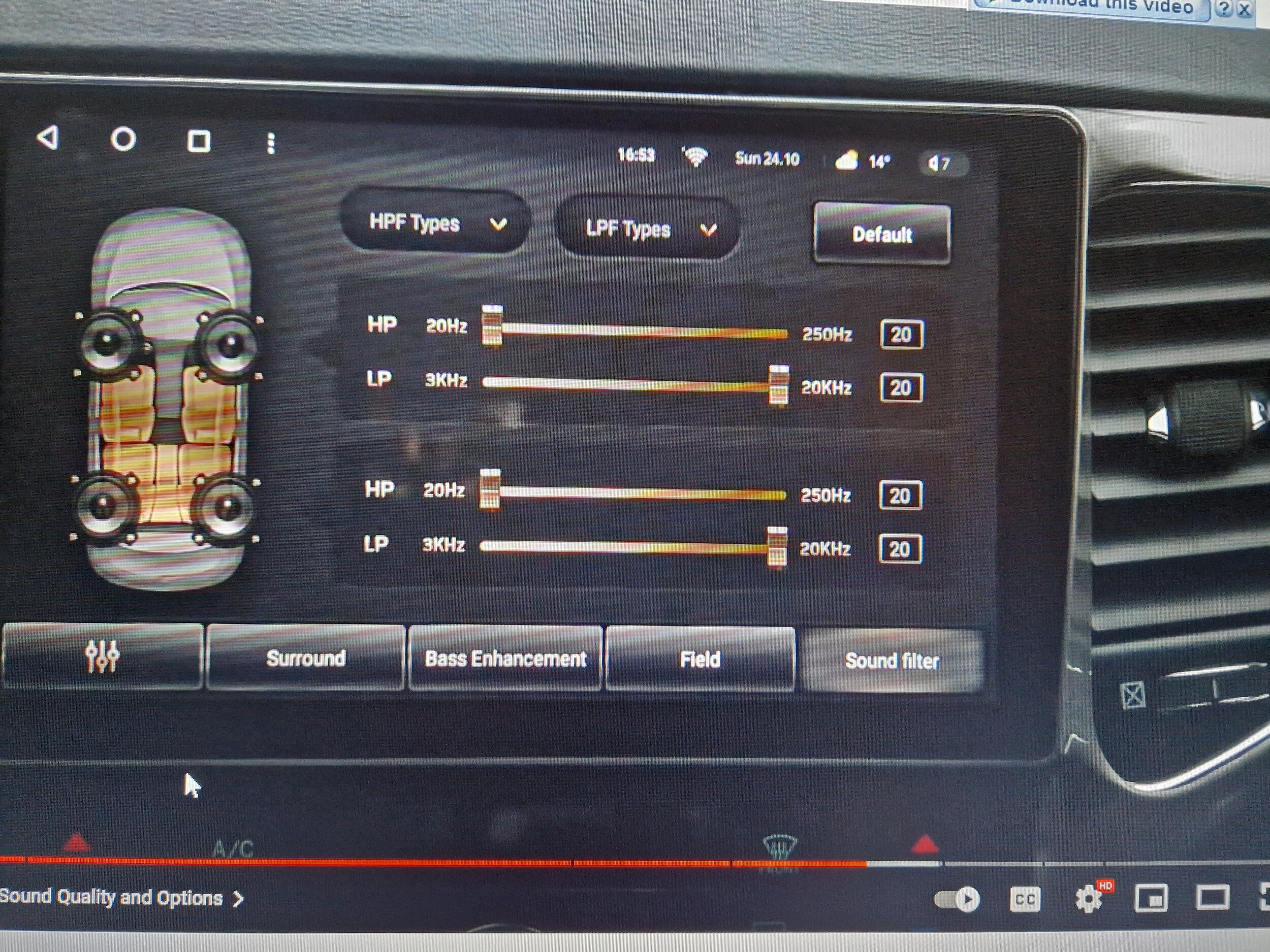

The door speakers have:
HP 20Hz - 250Hz and LP 3Hz - 20Khz.

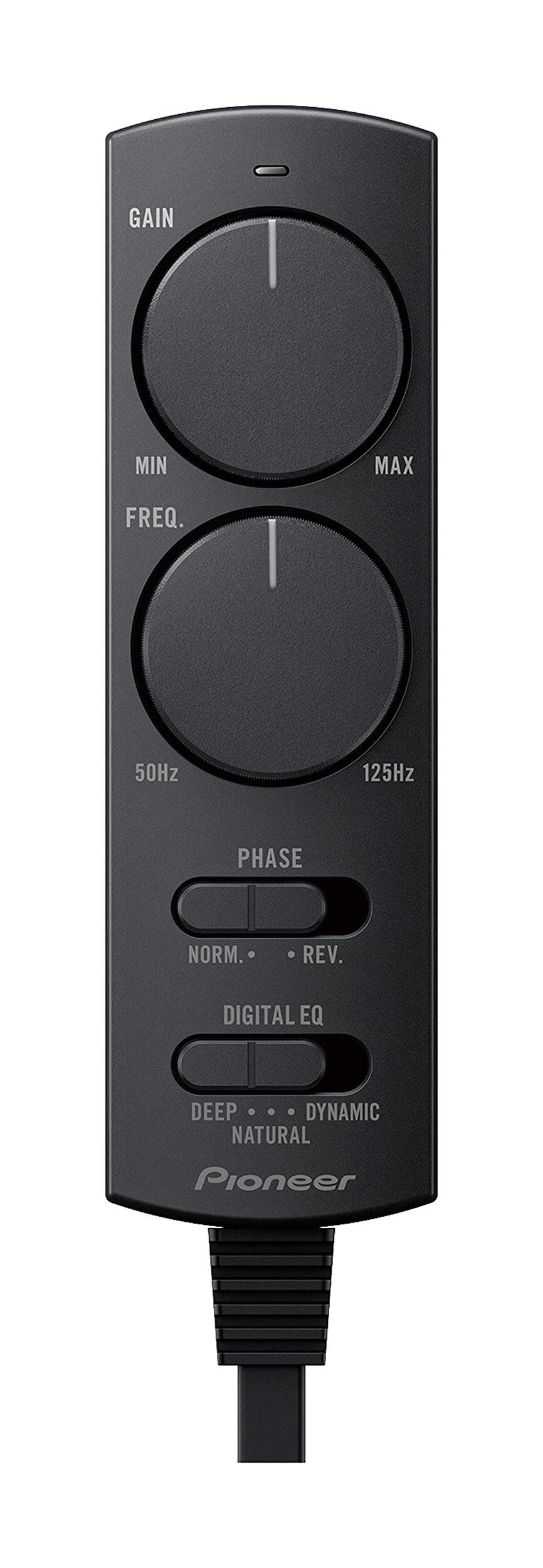

Picture 1. Set the upper slider marked HP to about 75 or 80.
Picture 2. Leave it the way that it is.

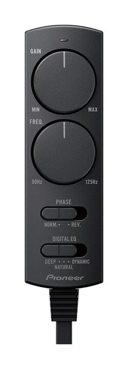

Picture 3. The top knob is the bass volume. Set it where you want it to be. Just set the second knob to 125 and leave it there. The subwoofer settings on the head unit will take care of it. The two switches you will have to listen to the subwoofer and decide what sounds the best.
