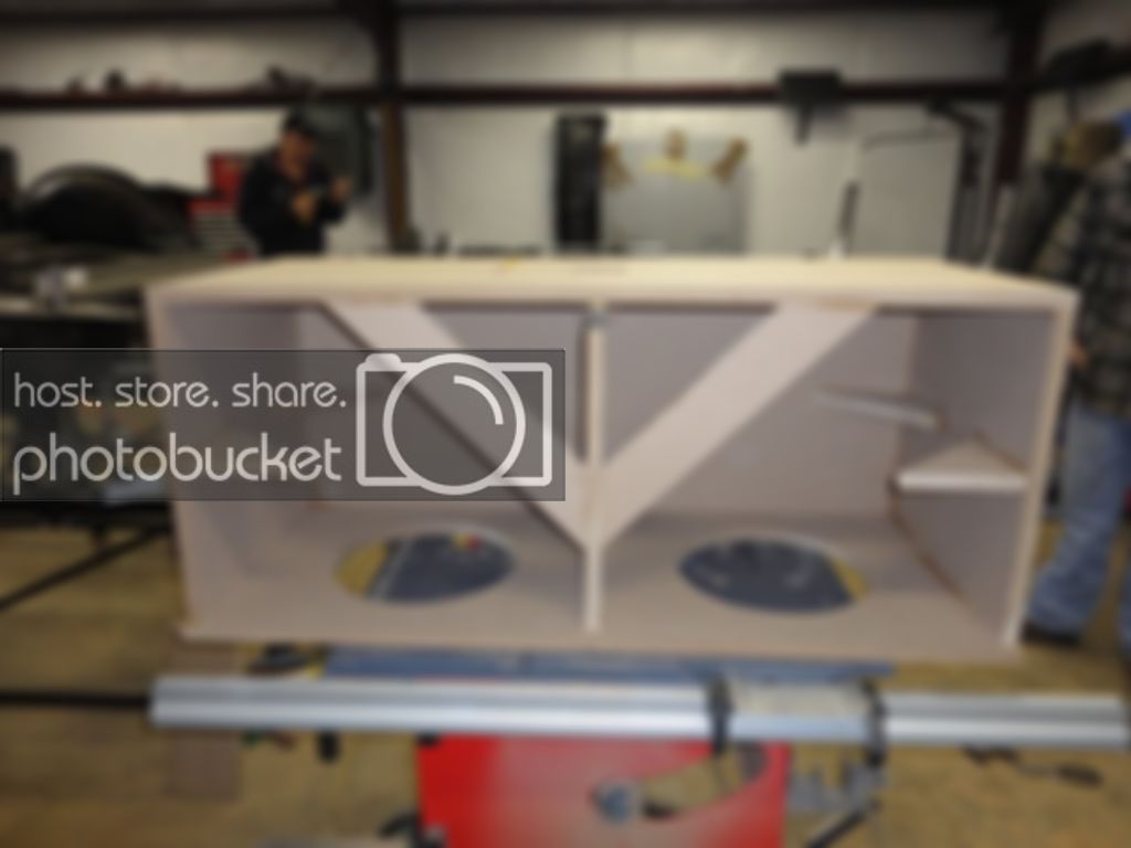

Dont seem to be getting enough, "boom"
getting power at 4 ohms is usually quite expensive, for example my mmats will do 1k at 4 ohms, but they are 1400 bucks new and usually around 600 used.
you can wire your subs to 1 ohm and get the ap or mb quart i suggested and run them with the gains off. that will give you all the power you want.
this is what i would do...
Try wiring the subs up to ur amp @1ohm. I know the amps not 1ohm stable but with box rise and such id be willing to bet you would be alot closer to a 2ohm load then you might think. I had my d4 2510 wired @2ohm but after rise it was more like 2.7ohm. Just a thought worst case amp goes into protect. Go ported ur box is massive which kinda wrks in ur favor since you dont have the needed power.
That's what I would do too... I have the MB Quart DSC1500.1D... Excellent amp for the money!
Heres a pic of the inside. There is a divider in between the two speakers.
that divider ***** things up but if you fire one of these on each side/chamber Amazon.com: Precision Port 3" Flared Port Tube Kit: Electronics that would get it loud, full length would tune you to 30hz and that would pretty much kill the lows. cut them shorter and youll get those notes that lil wayne puts in a mili. I would honestly build another but if you dont want to then you can go my route, and if you dont like it then just build another. Also these ports cannot go inside the box, so youre gonna lose space and it might look goofy. well it will look goofy.
