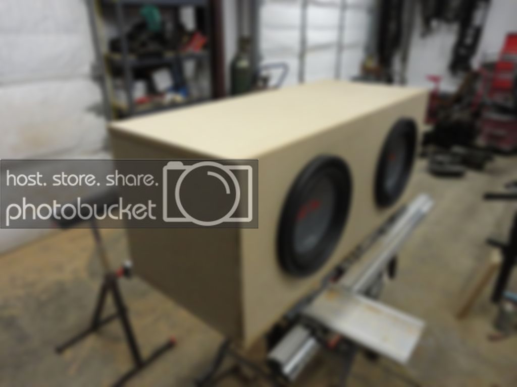

back again. And just wondering why my two alpines type rs 1242(500rms each) arent quite cutting it. I have a 1000 watt Alpine amp, but its running off 4 ohms cause the speakers are 4 ohms and so its only getting 600 or so in each driver. My box is 14x14x42 sealed. What can i do to get more Explosiveness outa these subs. or are they just not built for BOOM....
Model number of your amp? It's a bit hard to take a 1K amp, wire at 4 ohms and get 600watts per driver. R's can get loud, but to start off, they need proper power and a proper box, neither of which you seem to have at the moment.
Well the amp is an alpine M1000, 1000x1 at 2ohms and 675x1 at 4ohms. I got two 1242 Alpines at 500rms. And they box, i attempted to do the math by myself. i looked online and **** to figure out my size
Yeah but theyre acting like there getting over powered and start to distort. When i turn the bass up i have to keep it low else i feel like they will blow up. lol
