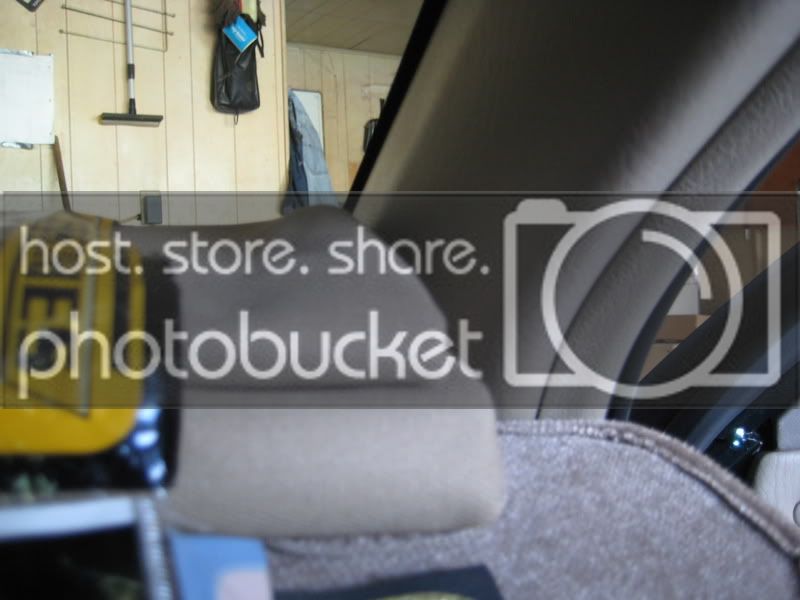

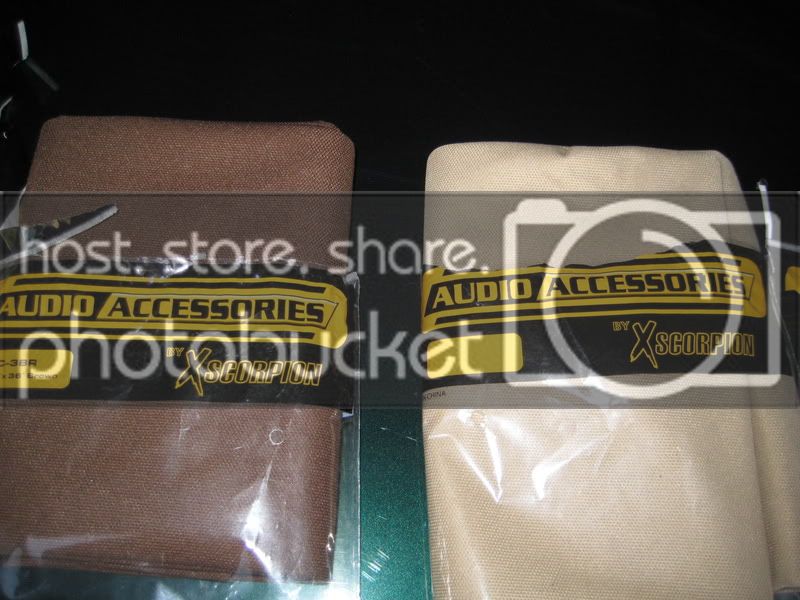

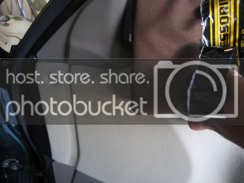

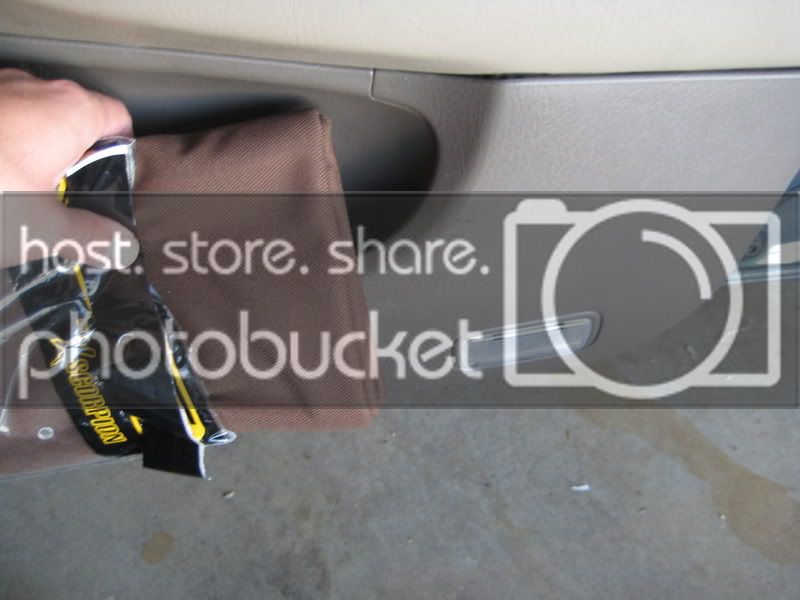

Got the speaker grille cloth for the doors, a pillar and rear deck. The one on the right I got two of for the rear deck and the a pillars, the one on the right for the lower portion of the door panel and even the triangle piece on the door.
The light color is VERY similar to the stock color, good choice //content.invisioncic.com/y282845/emoticons/biggrin.gif.d71a5d36fcbab170f2364c9f2e3946cb.gif
The brown is a bit darker, but it still will look pretty good. You can see the triangle piece in this photo I mentioned earlier. I'll probably cover that so the door doesn't look awkward.

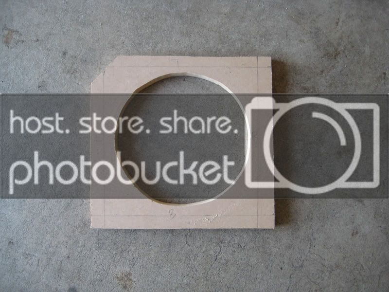

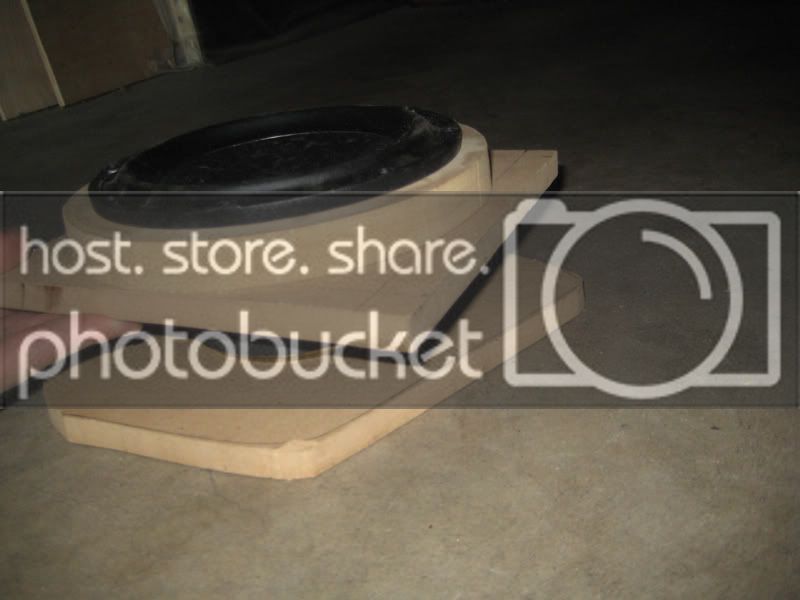

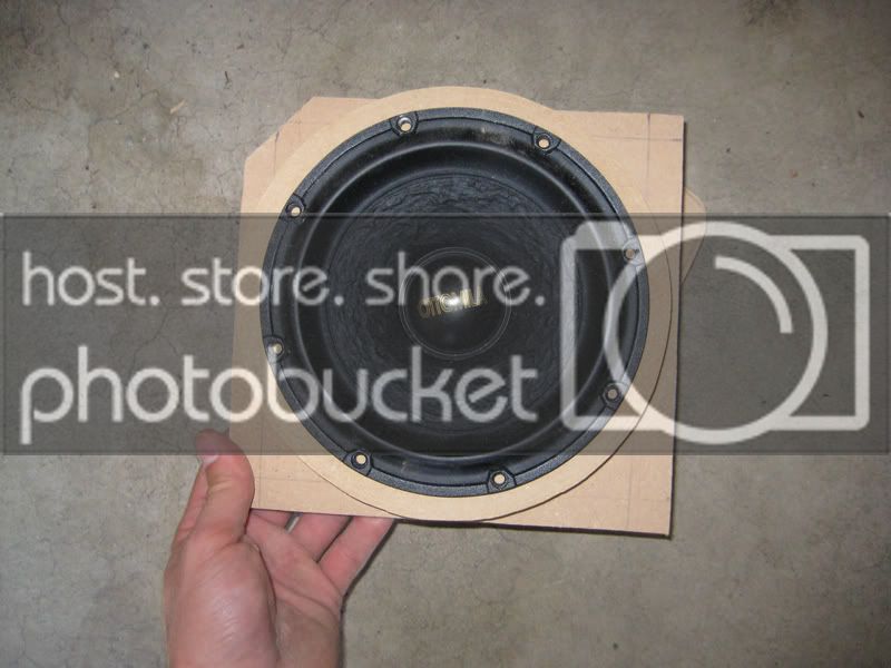

Got done with one baffle, it should work. I decided that the easiest way to do it would be a square, only thing is there is a little hump as you can see.

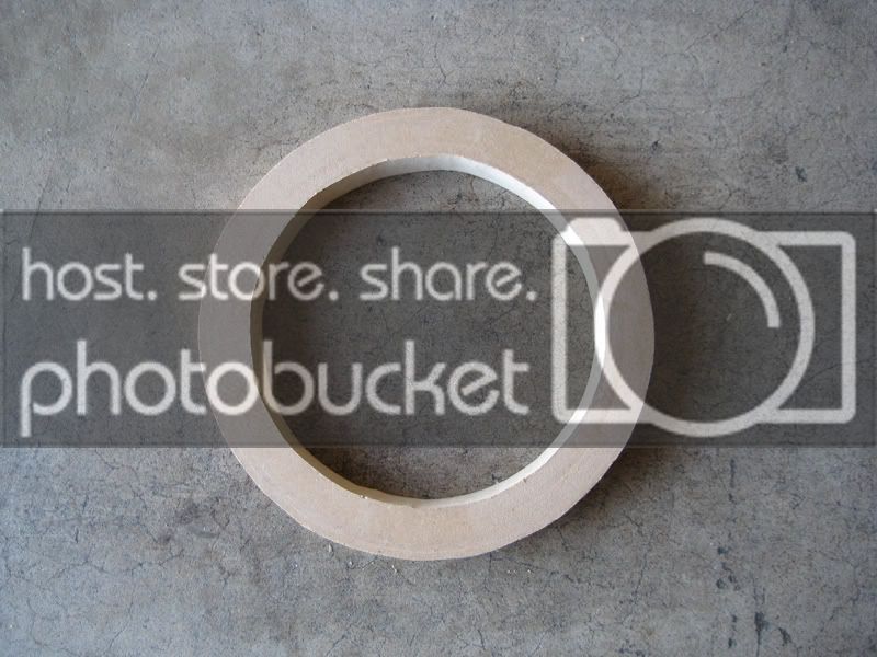

I cut out a square, rectangle actually, 8" x 7.5" and cut off one of the corners

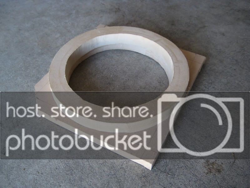

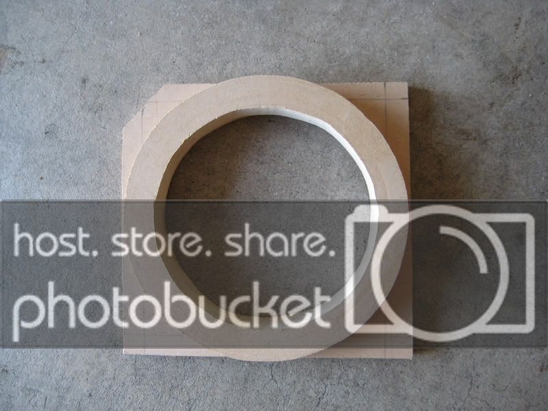

I was going to use another 1/2" baffle, but I figured I'll be safe and do 3/4". I used the cover for the gallon of spectrum I have, traced it, and cut it. Then I cut out a mounting hole using a previous baffle.

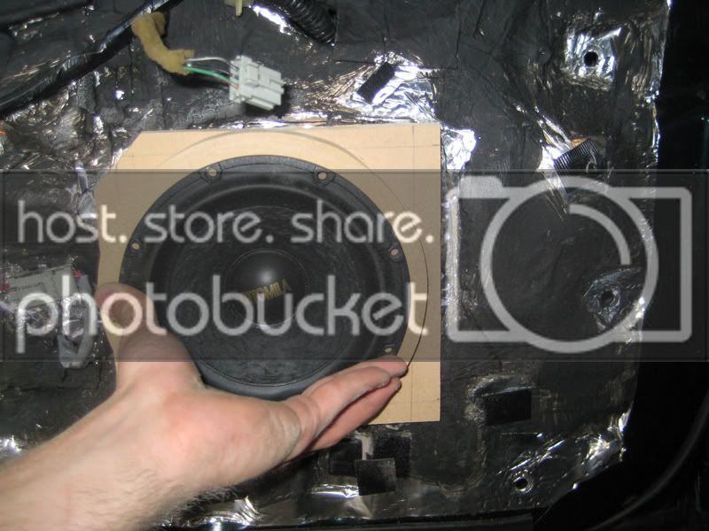

Test fits:

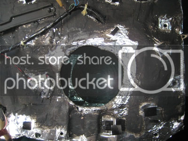

Fits fine in the door

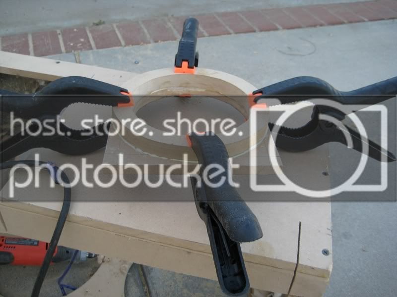

Glued last night and its ready. Figured I wouldn't use screws so it won't split it and so I don't have to worry about some screws hitting others.
I'll do the other one this weekend.
