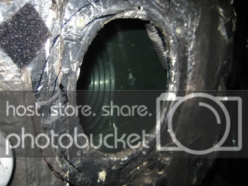

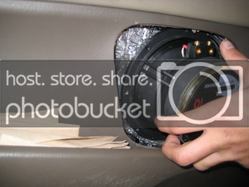

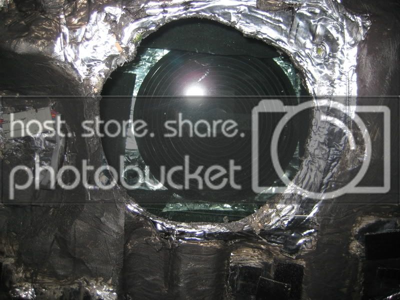

I got around to cutting the doors. I only did the driver door since I want to make sure everything works just fine and then I'll move to the passenger door. I accidentally messed up by cutting the size of the speaker instead of the cutout diameter. It's not too big of a deal, just need to make the baffle a little bigger and cut more of the door panel, maybe by half an inch each side.
With the door panel I placed the thin foam gasket that came with the mids where I would want the mid to be so that it would fit well in the area I need it to be.
Took the door panel off and marked with a Sharpie where I need to cut.

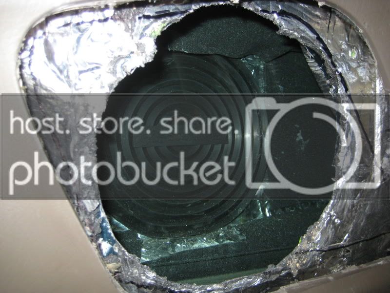

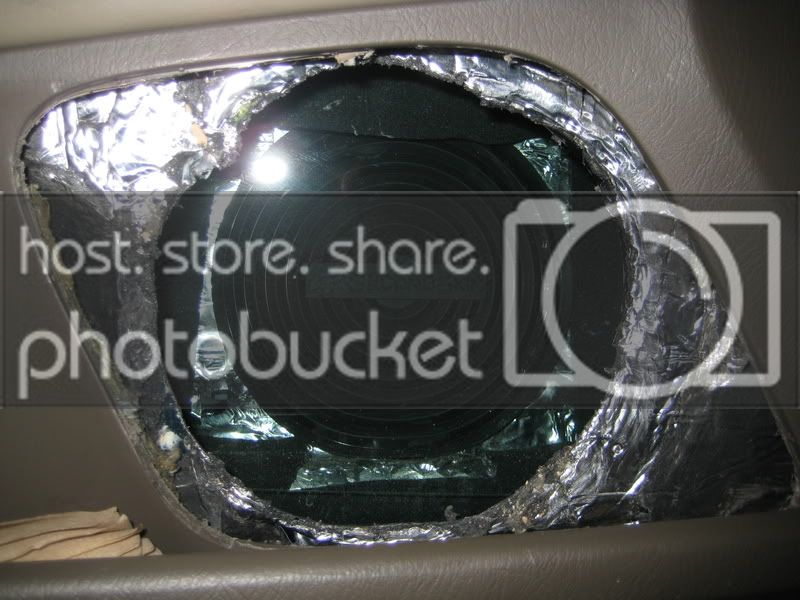

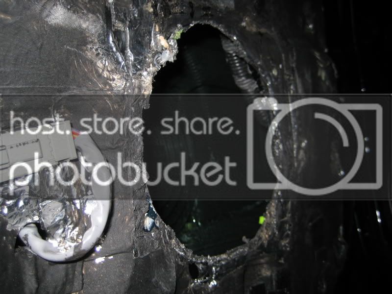

Did the actual cut with a jigsaw. It was very easy and I found it to cut in a circle by itself somehow. I was hardly turning the jigsaw itself //content.invisioncic.com/y282845/emoticons/confused.gif.e820e0216602db4765798ac39d28caa9.gif I started using some sheet metal cutters at first but felt it would take too long and the jigsaw was a good idea. The little piece in the upper left corner sticking out has been removed, just not pictured.

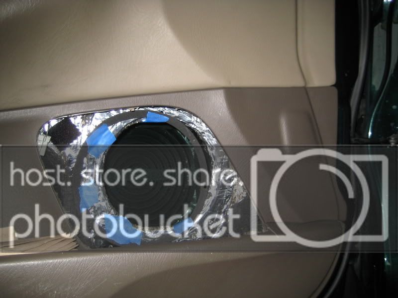

Put the door panel back on to see if I needed to make any adjustments, but it seems it turned out quite well.

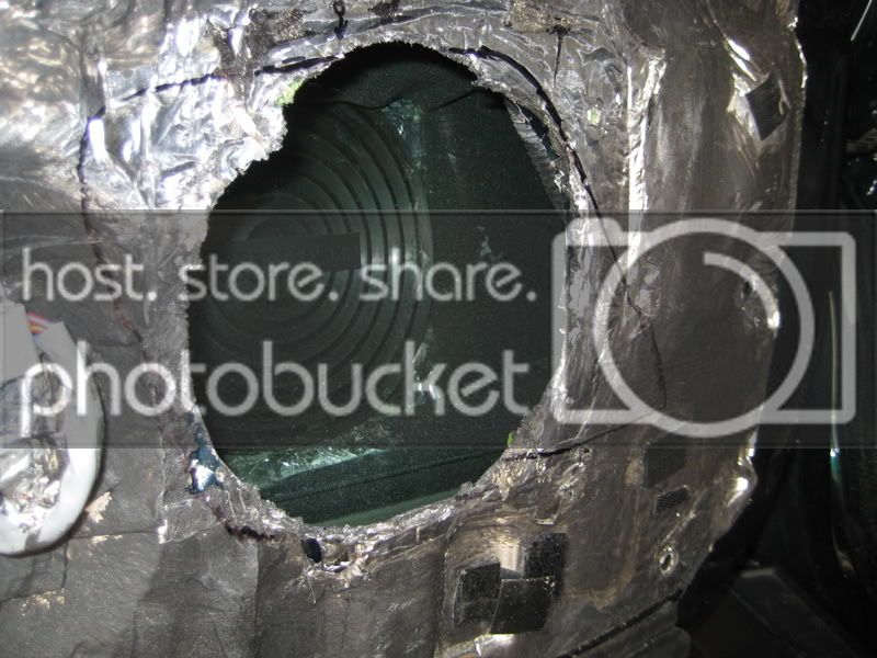

Got my Sharpie out again and traced where the door panel was so that I know how to cut my baffles without them touching the door panel itself.

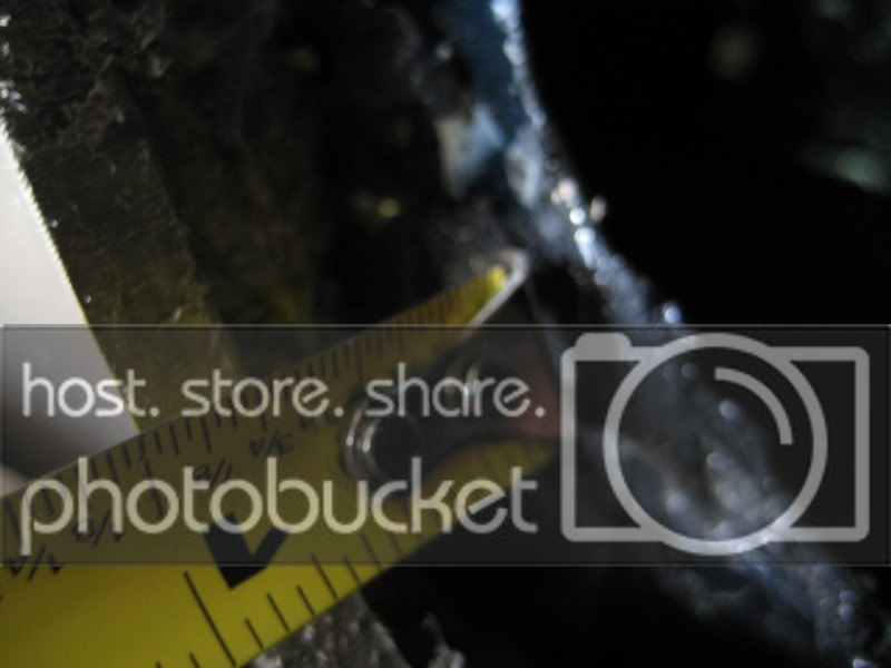

Reason I did that is because I will be using 1" baffles which will more than likely work. If not, 1.25" baffles will definitely work. As you can see I have a little under 3/4" of space from the door to the door panel, so anything larger than that, the baffles will not allow the door to remain in place via the clips.

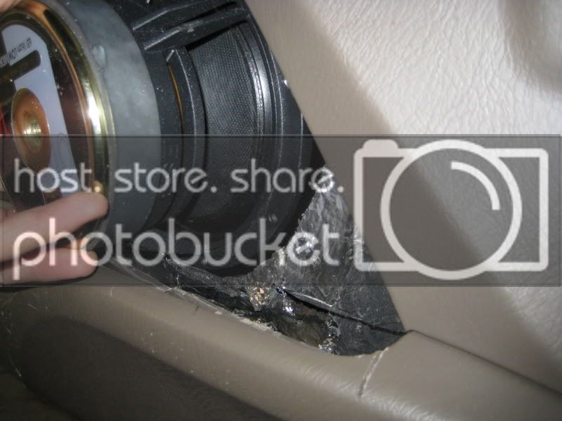

Tested to see how the mid would with the door panel on. I inverted it to see better and get a better idea since as I mentioned, if the baffles are in place, the door panel will be sticking out. Everything seems to be going well.

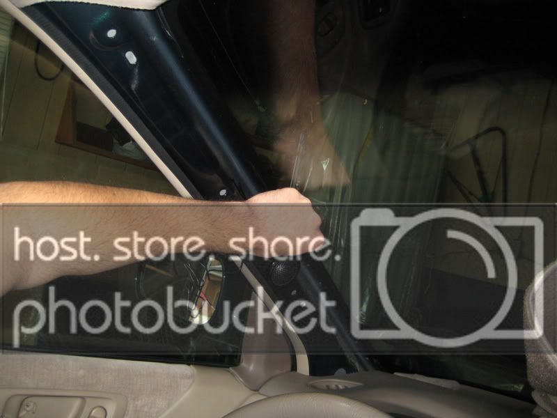

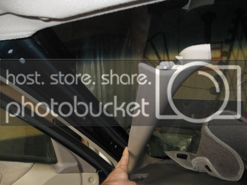

They were quite easy to take off (thank goodness). Here is a picture of it nearly taken off.

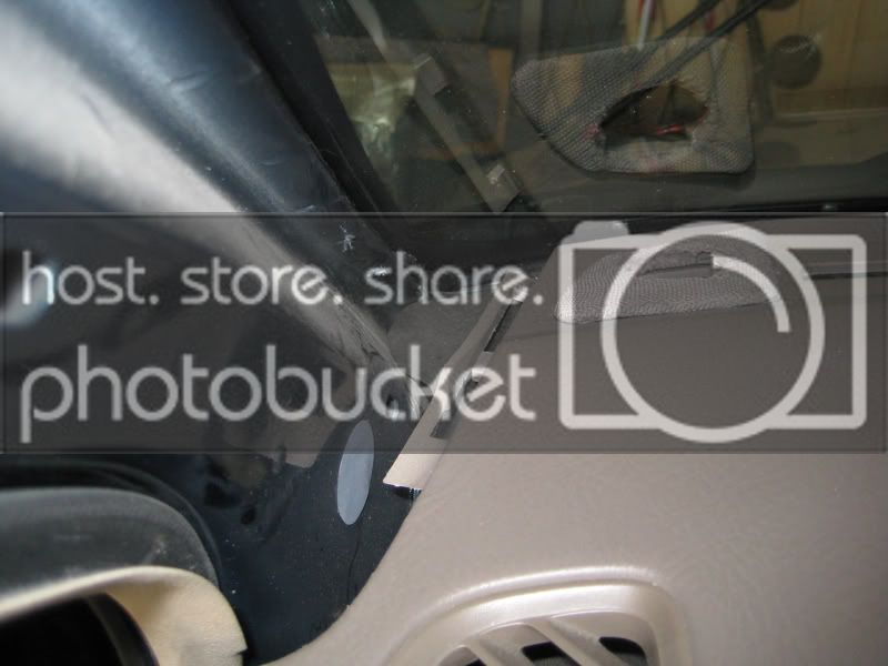

A shot of where the wires will come, which will be on the left side by the A Pillar. You can also see where the tweeters were originally mounted. I will either use my 2nd dash mat since it doesn't have the openings for tweeters or I will cover them with speaker grill cloth I just bought.

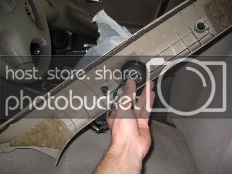

Reverse side of the A pillar panel and where the tweeter will be mounted.

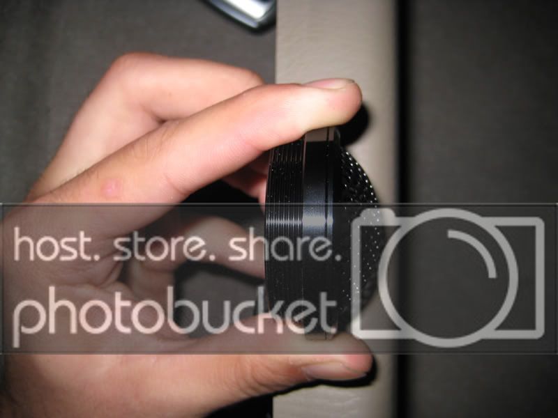

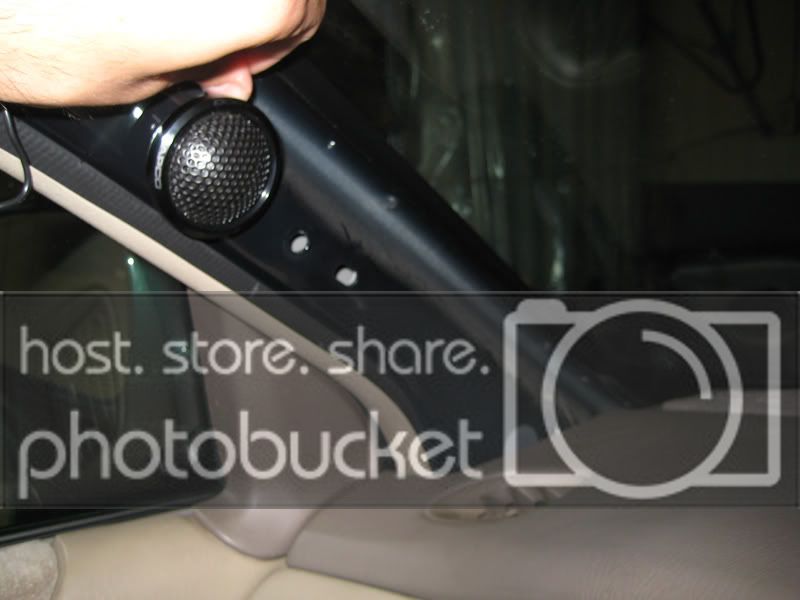

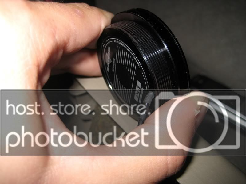

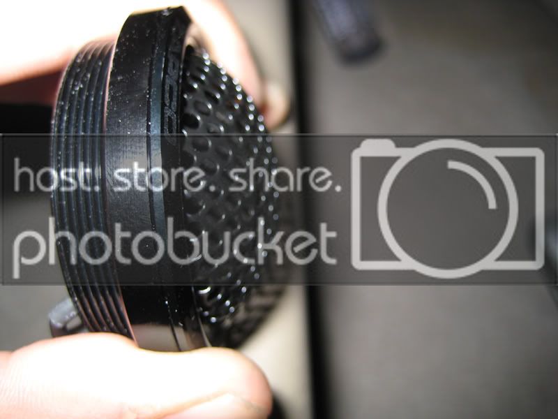

I have plenty of room thanks to the short mounting depth of the Zapco tweeters. It doesn't look like there is in the pictures, but visible to the human eye there is plenty of room.
General location of where the tweeter will go.
