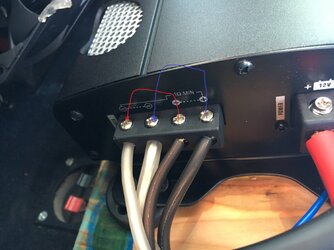

BCortell, I guess that is a good point to bring up with it being a monoblock and all. so maybe its not 2 channels and I just dont completely understand my wiring scheme. Correct me if I am wrong here but if I have a dual voice coil at 4 oh,s and i wire it in parallel, that would cut the ohms in half to 2 ohm per sub right? I did this a brought a ohm meter and it read 1.8-2 ohms for each subwoofer. So maybe my wiring to my amp is incorrect? I attached a picture of the wires for reference and drew red and blue to show wires that come from the same sub. The following picture is from the amp manual, I switched my polarity and it sounds better because of the phase I think, but that shouldnt affect it burning or heating up right? Thanks for the thoughts
P.S. So I know the amp is a monoblock, but why are there 4 terminals then? If someone could fill me in on that I would appreciate the knowledge. Thnx

The 4 terminals are connected internally I believe. It just to make it a little easier to connect.

So that would mean there is no sound difference between using two terminals and 4 wires rather than all four terminals? I guess that's pretty much the definition of single channel, right? I was thinking more terminals would have better power distribution, but if they're all on the same node then it doesn't really matter... Something to test at least with a spare moment

Pretty sure it will sound the same.
Instead of you wiring the final step, the amp does it for ya. Simple as that.
