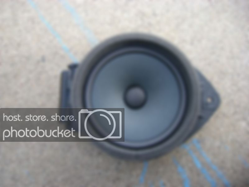

look at all of the depth the factory speaker mount has!
you need your new speakers to have the same depth - and hope the window isn't directly behind this.

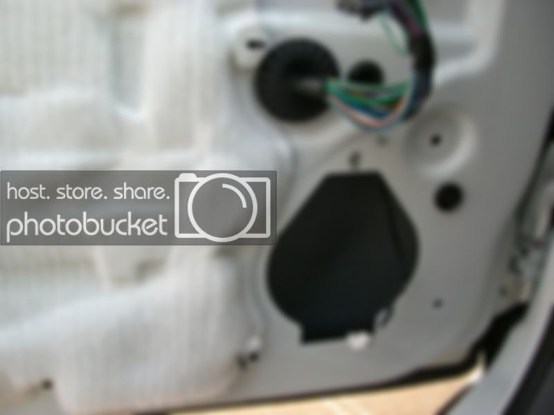

the hole left after you remove factory speaker

when building up your custom baffles, the bottom 3/4" layer will be the shape of the opening, about 1/2" larger on all sides. it will have a hole cut out for the woofer, somewhat centered. then you'll have rings that build up on top of that to get the factory depth. then you'll have foam around it, just like the factory speaker, so you seal against the door panel ring.
the foam you linked is close. rubber closed cell is black and thicker, you need 1/2" or more thickness for the water protection path. what you linked is fine for speaker mounting. want something thick and soft for the front - open cell is fine here.
