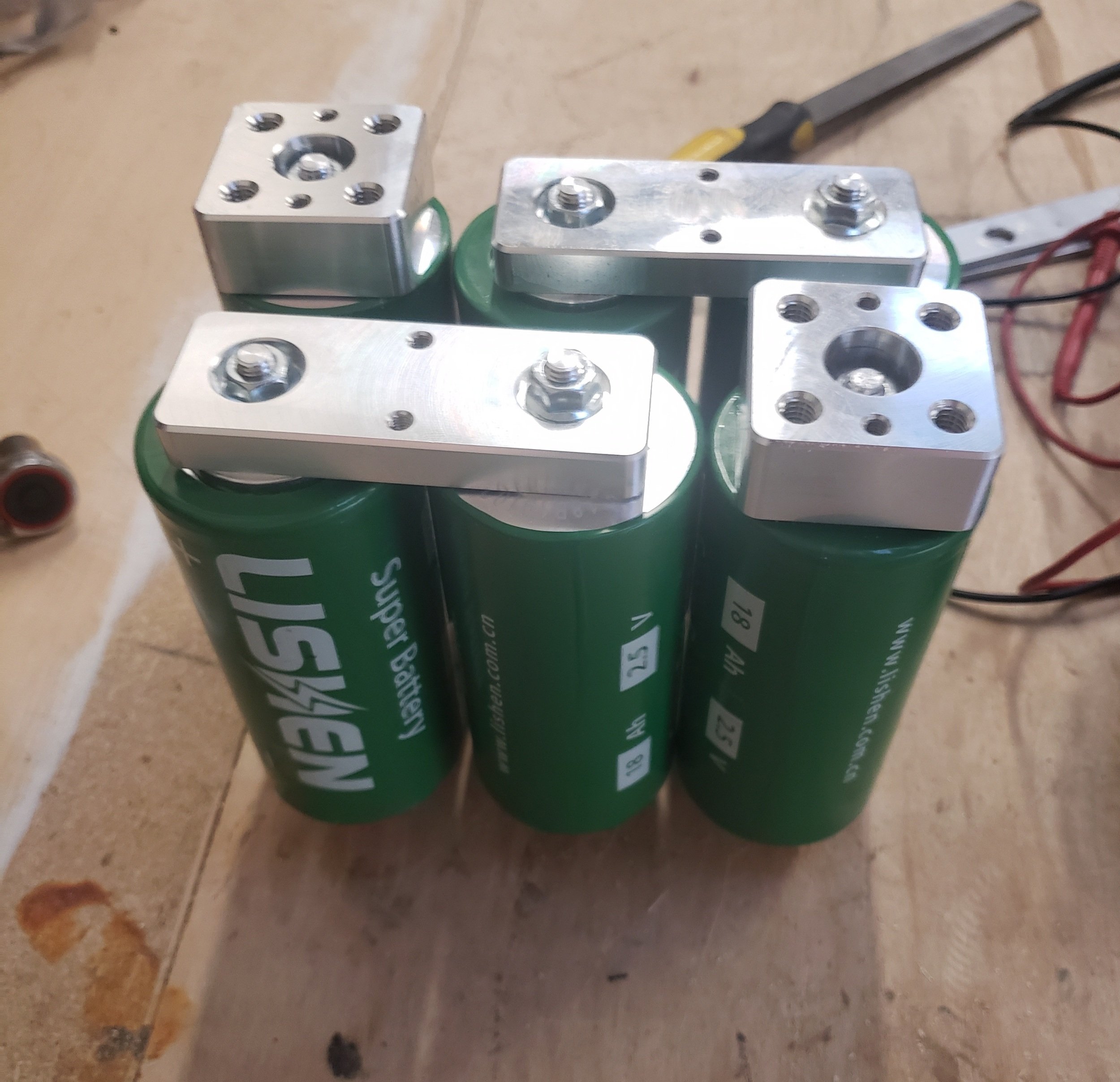

One bank of lithium in the trunk. Less weight, smaller, cheaper, better, and lasts longer.
