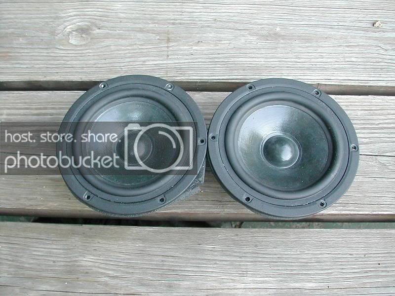

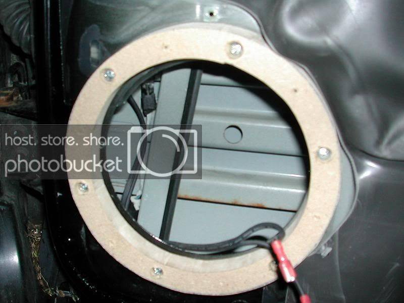

Well I picked up a a set of used Vifa PL18WO's off a member, which can be seen here:
http://www.partsexpress.com/pe/showdetl.cfm?&Partnumber=297-324

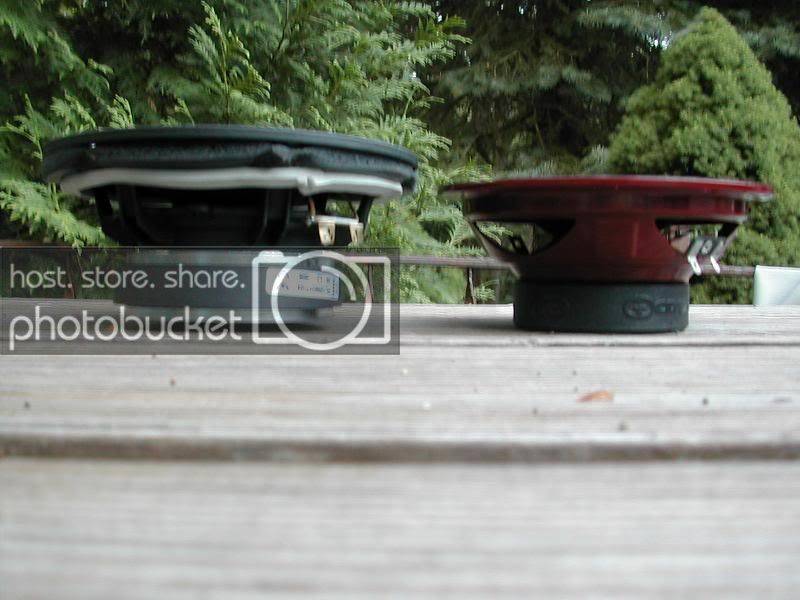

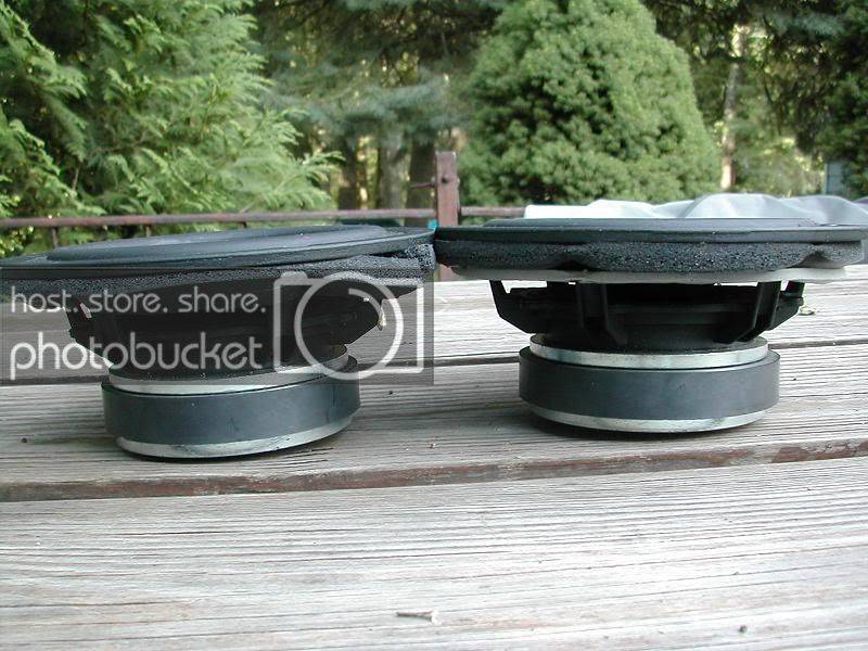

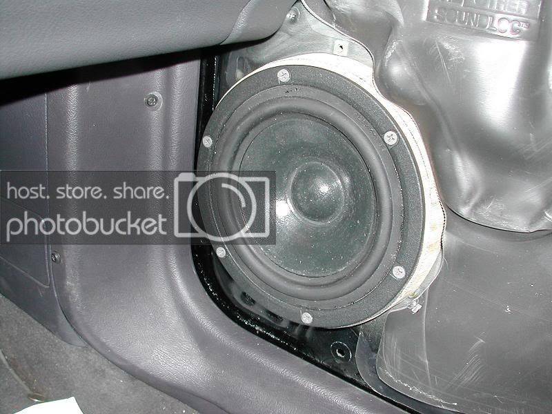

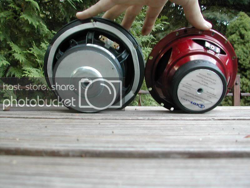

I installed the passenger side on a 3/4" MDF baffle, 6 sheet metal screws into the door, with 6 screws holding down the mid. I left the driver side CDT 6.5" in to compare. The CDT is mounted only on a plastic ring, which is mounted to the sheet metal.
What I'm really confused about, is the fact that the Vifa's sound as if they have an HPF on them... They have almost no noticeable midbass at all. The baseline CL-61 CDT's put them to shame.
The previous owner had some foam stuck to the basket; It can be seen in the pictures. I left it there when I installed the mid since I have never seen it done before. Could the foam between the mid and the MDF be acting as a damper on the low frequency response?
Thanks,
Matt

The foam is acting like a gasket tape.
Try swapping sides with the CDTs.
Also, it could be a phase issue. I've experience midbass being biased to one side because the "relative" phase was off. Meaning even if both the polarity are correct, the relative phase is not.
When I did the testing, rarely were both sides playing at the same time; I would shift the balance back and forth.
It's not really biased to one side, say 60/40 or 70/30... Its closer to 95/5.
Could you explain relative phase a little more?
Edit: I did this late last night so I didn't any time to troubleshoot, and I'm at work now. I'll try swapping the other mid in to see if there is any change around 4:30, 5ish when I get home.
I'll try to do as much testing as I can and keep you updated.
Thanks,
Matt
Did you use the auto TA/EQ on the HU?
No, did the EQing by hand. System settings worked perfectly with the CDT mid on the right side, only thing I changed was the driver.
I'd also suggest using the foam/weather seal between the baffle and the metal of the door. some like to use non-hardening modeling clay.
I was going to get some clay eventually, but I don't think that is my problem right now.
Wired up wrong?
Wired correctly. Only thing I changed from the last setup to now is the swap from a 6.5" CDT to a 7" vifa. Even if it was out of phase with the driver side, it would sound fine when balance shifted to the right.
Well I've gone as far as putting in the "old" CDT, sounded fine. Reinstalled the MDF ring and Vifa, switched the L+R RCA's.... No change.
I just don't think the Vifa' have the midbass capablities. The midrange is MUCH crisper than the CDT's, but they have no "punch" at all.
