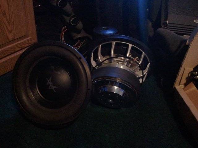

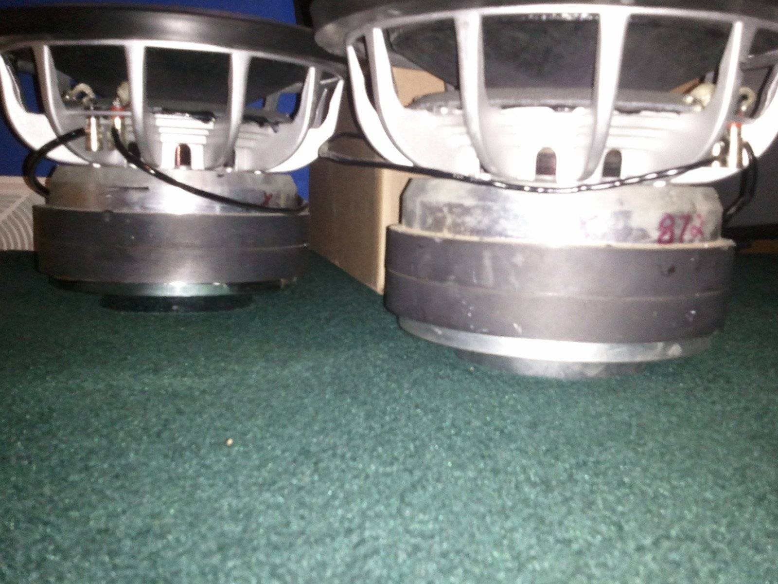

well as follows. i have a pair of atomic apx with AA mayhem recones. motor #872s . doing some talking to some spl members, i was reccomended doing a 25 x 12 x12 box with an external 8" aero. this is for sheer SPL. who knows how well it would do. next time i would probably bump it up the the 3 cubic foot area with 8" external aero after playing with BB6 and WinISD. but we'll see. anywho, heres for pics.
the subbies

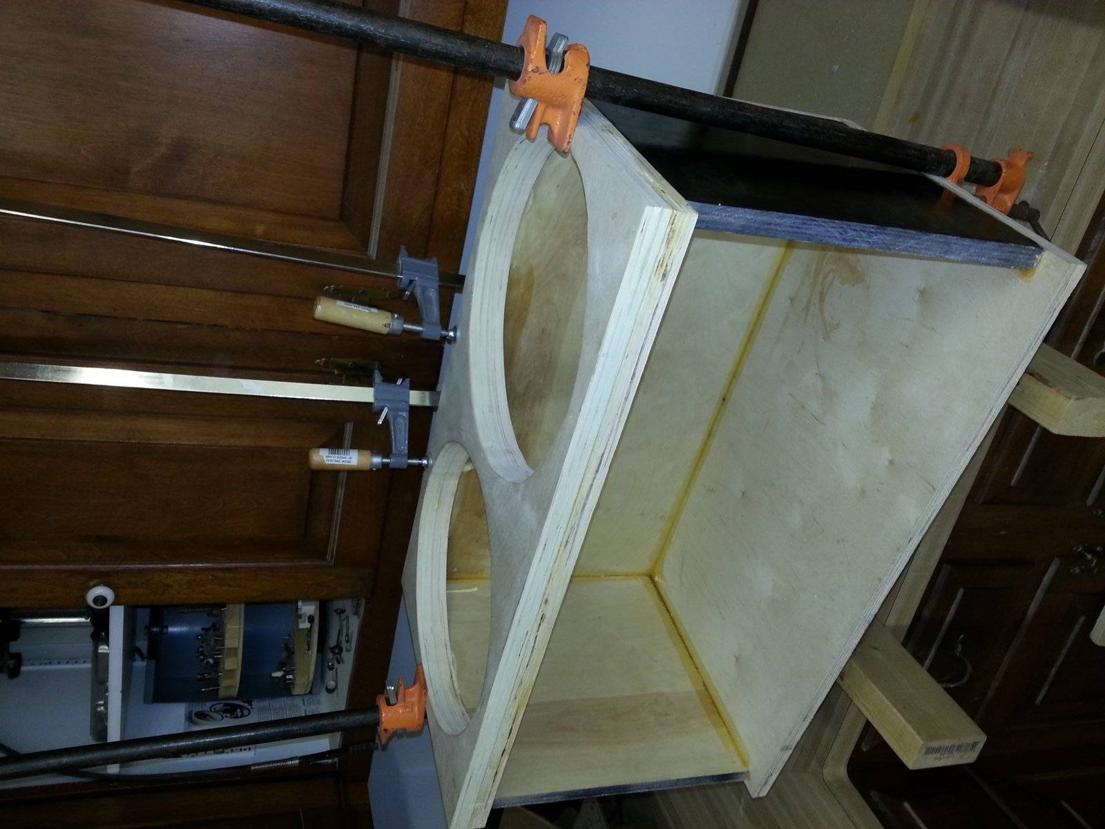

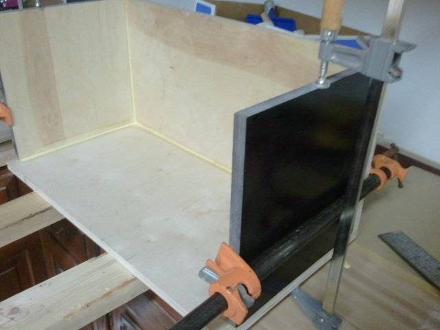

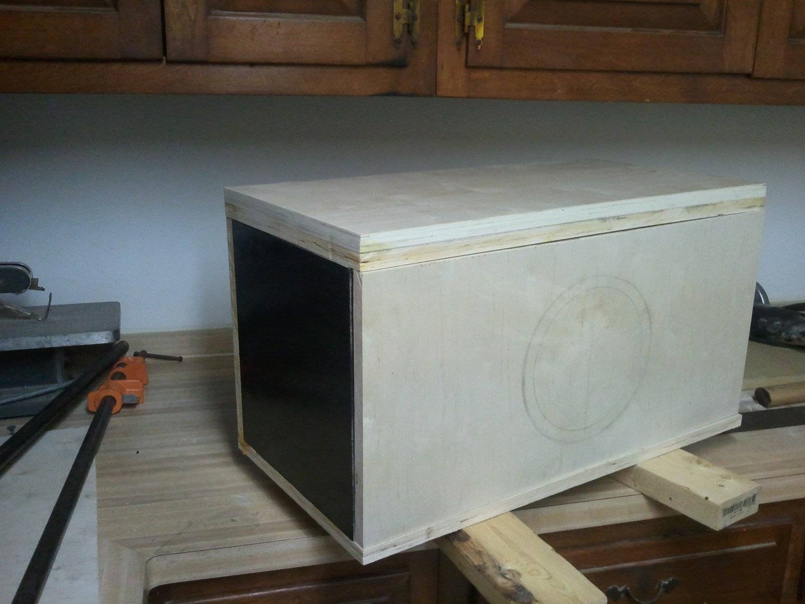

This is the rough end of the box. the top double baffle and front are clearly not glued. but how it will look. the sides will be black and the rest will be stained brown to match my wood grain interior followed by a clear coat.

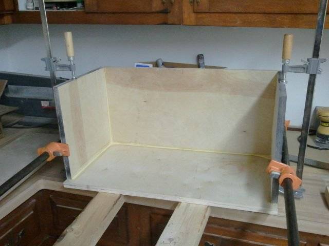

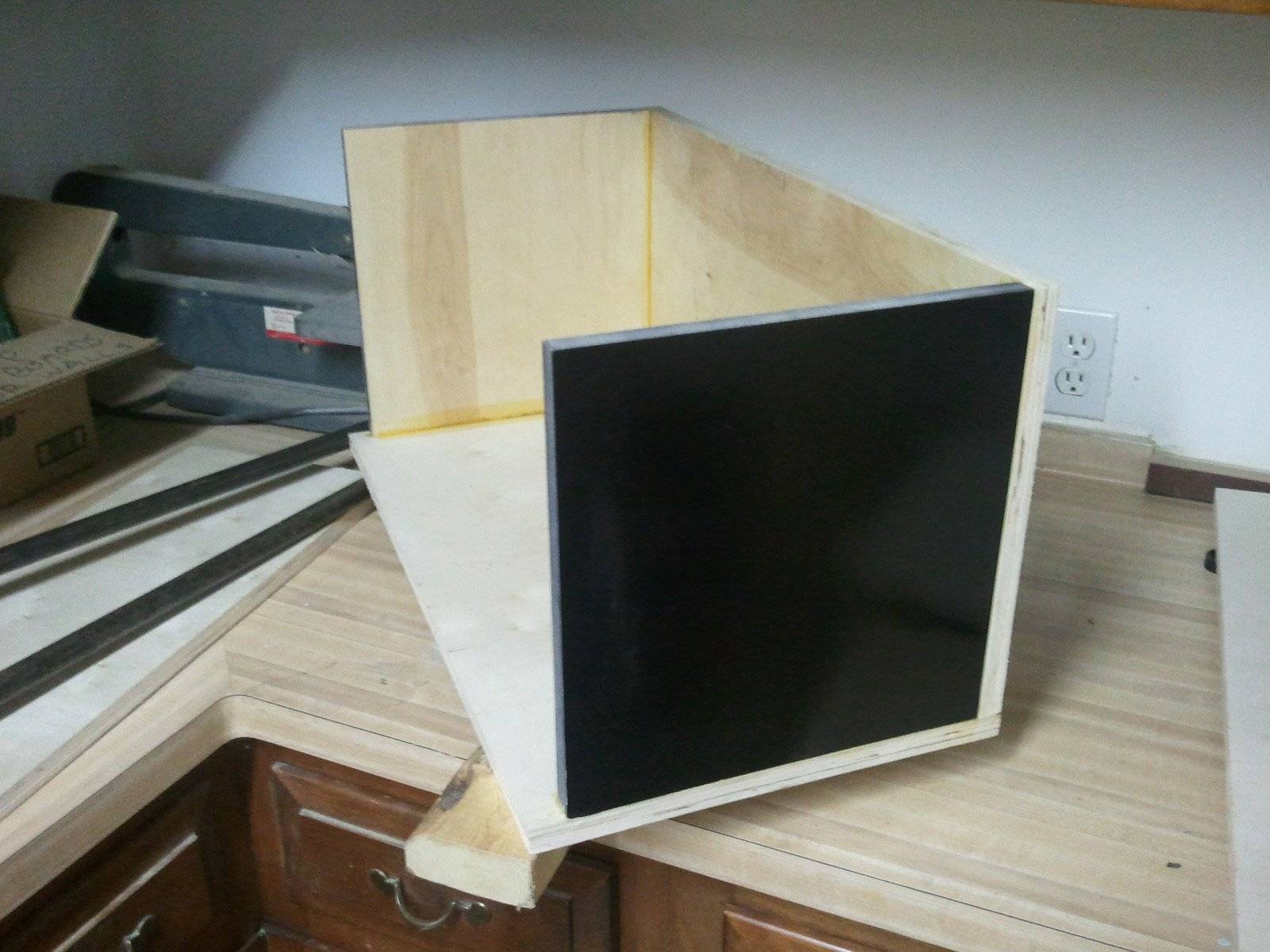

I'm really happy with the sides. they turned out glossy and nice for birch. alot of sanding and layers. but turned out great.

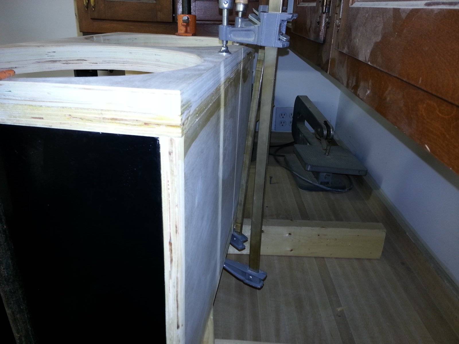

cutting the double baffle was a PITA. it took forever using a saber saw through the 1.5" Birch ply. the blade bent alot.

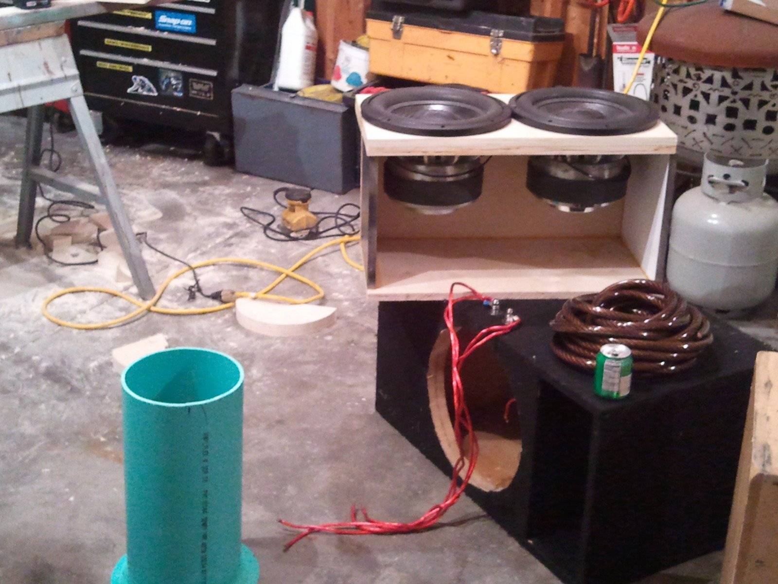

as they sit comfortably.

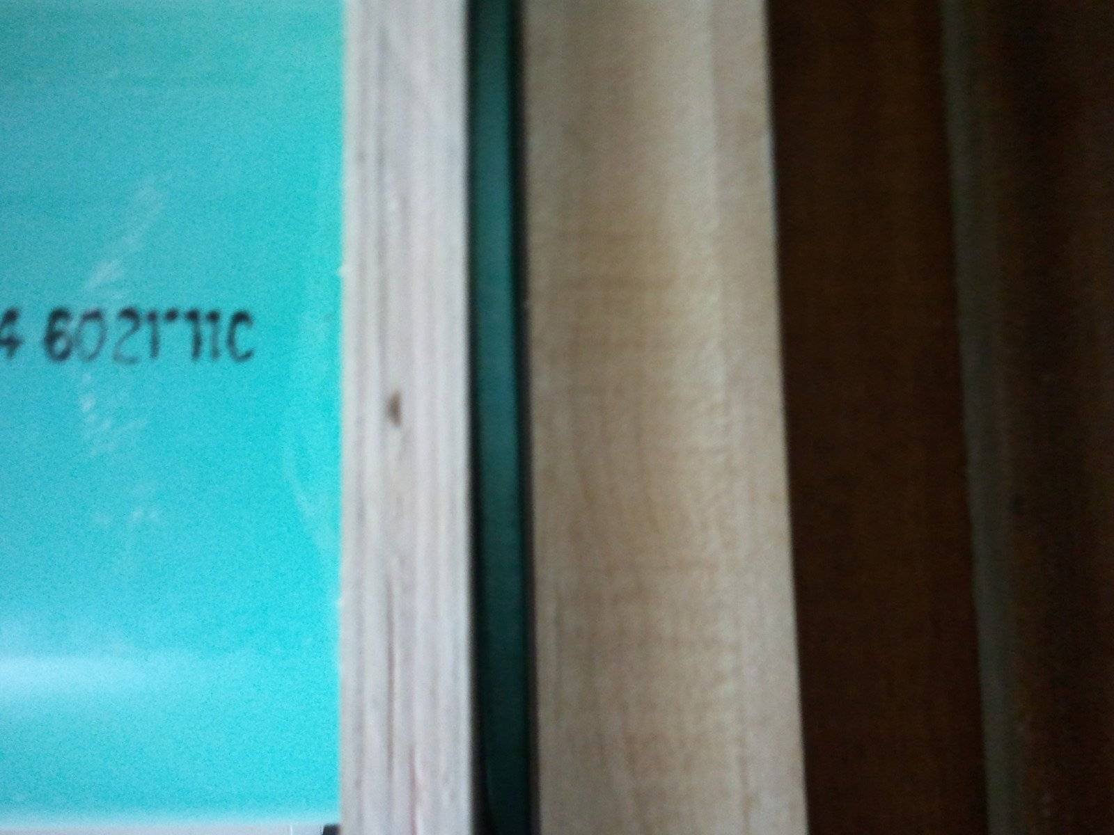

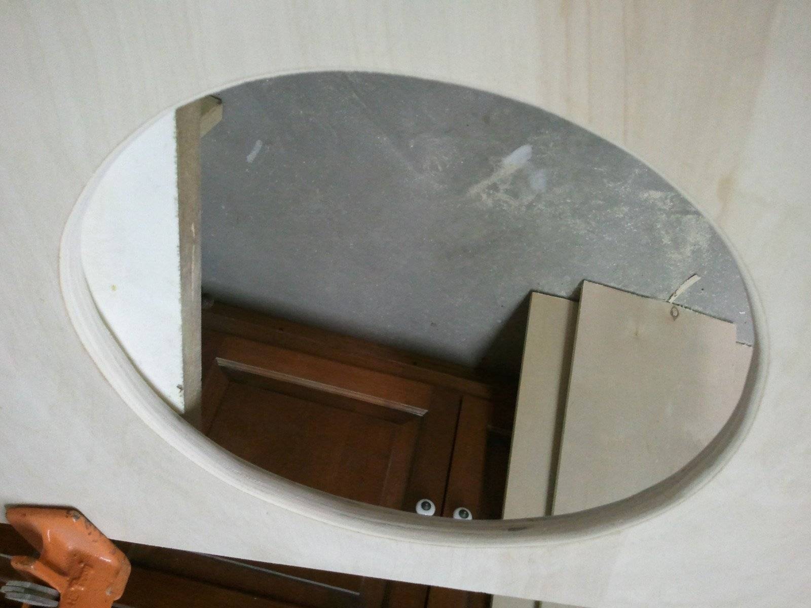

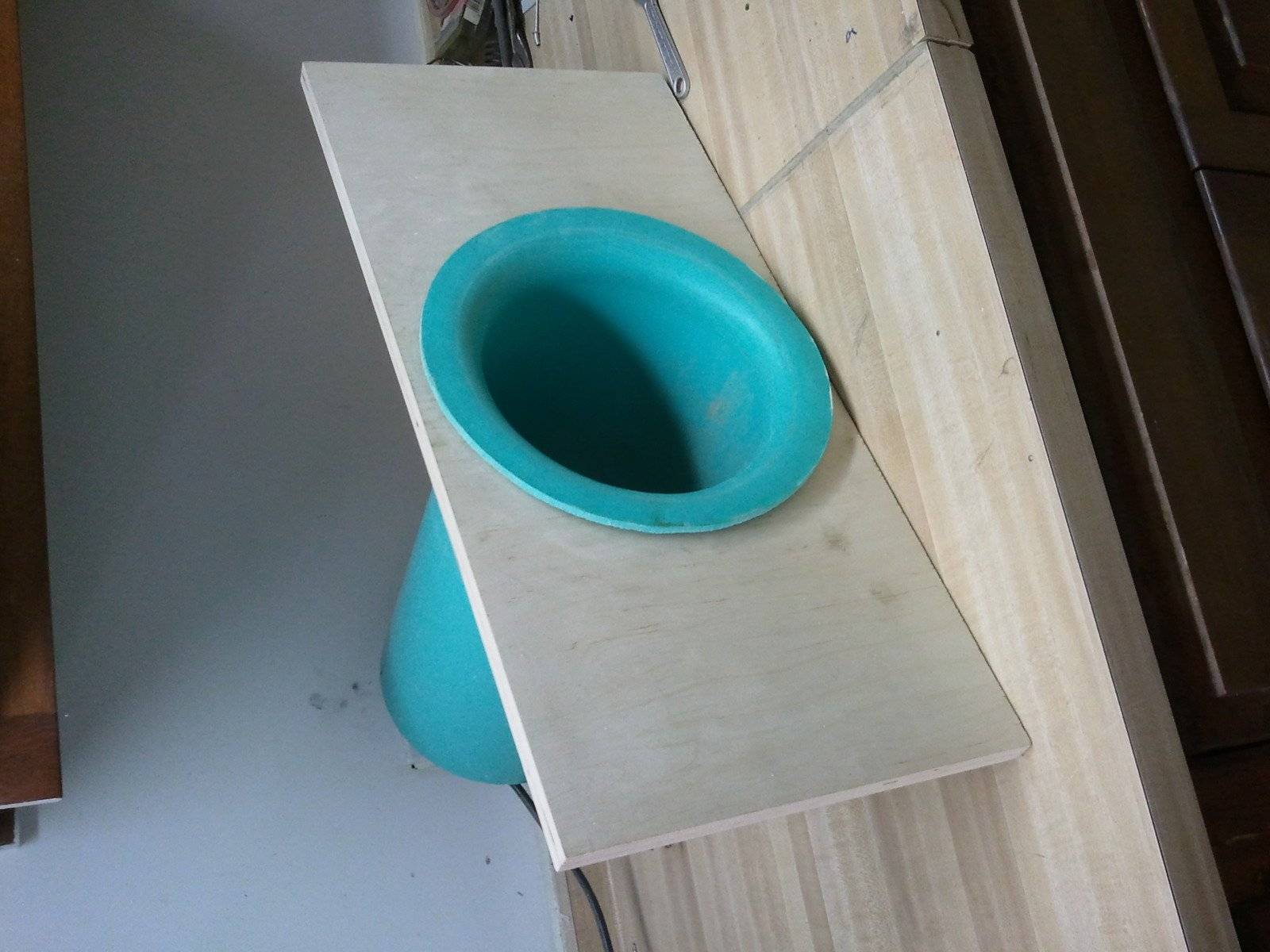

this is for the aero fitment. very difficult cutting a perfect circle with a saber saw. followed using the router and hand sanding to try and get the smoothest surface.
pretty tight. //content.invisioncic.com/y282845/emoticons/smile.gif.1ebc41e1811405b213edfc4622c41e27.gif

Stop the build, Give me those subs!!! LOl! Looks good.
thaanks! and theyre beasts. traveled 2 hrs for em.

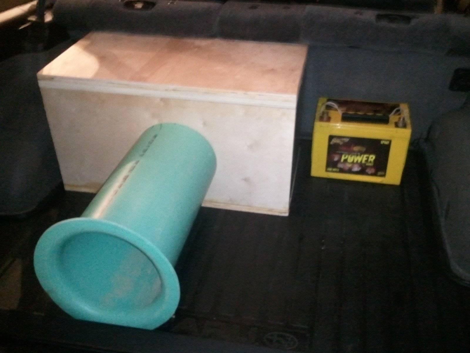

heres the "trunk" of the wagon.
rear seats fold down so i can even allow it to move up or change direction

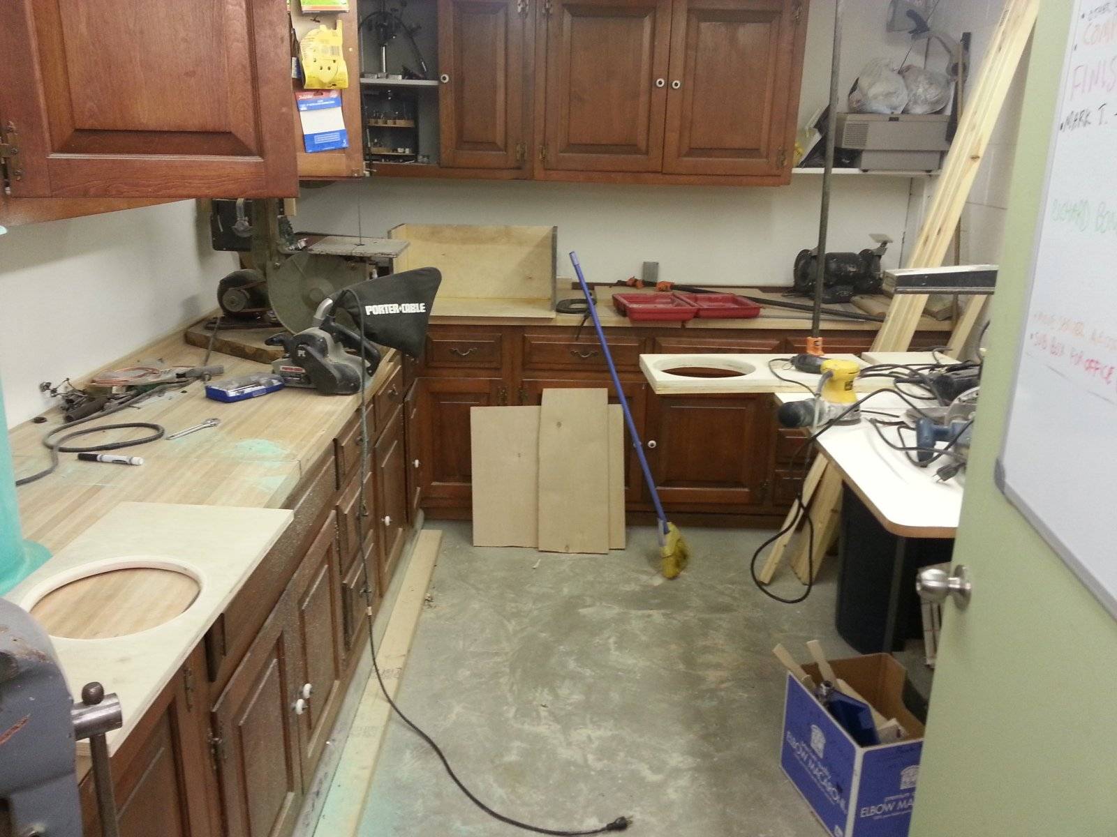

workshops real dirty. but it happens. clean it up once a week it feels like.
nice and tight
need to route and bevel the edges yet. //content.invisioncic.com/y282845/emoticons/smile.gif.1ebc41e1811405b213edfc4622c41e27.gif
coming along decently well. any ideas on how to secure the aero? ive seen the use of bolts and nuts. Tnuts im assuming?

Was that box built in your kitchen? Lol
