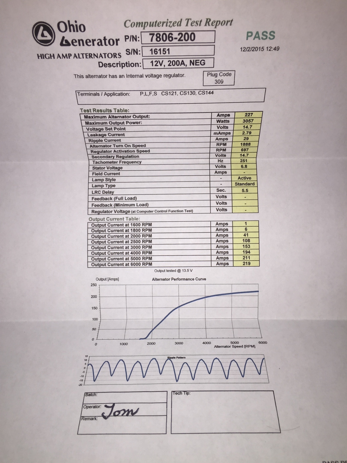

The reason why I said "set point" is because that is what it says on the printout that comes with the alts (I honestly know very little about this stuff as you guys can tell but I'm trying to increase my understanding and knowledge)!
That's a good point about the range being the main point and the exact number being inconsequential.
Here is the print out for my trucks alt. I guess it is 14.7v not 14.4v like I thought.

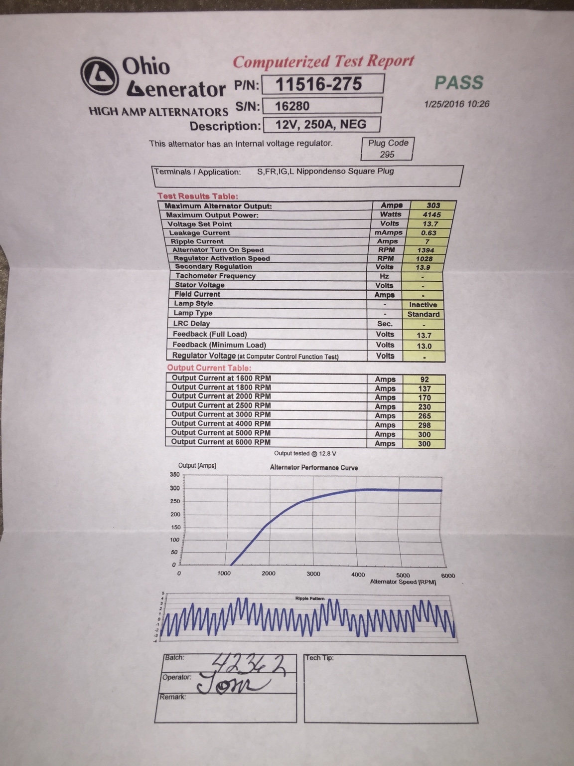

And here is the one for my Camry
